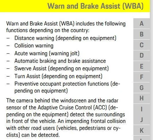

Can somebody explain exactly what this system is supposed to do in the USA? I am not a big fan of Porsche saying it "includes the following functions depending on the country" without saying anything about the functions in the country the car is being sold! My daughter's CR-V blinks "BRAKE" when I seemingly am getting close to the car in front of me at a certain speed. I have not seen my Taycan indicate anything is amiss in similar situations. Any idea exactly what this does in the USA?

It does exactly as it says. It warns you and sometimes applies the brakes if it thinks you are going to hit something in front. It has a sensitivity setting.
At medium sensitivity it has given me a false positive warning (but no braking) once in 5 months and also one true positive (my foot was already on the brake pedal but the car applied it too).

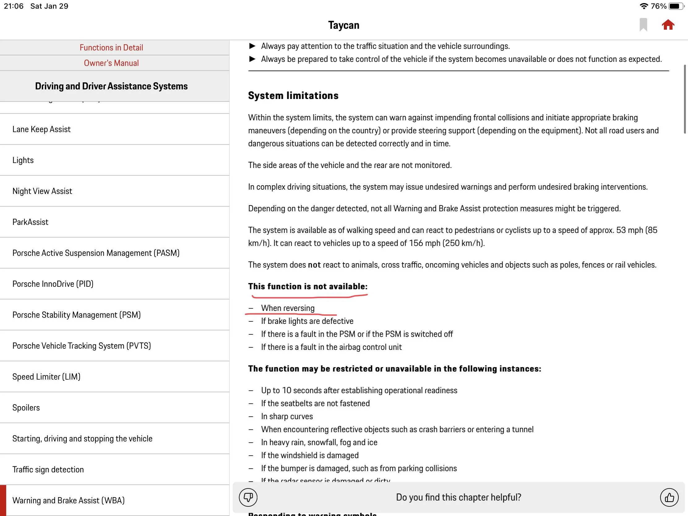

Will this system warn you if you are going to hit something when backing up?
'Maneuver assist' if so equipped will do this for you though - had it happen on only one occasion where I apparently came a wee bit too close to a solid fence whilst reversing down a very narrow driveway. Quite impressive actually, caught me by surprise!
