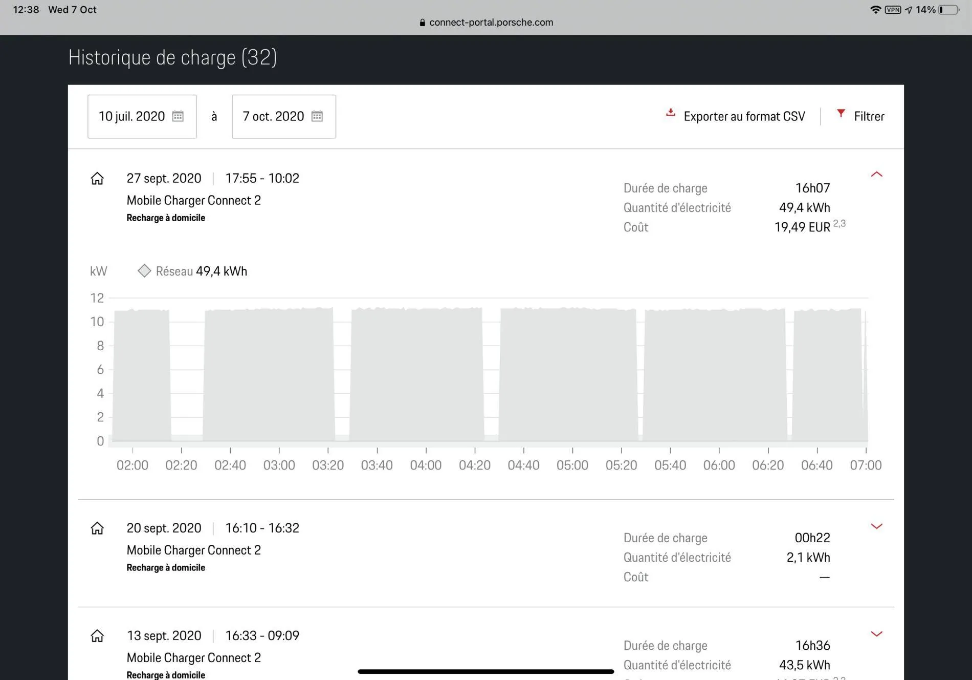

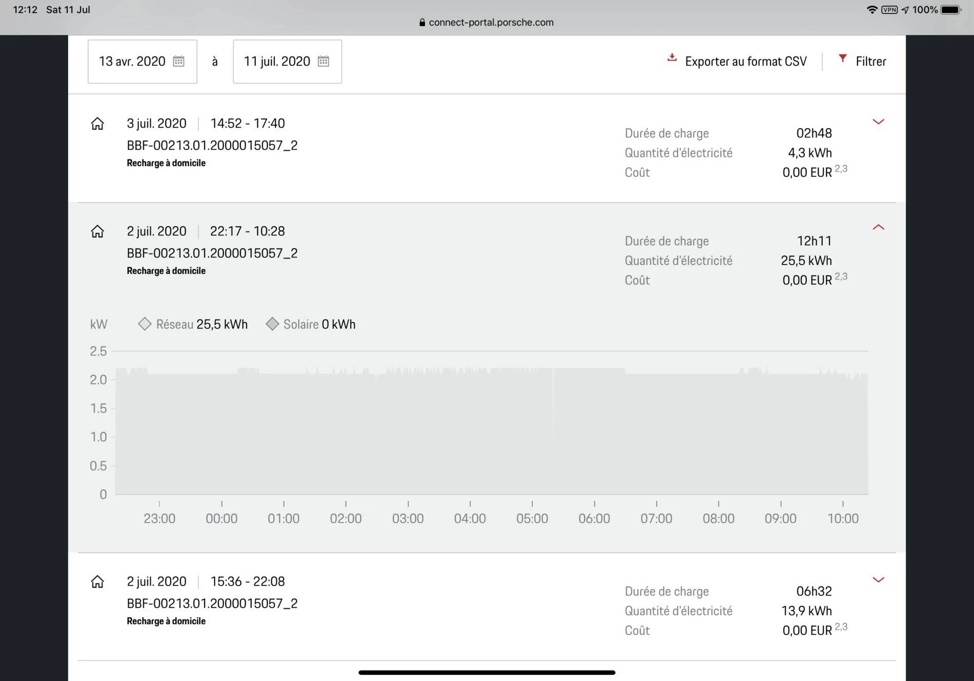

You can also see your summary of charges with the login at myPorsche. Below is a screenshot from my charging.

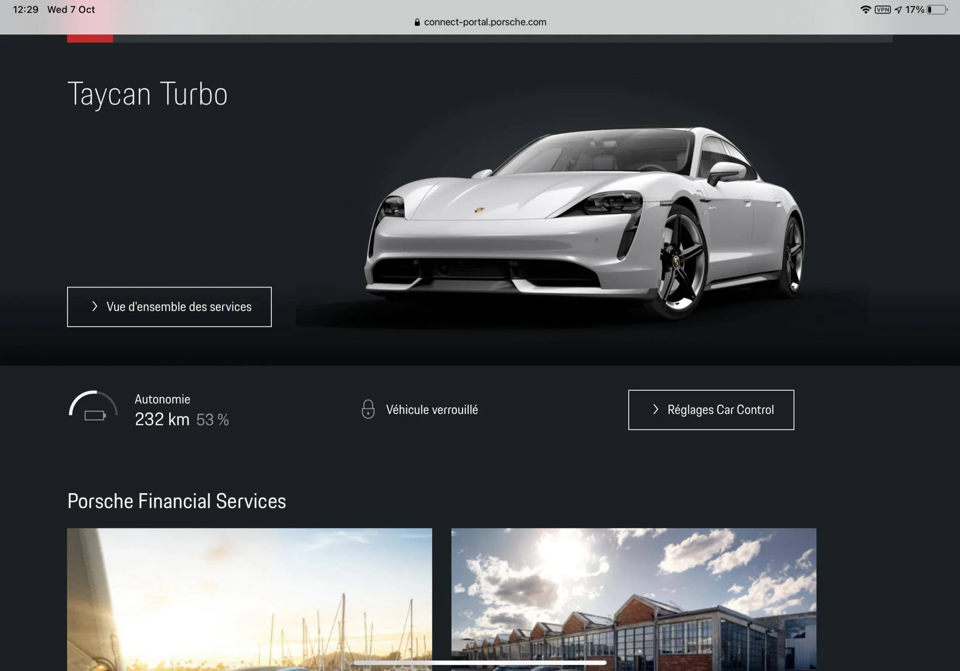

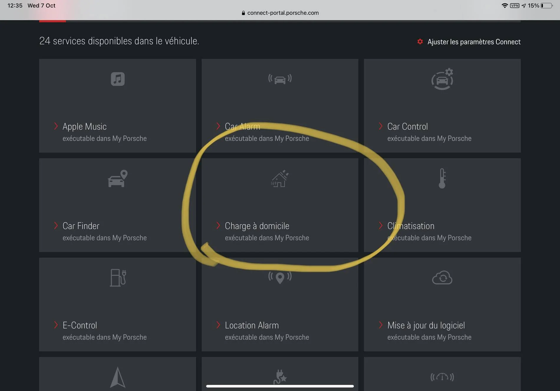

So here is how I found the charging history on MyPorsche.
1. Log in to your MyPorsche account
2. Find the summary of your car and where it states something like (I have it in French) Services in the car
Porsche Taycan Web interface for Porsche connect charger DB91FE65-DEB2-4607-9200-1A2C4F7BEFB8
3. Click on that and all the services are listed.
4. Look at the Charge at Home or similar in English
Porsche Taycan Web interface for Porsche connect charger 348C3AFD-E348-4C12-9C0C-A3F3B6193747
5. Click on that and scroll down a bit on the page and you should have all your charging summarised there.
Porsche Taycan Web interface for Porsche connect charger 9A9CA516-C0E8-415B-9258-D26EEAD0A300
I hope that helps? PM me if you would like any more details etc!

Here is how I have managed to do it.
First you need to make sure your PMCC is connected to your WiFi. That is like everything else. With the charger you also received a small card that had a lot of information about logging in passwords, both for the charger direct without your network. There were two log ins one for the Home user and one for the Tech user. In my case I can only log in to the charger when it is live and connected to the car. It sleeps otherwise to save energy, I guess.
Once I had logged in to my home network all the charging history has been uploaded to MyPorsche.

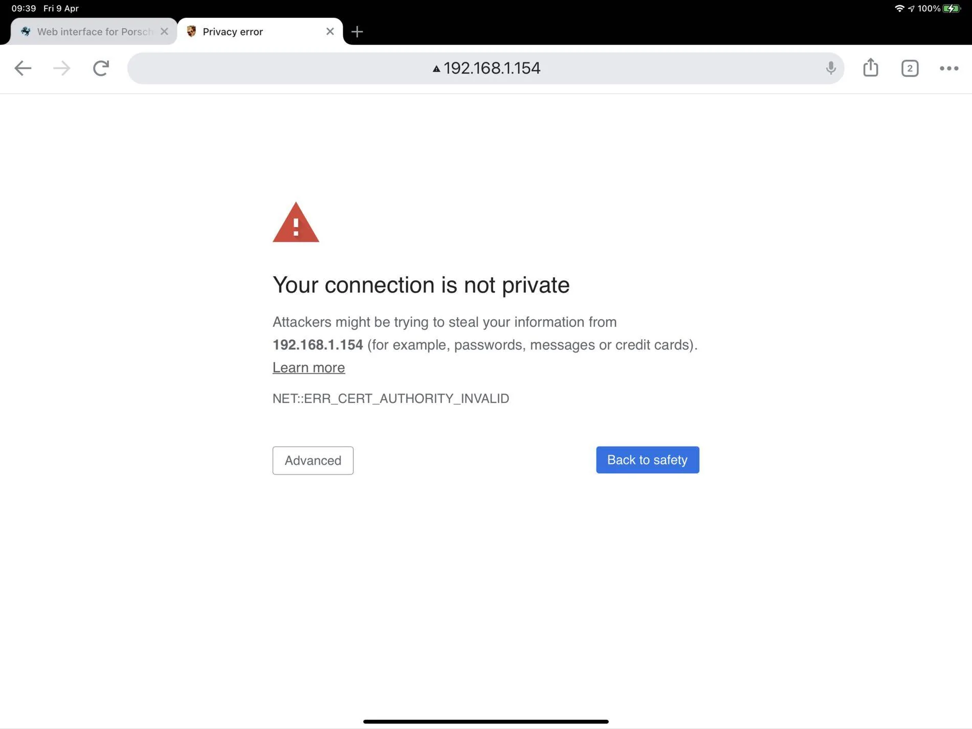

What browser are you using? I get certificate errors because of https.
11,102
6,871

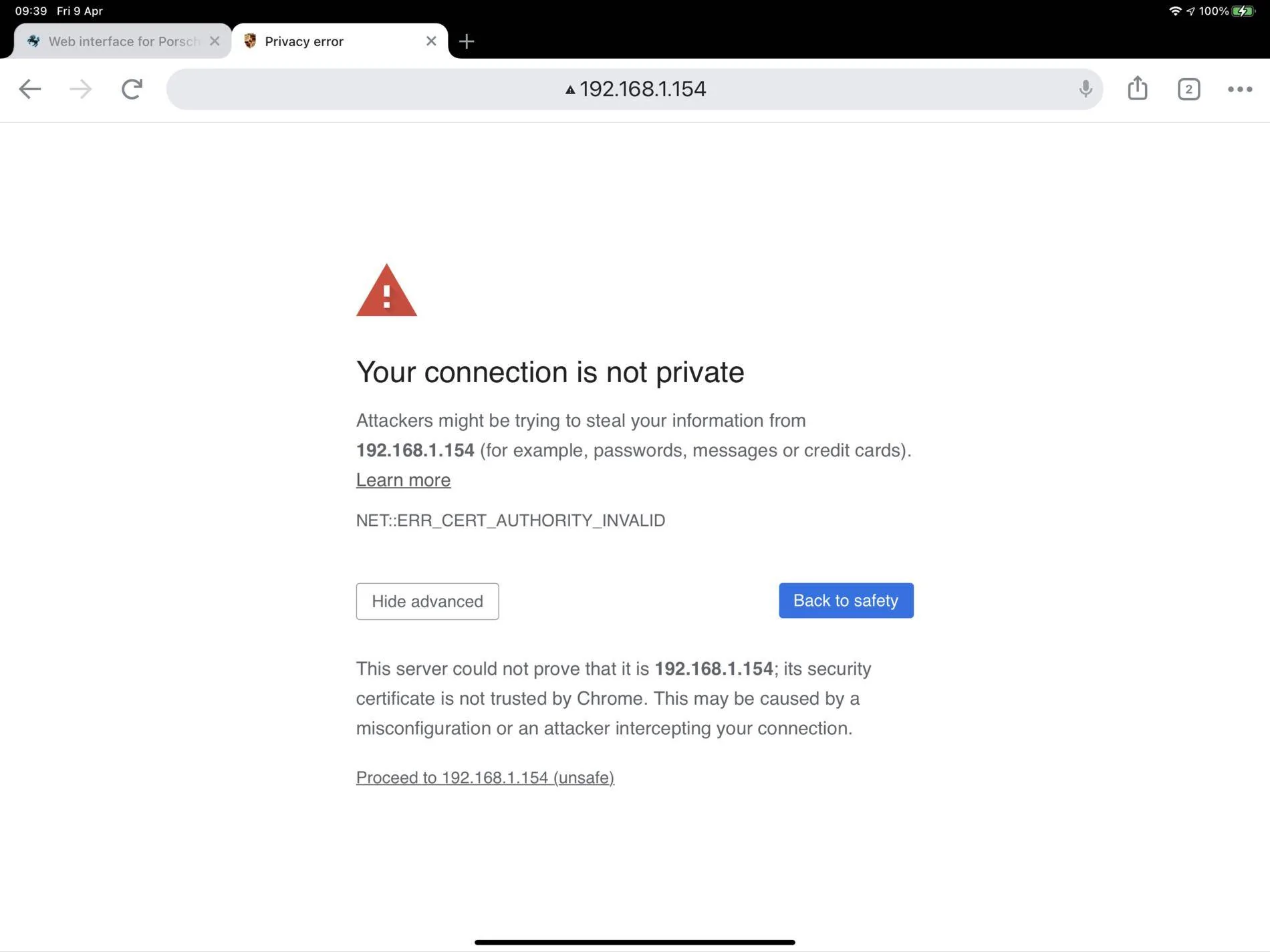

Click past the errors - see comments above re certificate - basically you have to acknowledge that you wish to go to an ‘unsafe’ site which is the web server on your PMCC. If using Chrome then you will see the following:
Porsche Taycan Web interface for Porsche connect charger A6C874A3-06BC-4598-8DAA-4968E080AC89
Click advanced:
Porsche Taycan Web interface for Porsche connect charger DB2C3162-D3DA-4CA6-BD2A-F319442D6C51

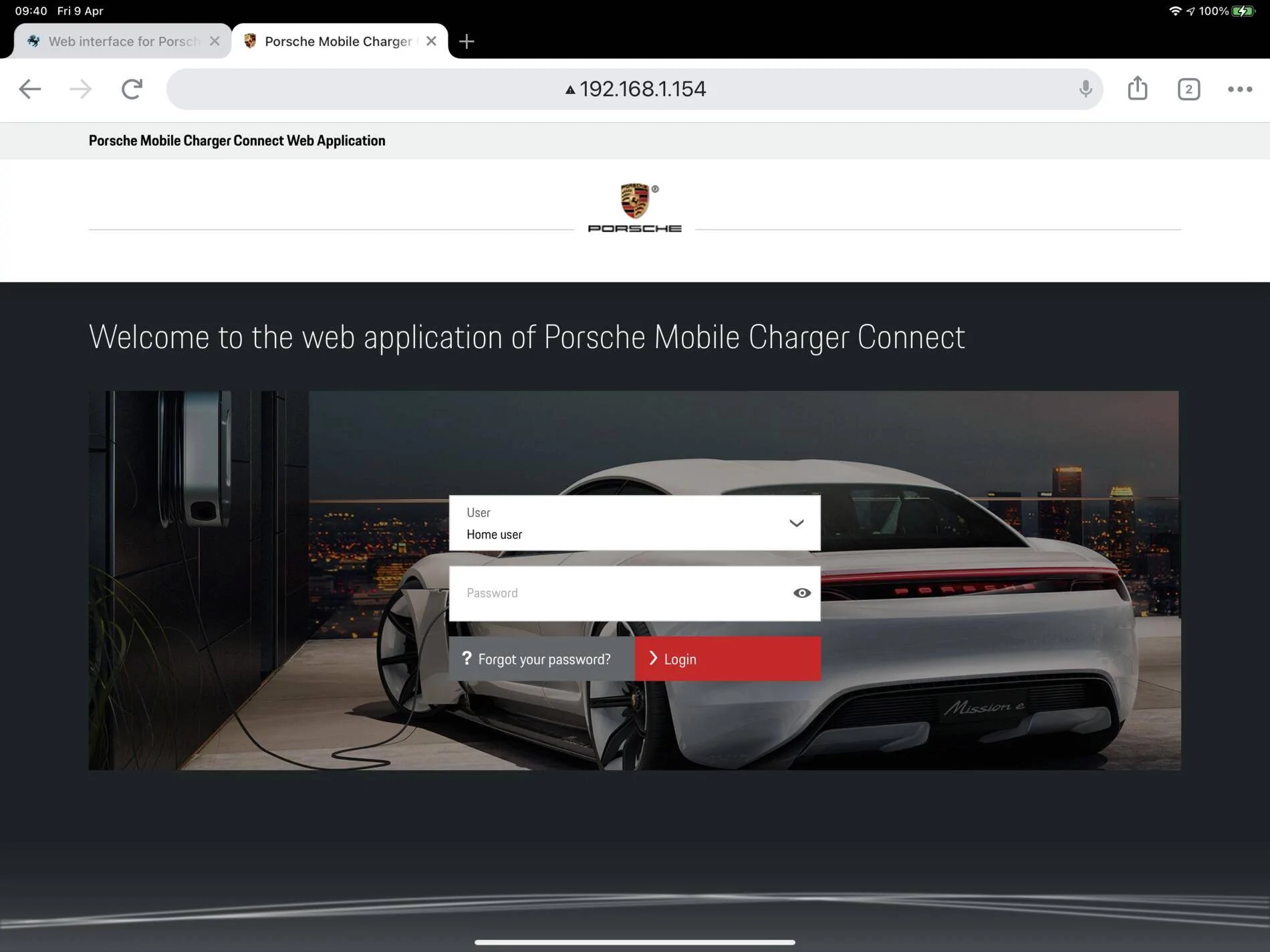

Then click on ‘Proceed to (whatever your IP address is for PMCC):
Porsche Taycan Web interface for Porsche connect charger 2093F836-8C49-46E1-8CE7-04FEC62C15FA
You can then log in as Home user or Customer Service (the latter gives access to the PLC functions).
