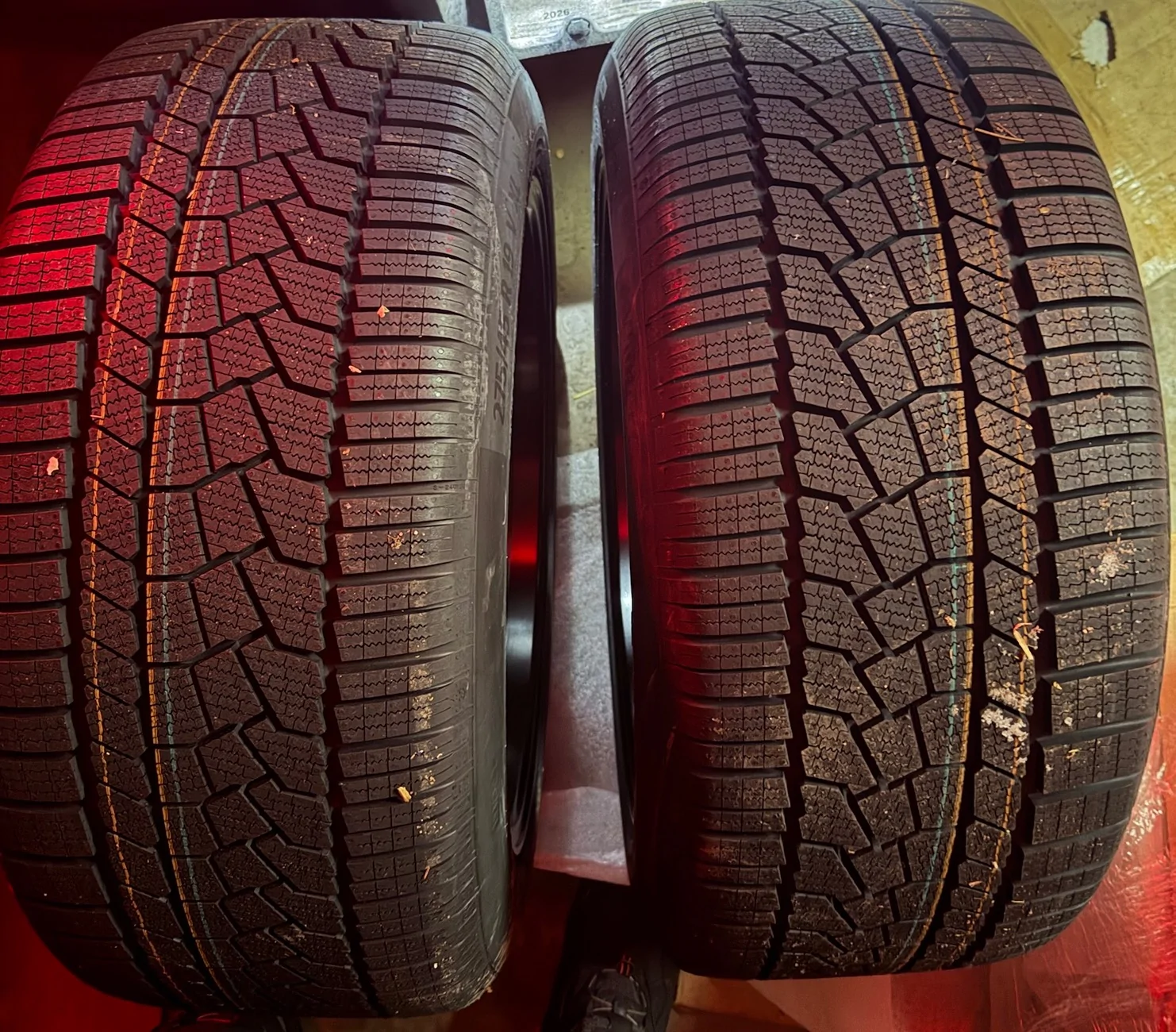

I understand there's an inside/outside. The tires came pre-mounted on the wheels. I'm asking if there's an R/L because each of the tires above could be mounted to L or R side.

There is a "Rotation" label and arrow on the outside of the tire. A Google search indicates your tire model is directional.

Taycan tires are different front and back, so presuming they've been mounted correctly. see if there is a ROTATION direction marked on the outside of the tire, and if so, it indicated the direction the wheel is turning when the car is going forward. I have winter, all-season, and summer wheels with tires for my Taycan, only the winter tires (Goodyear) are directional (the tread is in a V shape) so there is only one place each wheel can be installed. The all seasons (Continental) and summer (Michelin) are unidirectional.

I’ve looked for over an hour and both inside and outside sidewalls lack any rotation arrow or indicator. That’s what has me so confused. I thought this would be a straightforward OEM process, especially with these somewhat directional wheels.
