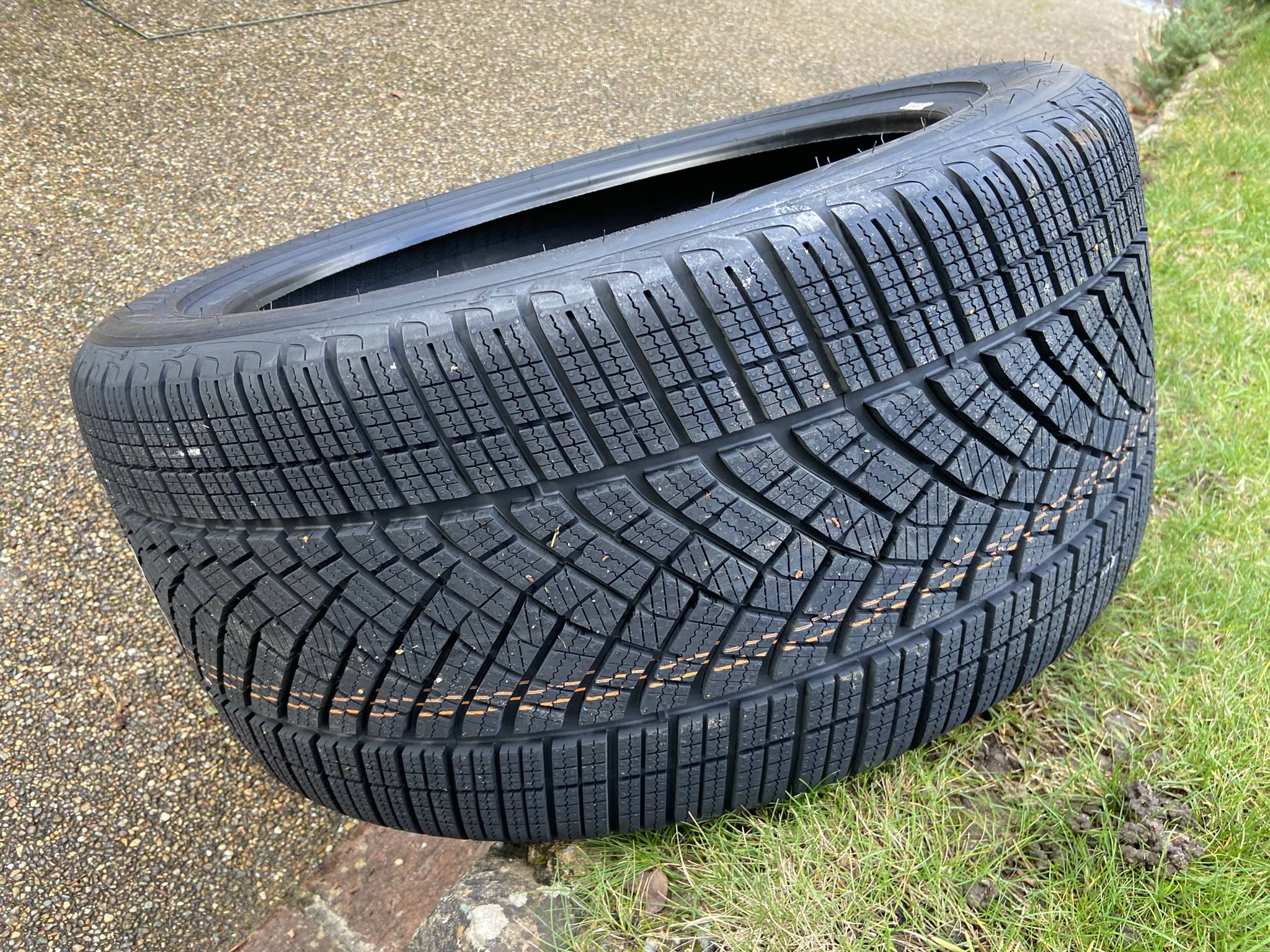

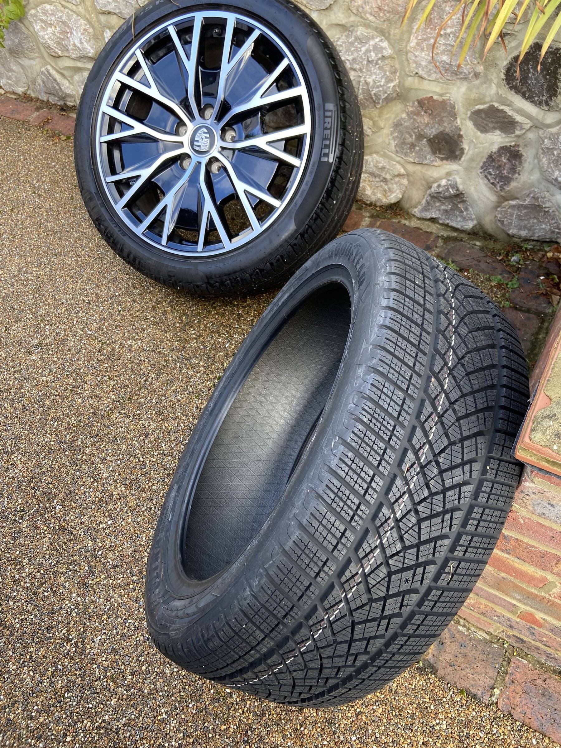

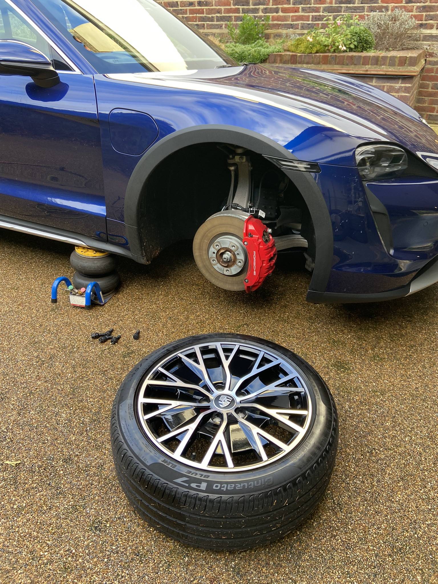

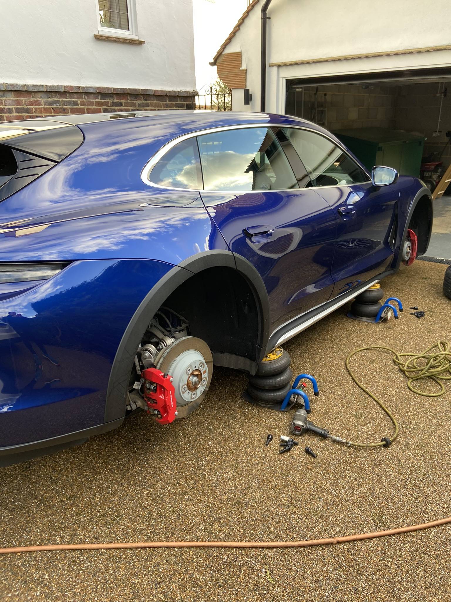

Winter shoes on today
Porsche Taycan WINTER TYRES (UK) 445D12DB-AAC6-4572-9BB9-540DFD5CEBCF

Those rotors make me happy about the PCCB and PSCB options – purely from a cosmetic non-rust perspective.
Kept my iPace ones relatively unrusted (though harder to do on the rears) though that doesn’t have as high a regen (think 150 max vs 270 but still hard to get near using the discs…). Charge to 100% and a couple of hard braking zones to roundabouts does it for me. Now upsold myself to a Turbo then won’t be an issue as you stated.
