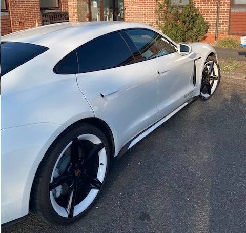

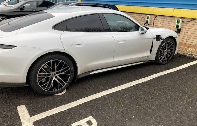

Just had winter wheels put on today, will be interesting to see if I see any improvement although it is still fairly mild in the UK.
I always used to swap to winter tyres with previous performance cars but haven't over the past couple of years as didn't really think that they really made that much difference, but think they may on the Taycan.
I have experienced some in-consistency with the breaking, and am sure it ties in with a couple of re-calls I have had. All cars will obviously break differently and you can adapt to that, but what I find a little un-nerving is that I sometimes get a different amount of travel on the breaks and an overall feel, which is a little more difficult to take into account for.
We have a TS and also a CT TS on the fleet so am going to take them out for a spin to see how different the breaking and consistency are on those.
Before and after pics, forgive the state of the car in the after :)
Porsche Taycan Winter tyres on today TT1
Porsche Taycan Winter tyres on today TT2

Looking at the wheels, assume that is 21" to 20" ? Was recalibration needed at all?

Yeah is a 21" to a 20", when you first drive the car after the change is comes up with a warning on the dash saying 'Tyre change detected make selection". You then need to re-calibrate, it gives you a selection of wheel/tyre types to choose from, 21" Summer, 20" Winter etc. so is pretty specific, on previous cars it has just asked for a calibration rather than asking specifically what you have put on.

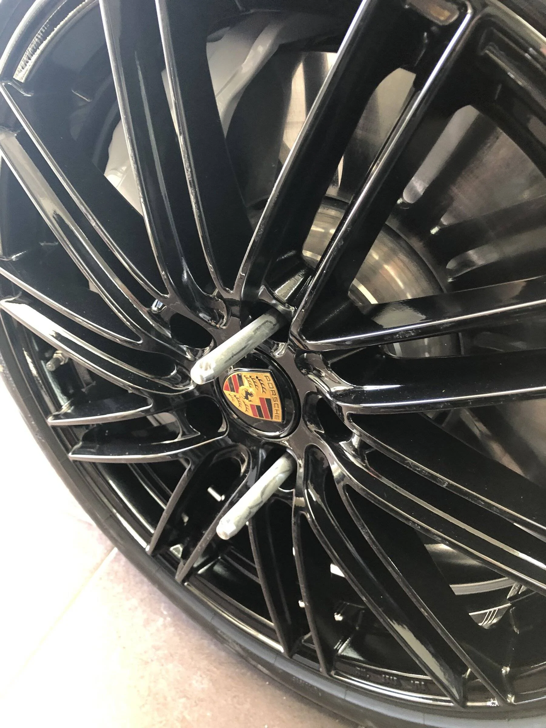

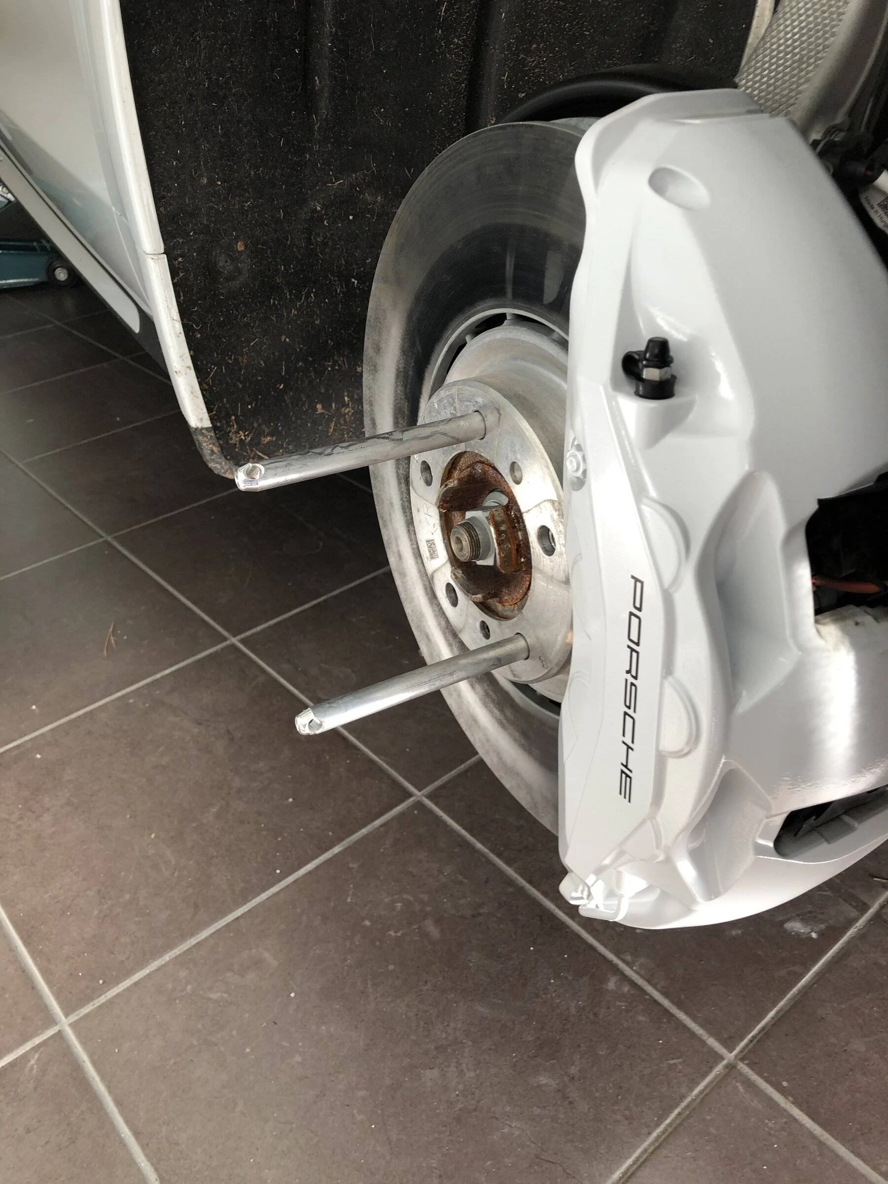

You can easily do this yourself if you have a good way of safely lifting the car. And get some of these guide pins to easily slip off the 21 inch wheeLe and slip on the 20 inch. They cost about 10 Euro each. Makes a huge difference and helps not to damage the rims or get any scratches On them.
Porsche Taycan Winter tyres on today 952A2C7B-E262-471E-8D6F-C5E9B7A2CCEC
Porsche Taycan Winter tyres on today D1B92D71-5464-4920-B131-167612CBE7D8
