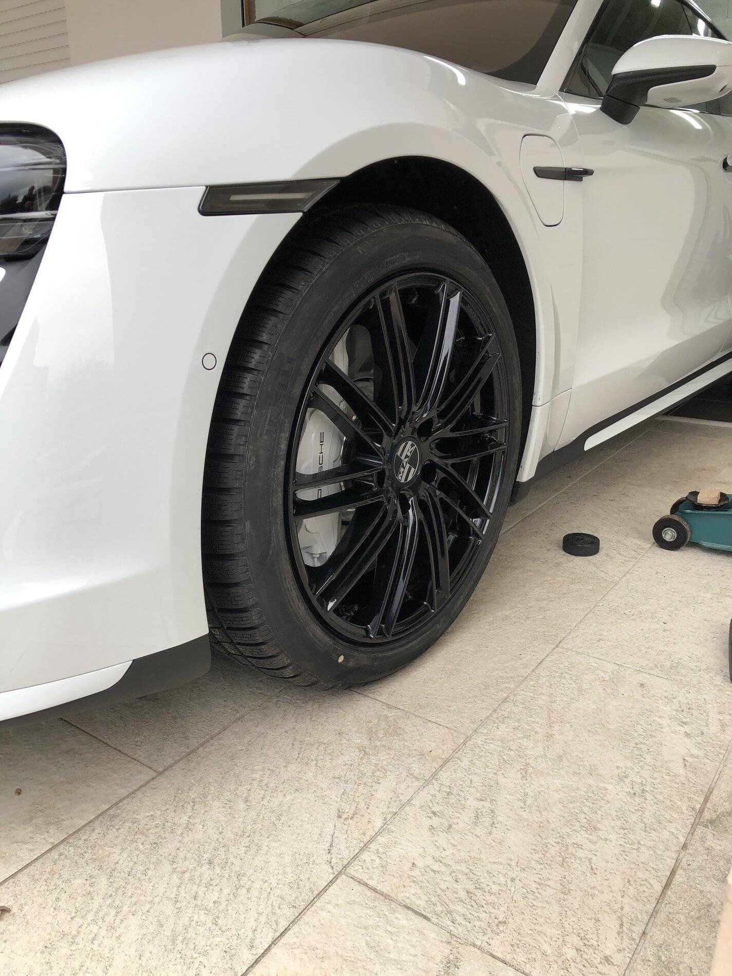

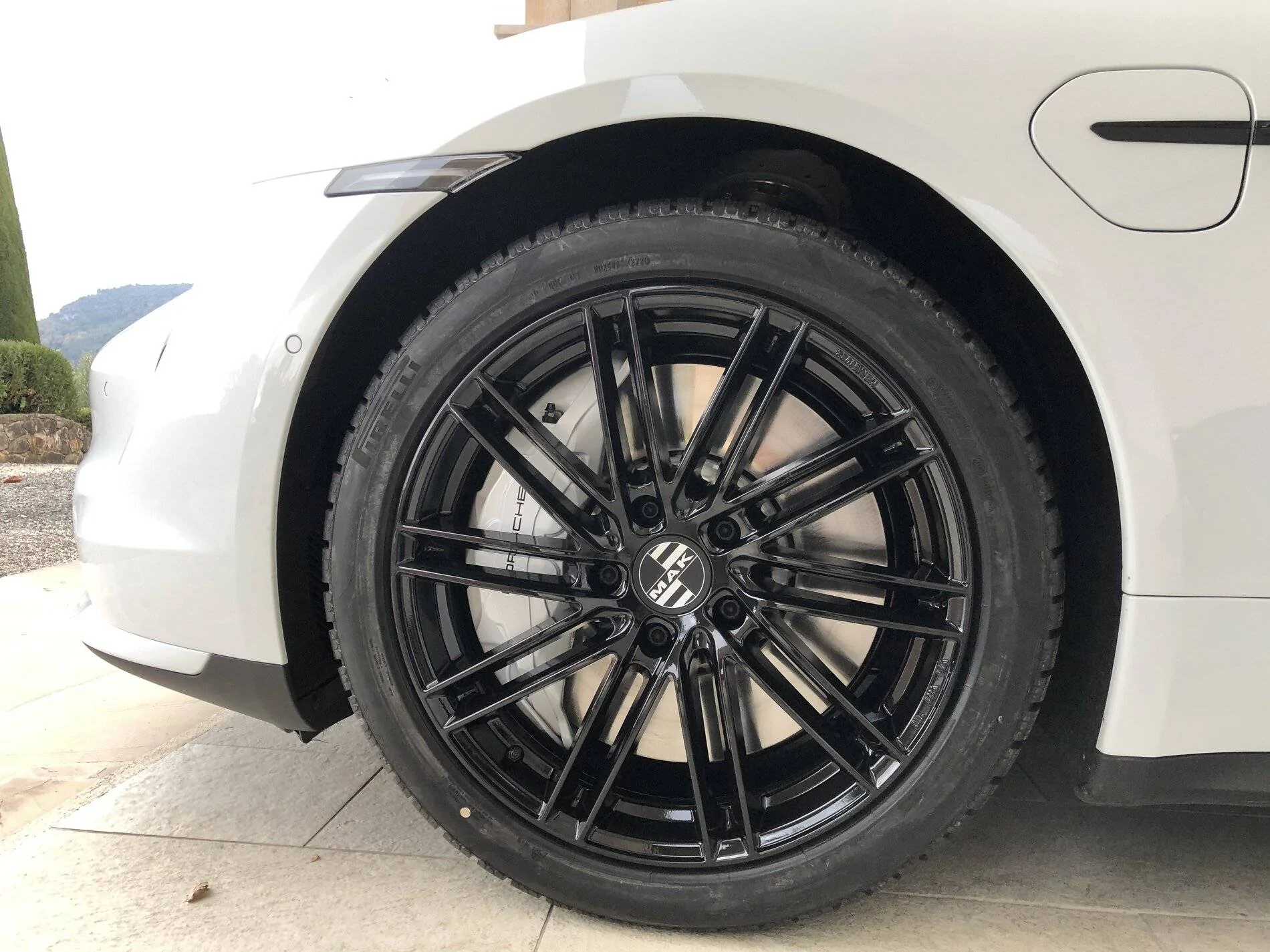

The tyres I have chosen are the new Pirelli PZero Winter 20 inch.
I had a little bit of issue to get the tyre sensors to work, so you might want to check with them. That could be country dependant or....? Here is a few pictures of mine.

Looks great. What widths and ET Offsets are they?
3,904
3,549
Here are the data that I have.
MAK LeipzigD 20 inch Gloss Black
Fronts: 9.0J x 20 ET 50, Center bore 71.6, bolt pattern 5x130
Rears: 11,5J x 20 ET 60 Center bore 71.6, bolt pattern 5x130
Pirelli P Zero winter tyres 245/45 R20 and 285/40 R20 NFO.
Hope that helps!
I am going to order some new wheel hubs from Porsche. But so far very pleased with the package . No issues about any extra noise and the tyres certainly feel a bit softer tha5 the 21’s on the colder weather. I have seen slightly lower consumption but I have not tested this I any detail. But it certainly not been any increase.

Thanks for the info. ?
Not sure I would be happy personally with 285's on an 11.5 inch rim as that makes the tyre width of 285mm narrow than the wheel width of 292mm.
I honestly just followed the recommendations, but you have a very valid point.

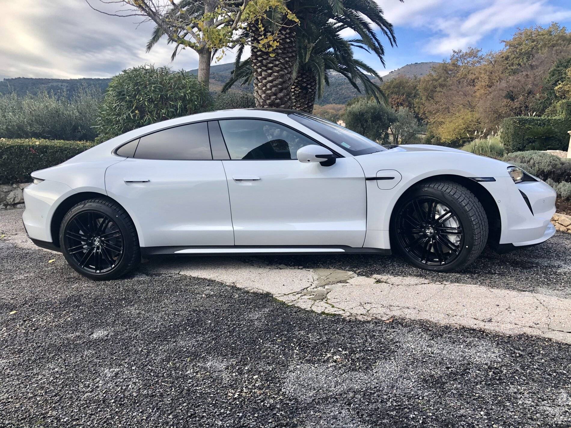

Great experience with performance alloys. Got these:
Porsche Taycan Winter wheel sets for Turbo - UK suggestions 1608777838874
See the pictures on the car here. I got the PZero Winter tires (same size as the ones directly from Porsche).
