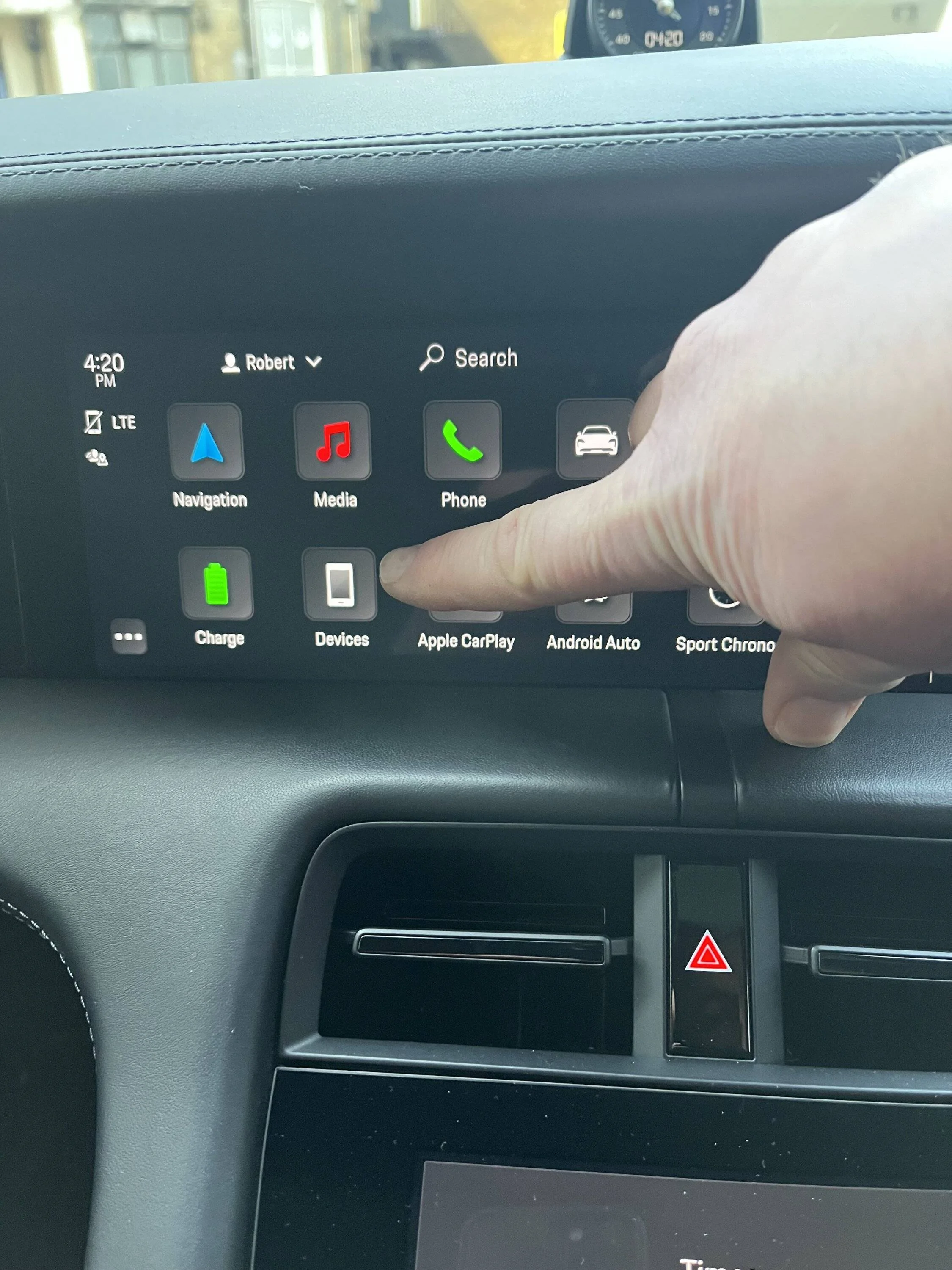

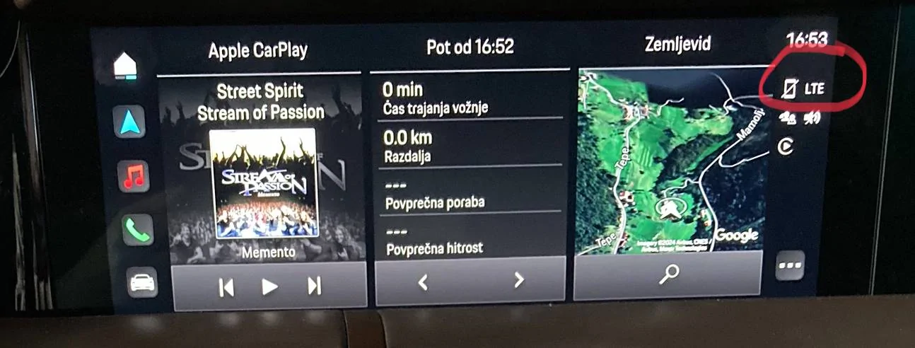

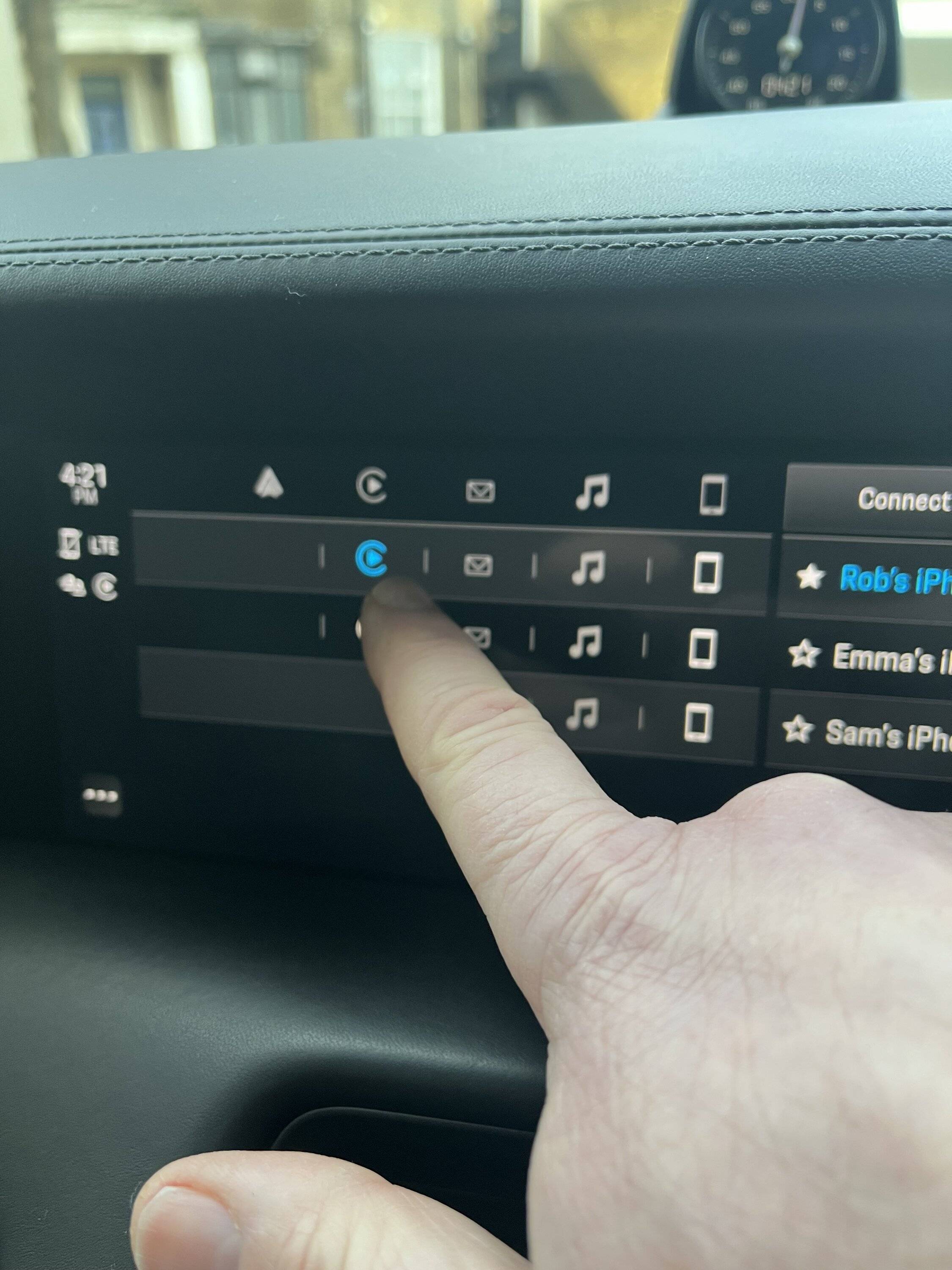

Your 2nd screen looks the same as mine, if I press on my way ?‍♂
2 different ways to get to the same screen.

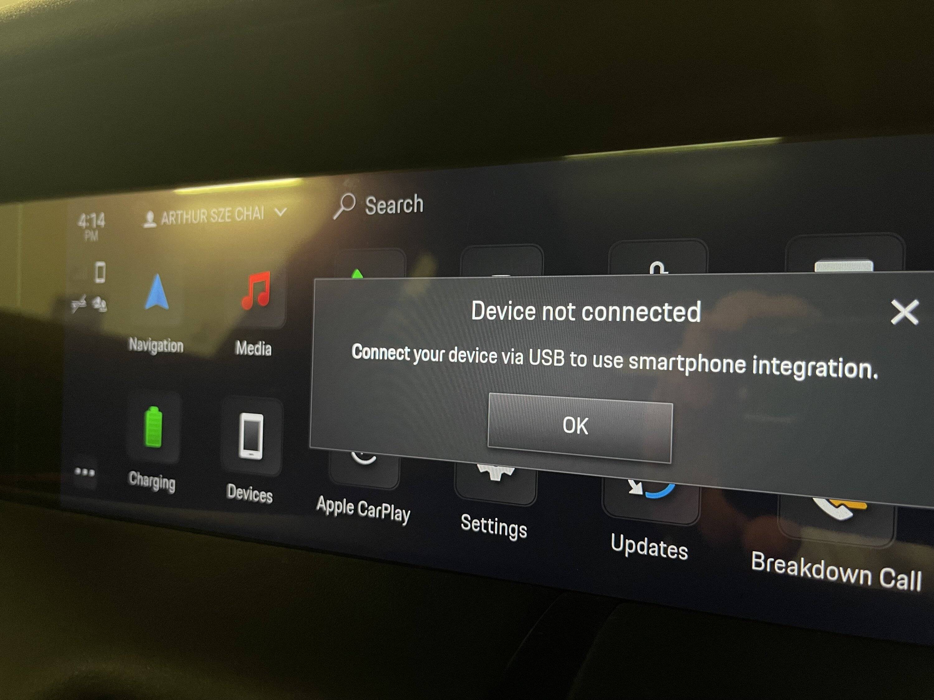

My iphone 12 pro max can connect wirelessly to the porsche pcm, but the apple carplay button never turna green unless i plug in the wire...
It always display the msg as in this photo.

Strange. Do you have the 17.3.1 update?
I wonder if it is a hardware limitation of the 12. Call Apple and ask. They've been very good at answering questions when I ran into outlier situations.

If you're finding that only wired CarPlay is working, it's possible that you may have disabled auto-connect for your vehicle's WiFi settings. This often happens if you ever tried to manually connect to your car's WiFi as a hotspot.
To diagnose, when in your car and with the ignition on:
1. Open Settings > Wi-Fi
2. When your vehicle's Wi-Fi networks appear, tap the "(i)" button.
3. Verify that "Auto-Join" is enabled.
You'll need to do this for both your 2.4Ghz and 5Ghz Wi-Fi vehicle connections.
