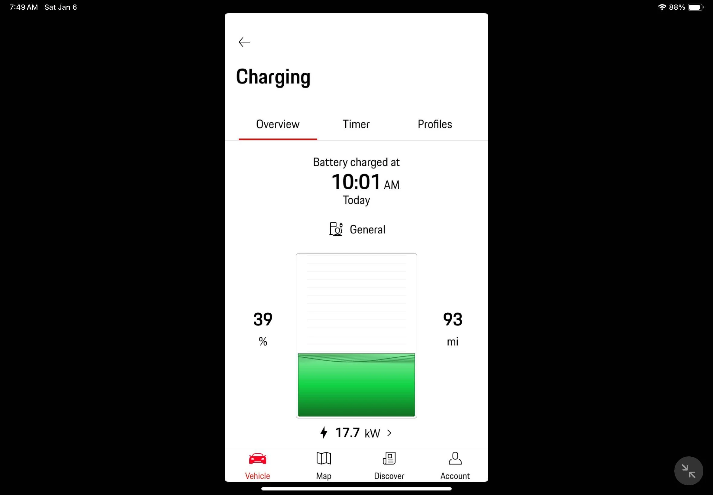

Guess I’m in the minority but I love my PWCC. I just plugged the Taycan in at 34% and it will be at 85% in less than three hours At 18kwh. Plus my F150 lightning loves it.
I'm with you. I've been using the PWCC for over a year with no issues. If you have the 19.2 Kw option on your Taycan, as I do and it seems you do as well, I feel it is a good option.
Yep. And my lightning can take 19.2 KW as well so it really is ideal for me. Plus it looks cool as shit!
