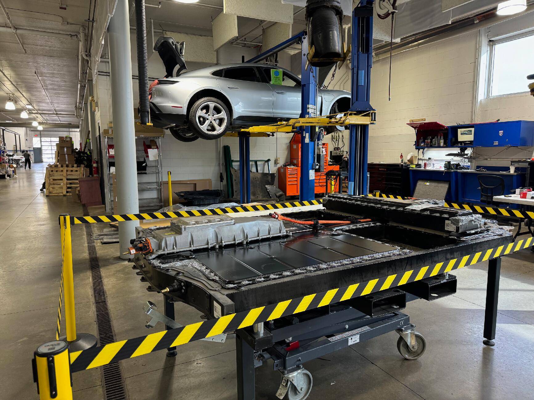

Update....some progress....work on battery done, resealed, re-install in progress.
Interesting picture. I can' help but wonder if they have a little towing vehicle to move this bad boy. Apparently it weighs 1,388 pounds (630 kg), and I see a tow bar on the front.
I'm not impressed with the sealing that was done. You would think that the surface that connects directly to the top of the battery will require them to slice off all of the excess sealant. Unless of course there is a gap of some sort.

So.....aparently....on completion of cell work, and for re-assembly, the top plate is held by six techs and lowered into place. This has to be done inside a set number of minutes after the seal is prepared. Each of the plate bolt tops are covered in the sealant.....apparently plenty of sealant is not a problem.

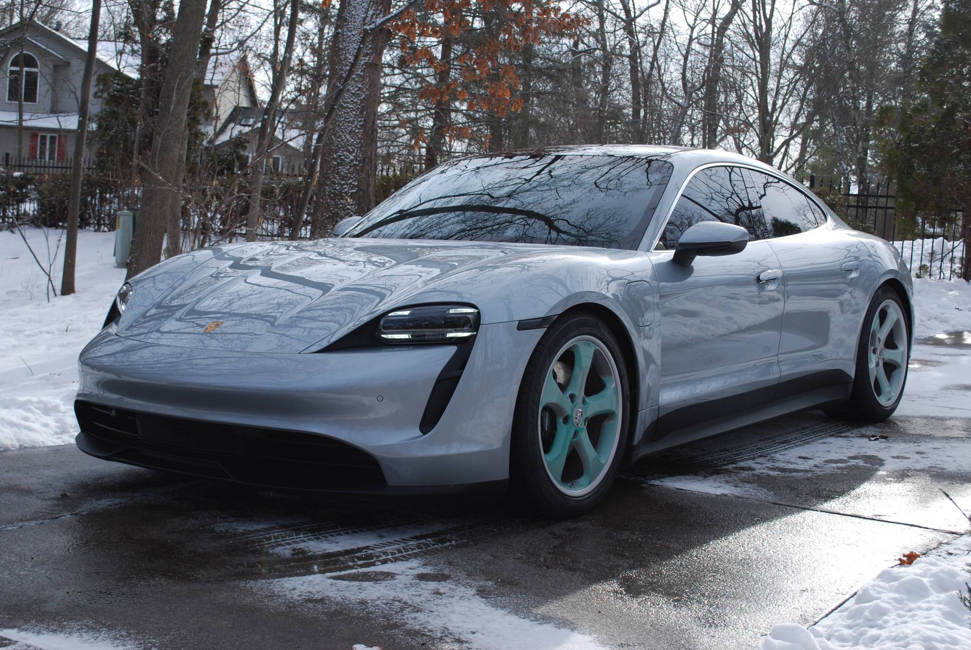

Back in my garage. A normal charge uneventful.
My wife has her car back.
