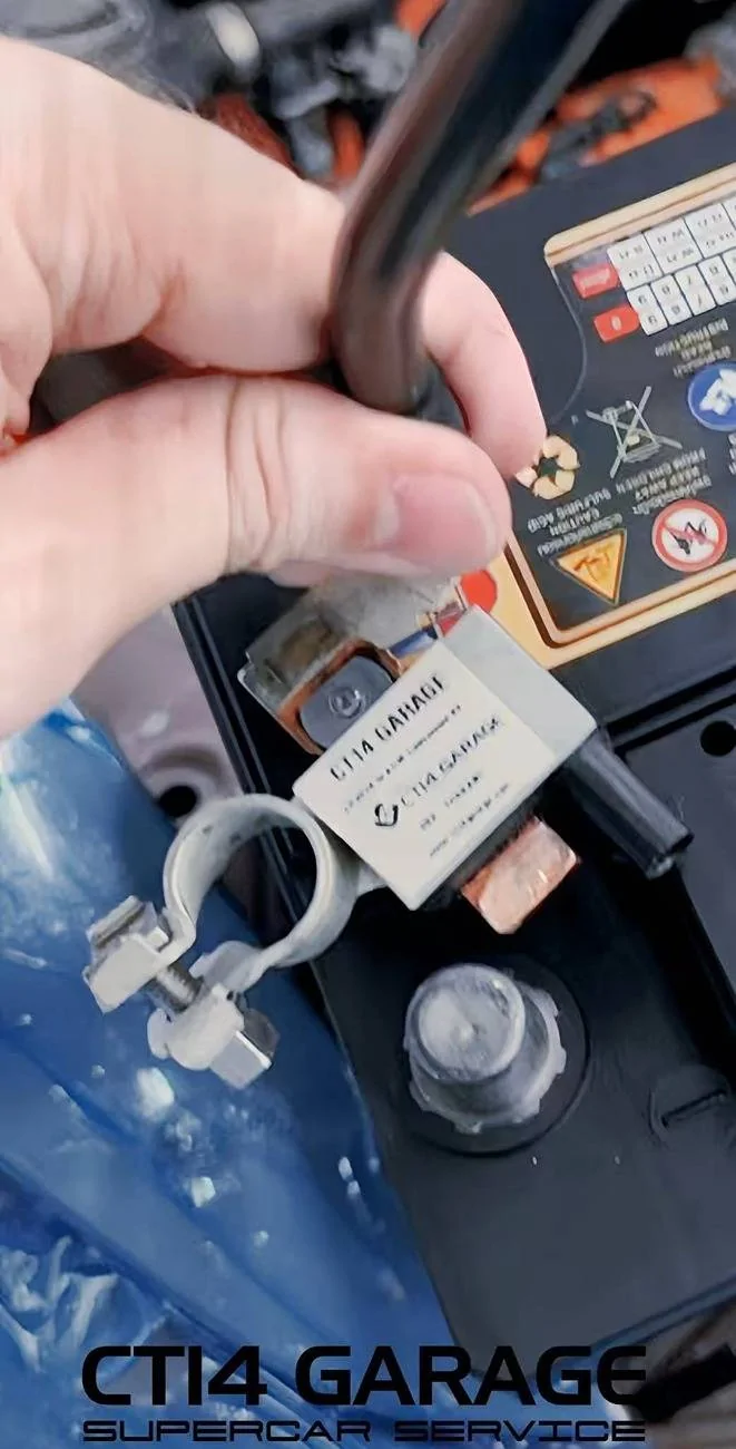

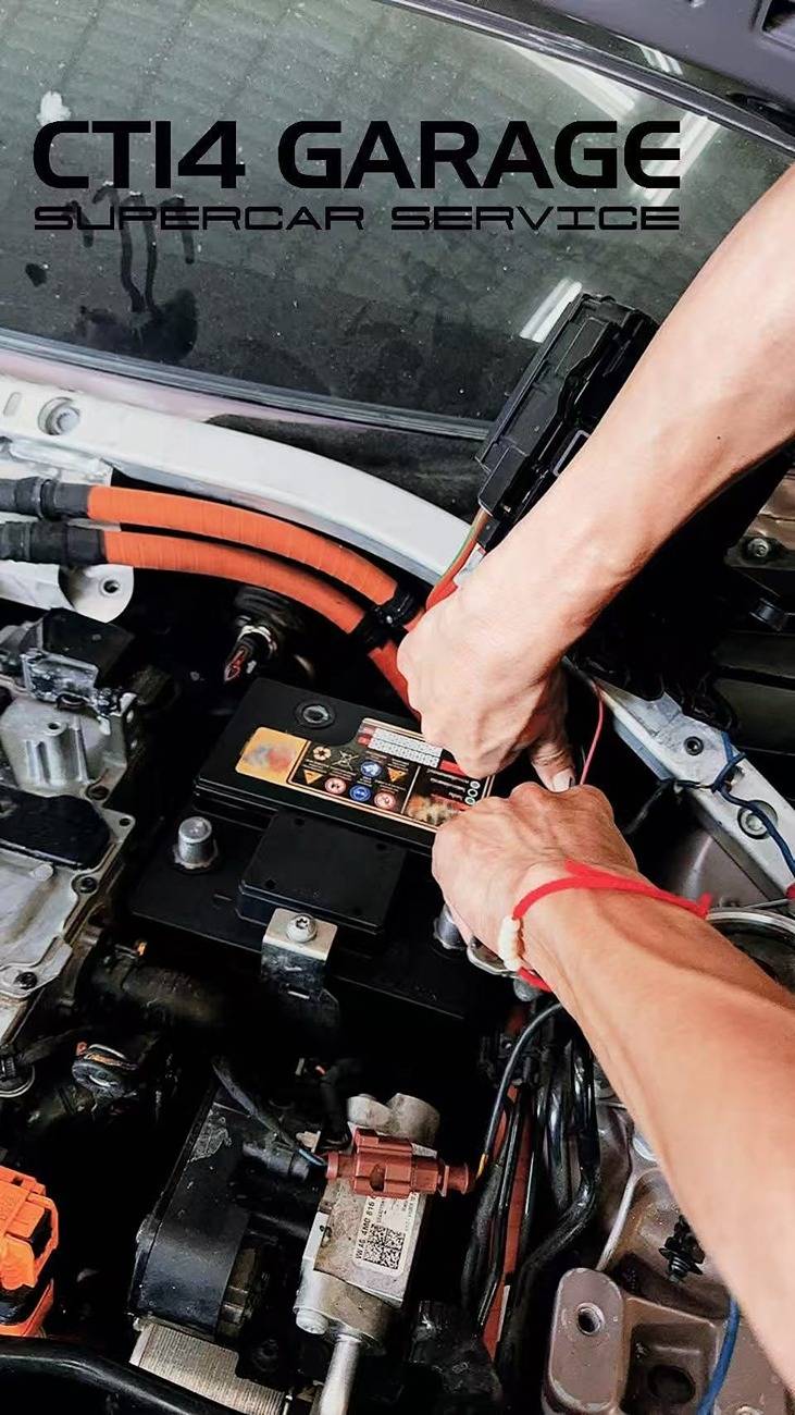

Your LiFePo4 12V battery is fucked... replace it with an AGM one.
We do this to all our customers, cheap, reliable, it's the best option really. The Taycan Gateway is ready to accept any AGM or even Gel battery with a very simple coding. Porsche used the LiFePo4 crap just to look good I guess.
Don't bother with it, they're super expense and the company that makes that battery A123System went bankrupt lmfao
AGM is the way to go

You need a conversion kit with a negative wire and voltage sensing kit so the car can correctly read the voltage.
Battery should be LN0 40Ah AGM
