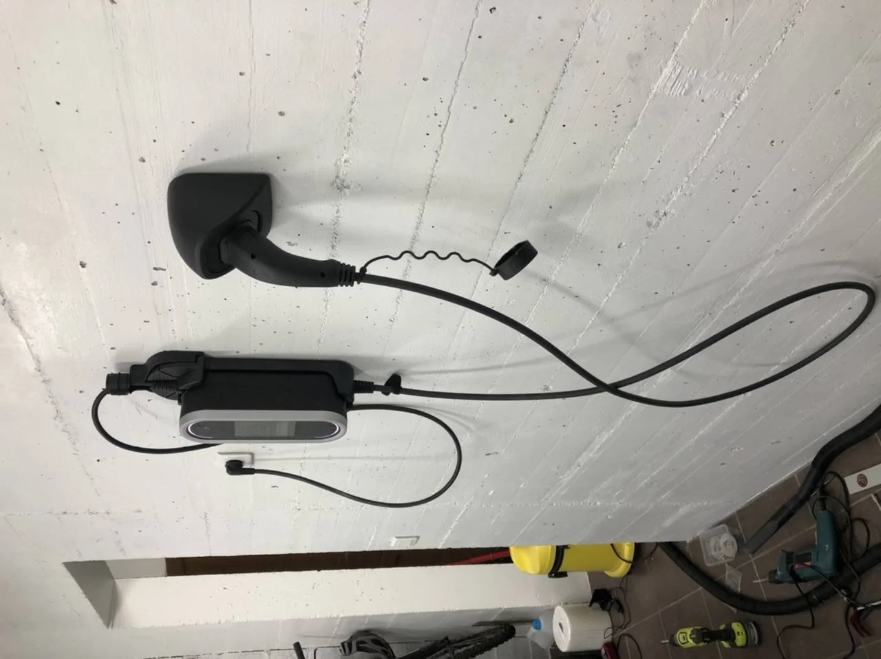

I have the charger on the wall in my garage and plugged into a normal wall socket. The socket is fused at 16 amps, 240 volt. And the charger can be set to charge at between 6 amp to 10 amps. See picture below. Works ok but takes a long time for charging. I will upgrade the wiring and put in a new industrial supply that will give me the full 11 kW charge.

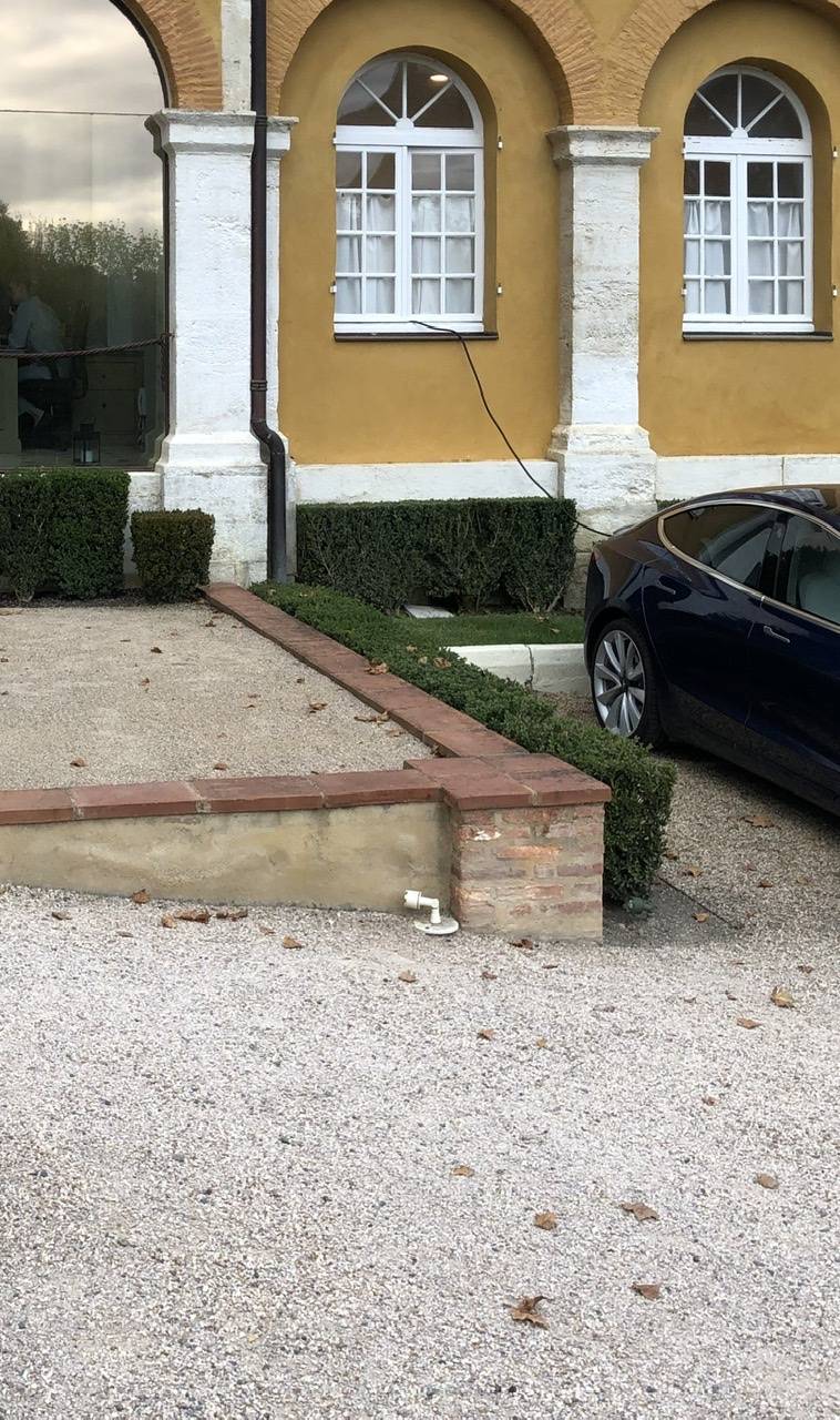

We made a trip in our Tesla last year to a hotel way off the main roads. Asking if the Hotel had any EV charging facility they said “ No but we have a spare socket in our reception that you can use” . We parked just outside and they plugged in my mobile charger in the office, which was manned all night long. The socket was rated at 16 amp so we set the car to charge at 10 amps and it worked a treat!
Below is a picture of the car with the lead going in to the hotel reception.:)
