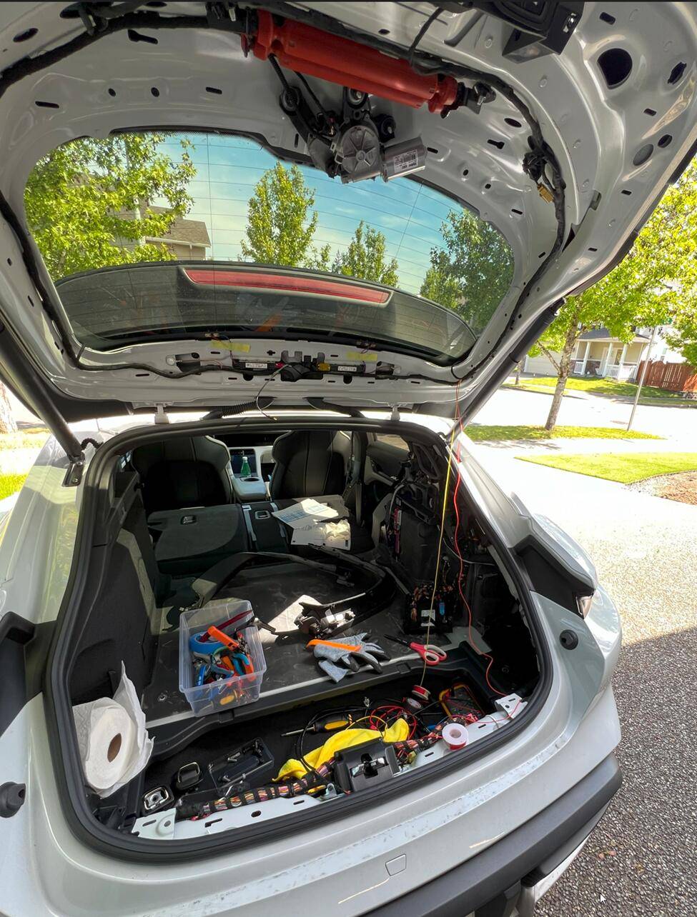

So I decided to fix them, to improve the functionality and safety of my vehicle. You’d think it should be easy enough, given Taycans in the rest of the world already have proper tail lights. Unfortunately, since Porsche is not making all their technical information publicly available, it took some reverse engineering, which means time investment. This post is meant to save this time for other trying to do the same (or in some cases, I heard people have hit a dead-end with this, with multiple Porsche dealers stumped by this).

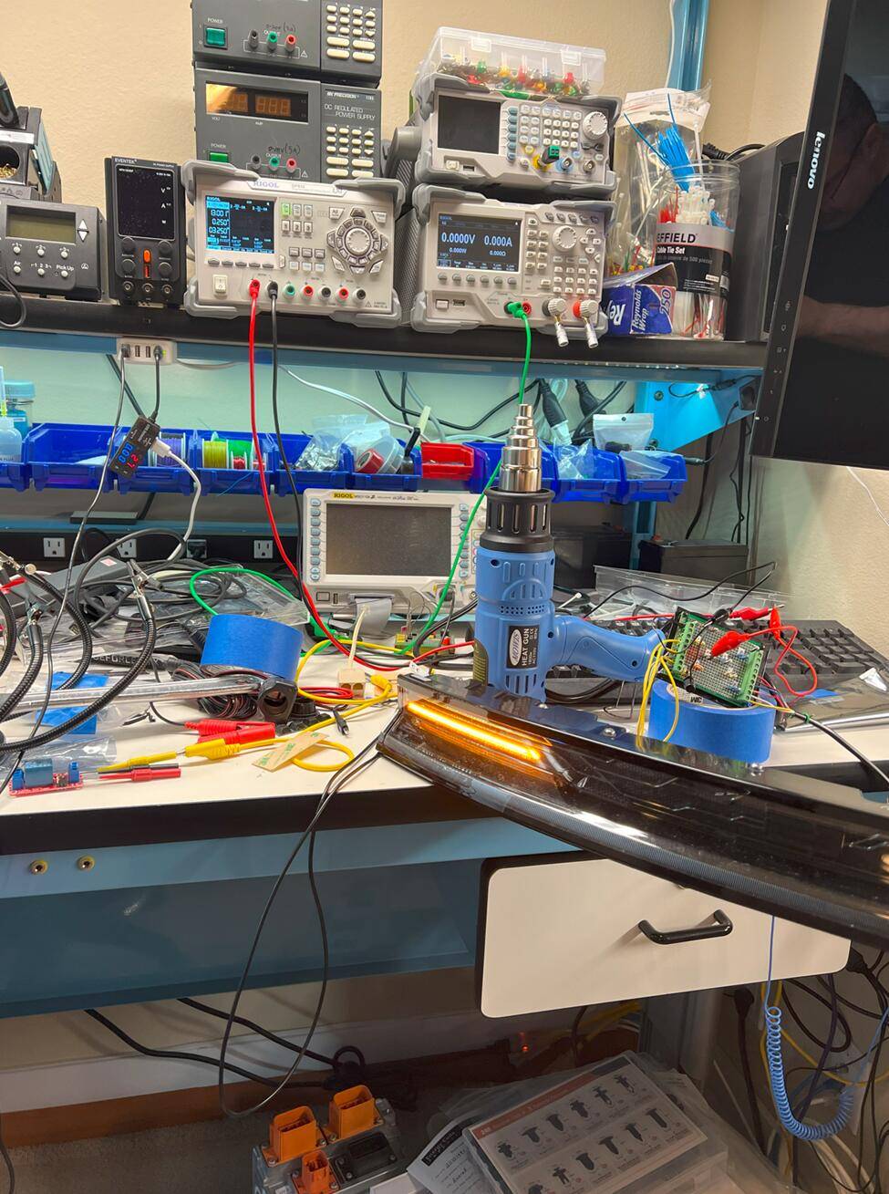

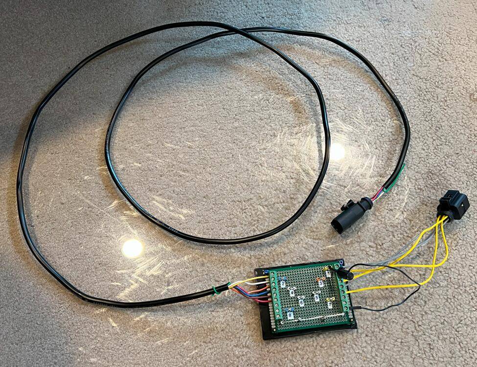

I built myself some extensions for the tail lights with breakout board for easy probing, like this:

and went old school signal probing.
And some lab bench testing:

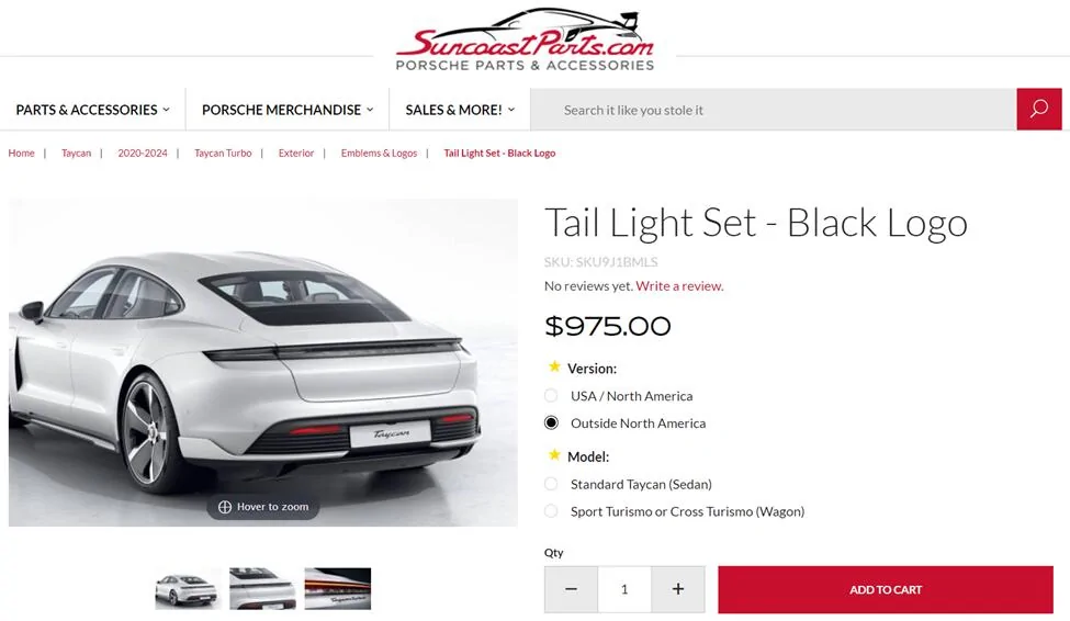

  1. European tail lights (a set of 3) for your car (sedan or sport turismo). You can get them from Porsche dealers in the US, I got mine online here (you can also get it with blue PORSCHE logo here - as a matter of fact, a whole new set of tail lights costs about the same as the optional blue logo upgrade at order time):

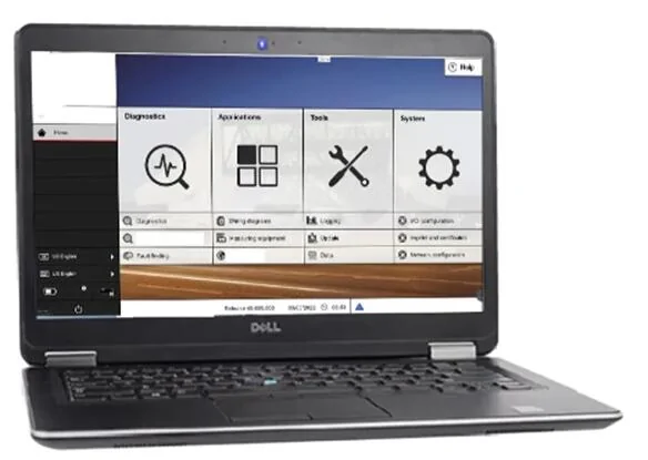

  2. Access to PIWIS3 to recode your car. Other OBD2 scanners may be able to do it, but you’ll have to figure out yourself the steps. You can probably pay your friendly dealer to do the recoding as well.

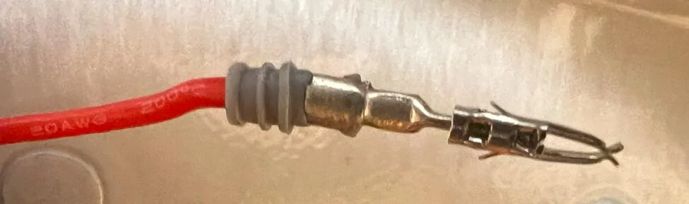

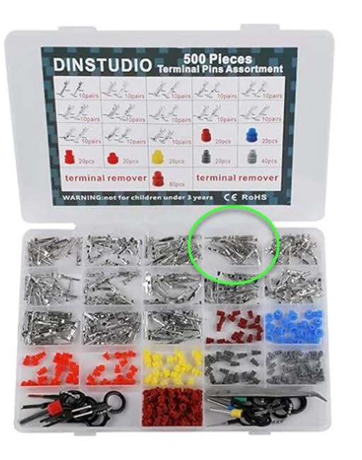

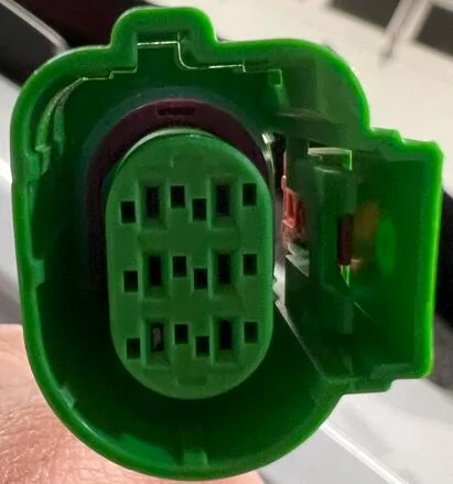

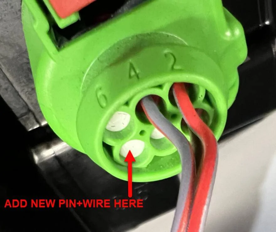

  7. 2 pins you need to add to the 6 and 8 pin connectors for the center lights. You can get then from a similar connector, or a set of spare pins you can buy on Amazon, like this one (I circled the ones which I used from this kit):
    Porsche Taycan How-to DIY guide to retrofit Euro tail lights on North American Taycans 1718704776008-s3
    Here is what the pin looks like (this is one of the ones I added):
    Porsche Taycan How-to DIY guide to retrofit Euro tail lights on North American Taycans 1718704792500-k

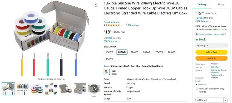

  8. 2 6m rolls of AWG20 automotive wire like this AWG20 with silicone insulation from Amazon:
    Porsche Taycan How-to DIY guide to retrofit Euro tail lights on North American Taycans 1718704834148-w8

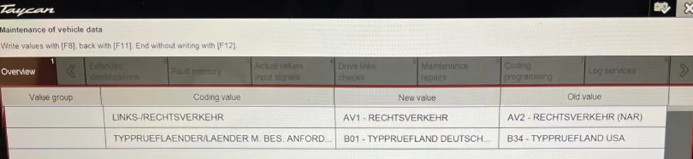

To recode the BCM2 you will need access to PIWIS3. You may be able to just pay your dealer to do it. The steps are as follows:
  1. Go to Vehicle Maintenance
  2. Change the following two values:
    Porsche Taycan How-to DIY guide to retrofit Euro tail lights on North American Taycans 1718704952813-2
  3. Save the new values
  4. Go back to ECU list, select BCM2 and Auto Code (not Program) it
  5. Go back to Vehicle Maintenance and change the values from step to back
  6. Save the restored values

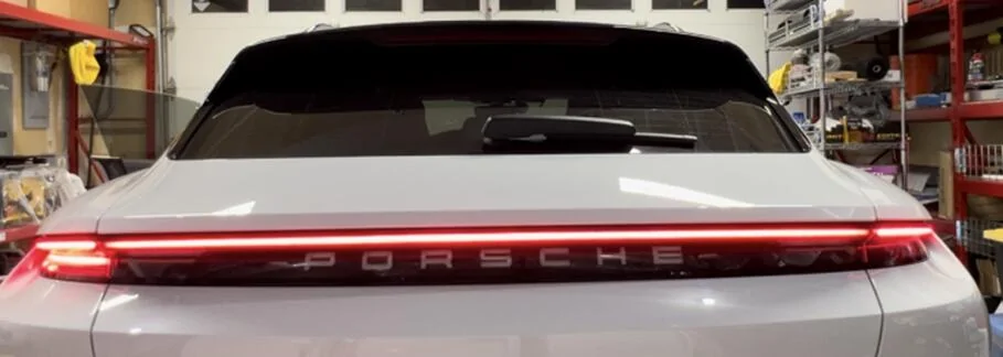

Once recoded, the US lights work like this (still better IMO than Euro lights without recoding):
Braking:
Porsche Taycan How-to DIY guide to retrofit Euro tail lights on North American Taycans 1718704968456-9c
Turn signal:
Porsche Taycan How-to DIY guide to retrofit Euro tail lights on North American Taycans 1718704974271-oa

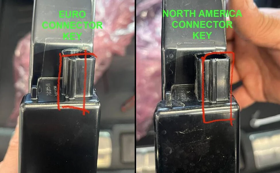

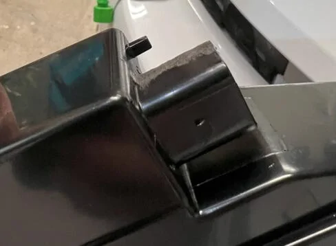

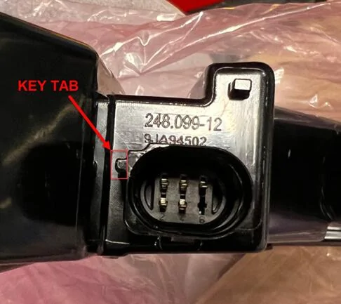

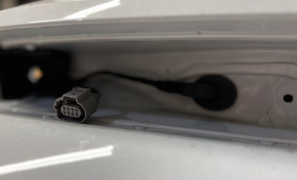

Step 2: Make the connectors fit
The two options here are either swap the 4 connectors on your car’s harness, or just file down the Euro key tabs on the light so that they can fit the North American harness connectors. I went with the latter, filed down the key tabs on the 4 connectors on the 3 light pieces, to allow the US keyed harness to plug into them.
Euro connector on the lights:
Porsche Taycan How-to DIY guide to retrofit Euro tail lights on North American Taycans 1718704994938-7
N.A. connector on the harness:
Porsche Taycan How-to DIY guide to retrofit Euro tail lights on North American Taycans 1718705016392-dg
After filing it down:
Porsche Taycan How-to DIY guide to retrofit Euro tail lights on North American Taycans 1718705035782-ro
Here is a good comparison using pictures by another member from this post.
Porsche Taycan How-to DIY guide to retrofit Euro tail lights on North American Taycans 1718705051076-su

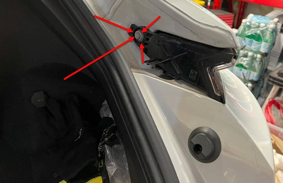

Step 3: Remove old lights
I have a Cross Turismo, so I will show the steps required to do it here. For sedan, it is slightly more complicated, but search the internet (or even this forum) and I know there is information on how to do that. For the Cross Turismo:
Side lights are held by one 10mm screw on the inside of the trunk. Just carefully pry off the plastic cover, and the screw is right there.
Porsche Taycan How-to DIY guide to retrofit Euro tail lights on North American Taycans 1718705106870-i

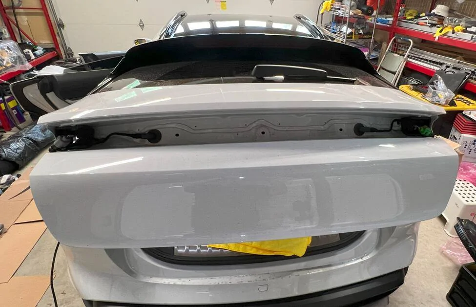

The center light is held with 5 screws. To get to middle 3 you will have to remove the bottom hatch panel (it is all held on just slips, no screws) and the orange weights (blocking the middle screw access). Picture below shows the location of the 5 screws:
Porsche Taycan How-to DIY guide to retrofit Euro tail lights on North American Taycans 1719100785751-ad
The side screws are hiding under plastic covers, one on each side, which also pries out, but be careful prying, one of the tabs (rear most) is really stubborn an easy to break off (though don’t fret if you do break it, it can be remedied with some Velcro instead, or even nothing, as the other tabs will hold the plastic cover nice and tight anyways).
Once unscrewed, the center light bar just slides out. Make sure you disconnect the connectors on each side before fully removing it.
Porsche Taycan How-to DIY guide to retrofit Euro tail lights on North American Taycans 1718705176127-7v

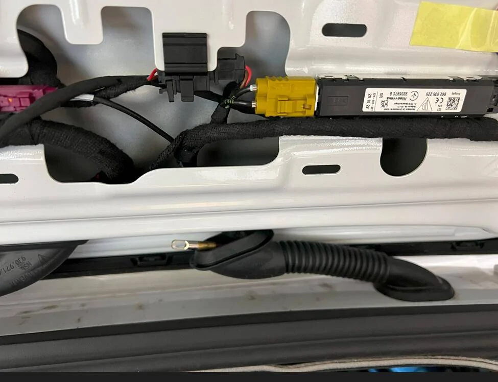

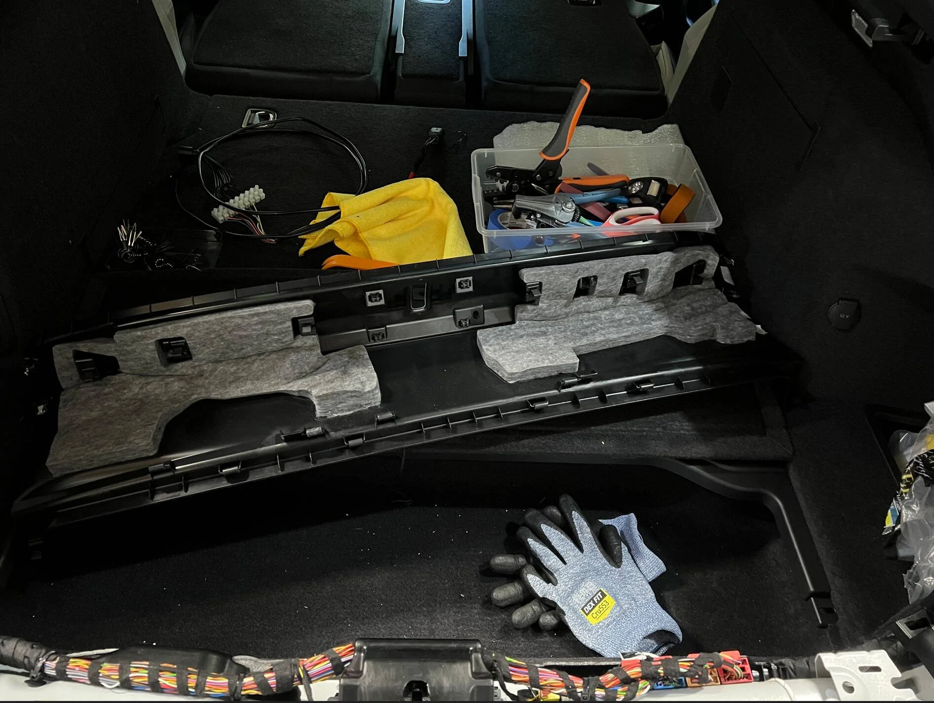

Step 4: Add missing wires to the harnesses

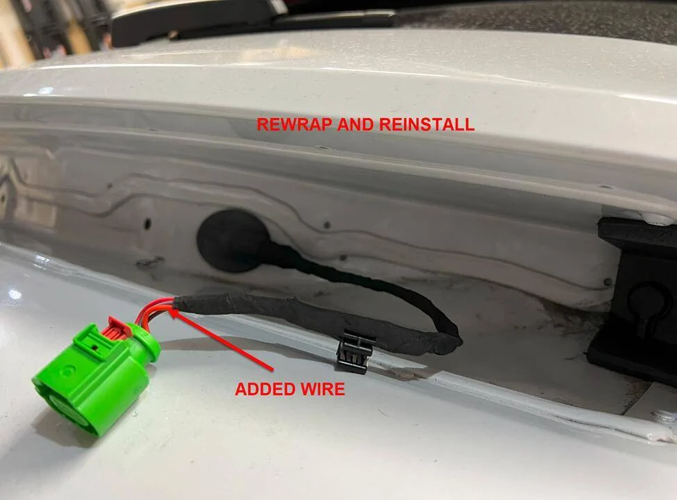

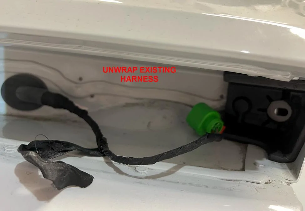

At this point you need to add 1 wire to each of the center light bar connectors. You need to add PIN5 to both of them (one is a 6 pin connector, one is an 8-pin connector). Here is a picture the right, green connector:
Porsche Taycan How-to DIY guide to retrofit Euro tail lights on North American Taycans 1718705201102-b5
You need to wire the pin 5 into the car. I ran the wire together with the original harness.
Porsche Taycan How-to DIY guide to retrofit Euro tail lights on North American Taycans 1718705223898-tr
Porsche Taycan How-to DIY guide to retrofit Euro tail lights on North American Taycans 1718705236477-ls
Porsche Taycan How-to DIY guide to retrofit Euro tail lights on North American Taycans 1718705252962-s
Porsche Taycan How-to DIY guide to retrofit Euro tail lights on North American Taycans 1718705275660-xc
Repeat the same with the 8 pin connector on the left (also pin 5 needs to be wired in).
Porsche Taycan How-to DIY guide to retrofit Euro tail lights on North American Taycans 1718705296756-dm

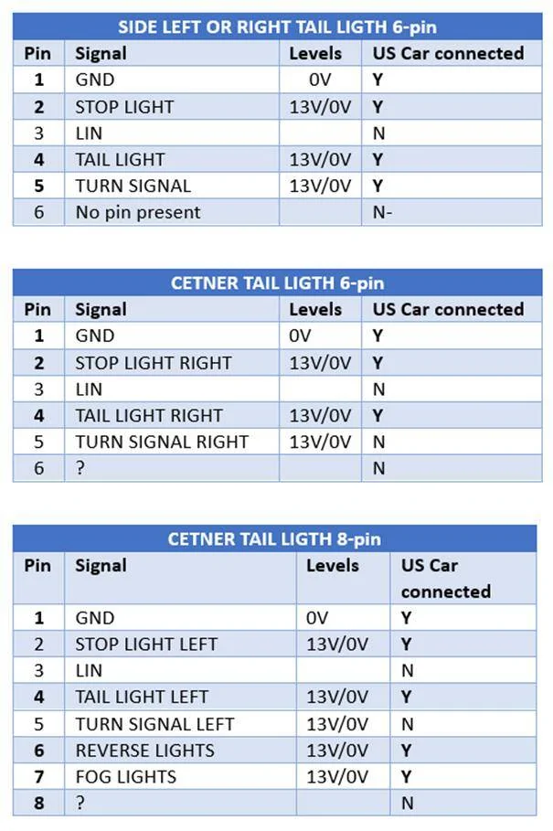

For those interested in the tail light pinouts, here is what I figured out them to be:
Porsche Taycan How-to DIY guide to retrofit Euro tail lights on North American Taycans 1718705333562-7d
As you can see, the side lights are already wired for separate turn signal, only the center lights for some reason were not. You are adding pin 5’s to both center tail light connectors.

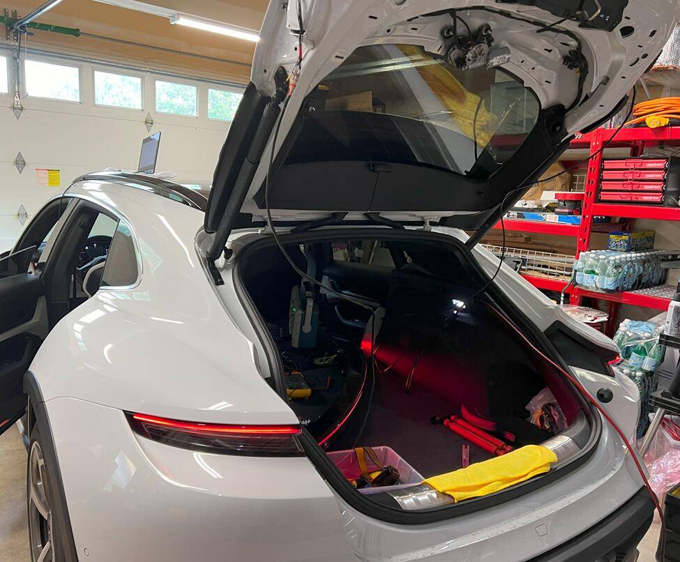

At this point you can install the new lights. They will not be 100% working as Euro light yet, but they will mostly work, and the size of the working parts is already larger than a Model Y turn signal for example.

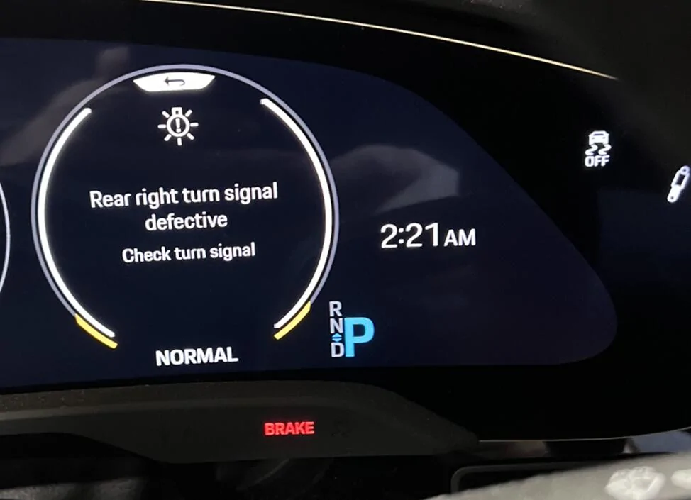

IMPORTANT: at this stage, even though the lights are mostly working, you will be getting errors on the instrument cluster about the missing center tail light turn signals, like this:
Porsche Taycan How-to DIY guide to retrofit Euro tail lights on North American Taycans 1718705355068-xq
The turn signal sound will also be sped up to indicate an error, even if you dismiss the warning on the IC.

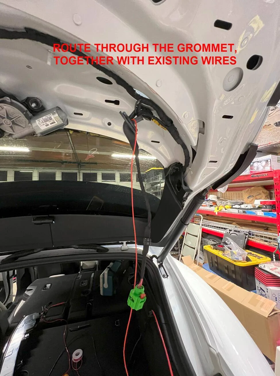

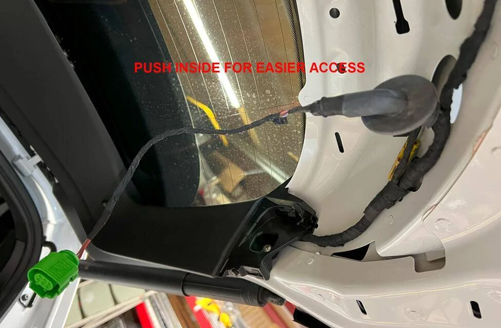

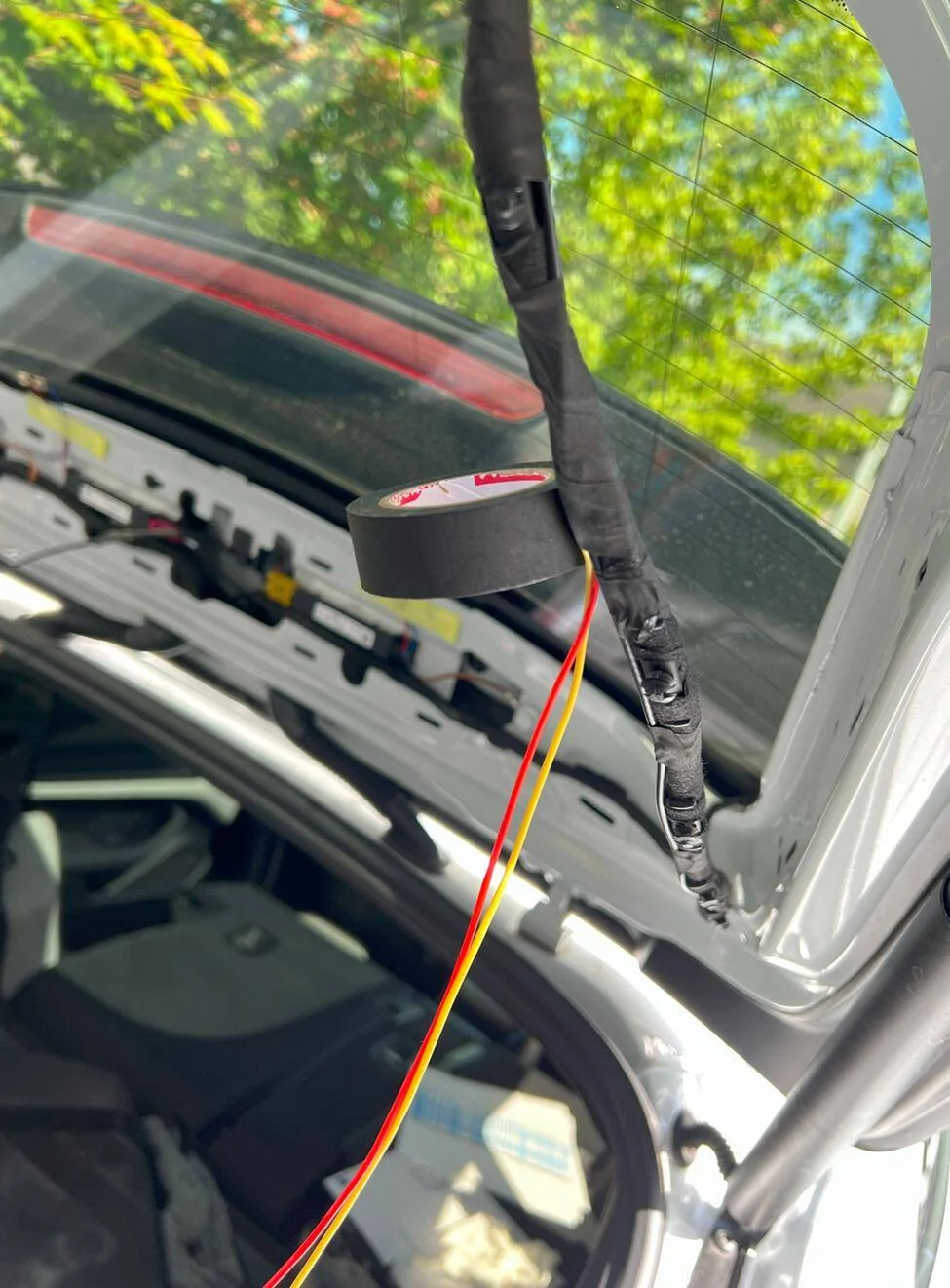

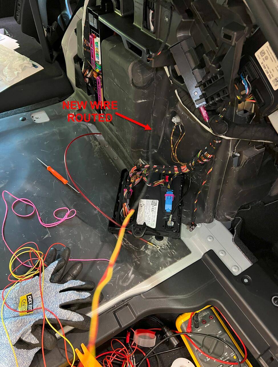

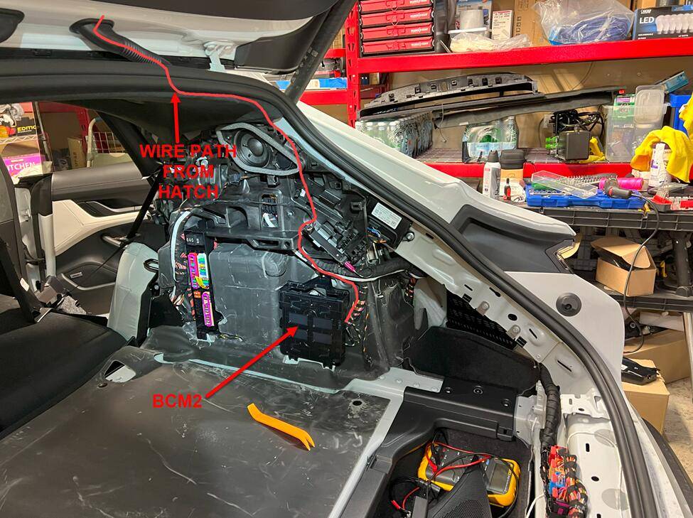

Step 6: Wire the newly added harness wires to BCM2
To run the wire to the BCM, you will need to run it along the original wires in the hatch, through the rubber boot that takes you under the roof lining, then to the rear right where the BCM is:
Porsche Taycan How-to DIY guide to retrofit Euro tail lights on North American Taycans 1718705377260-oc

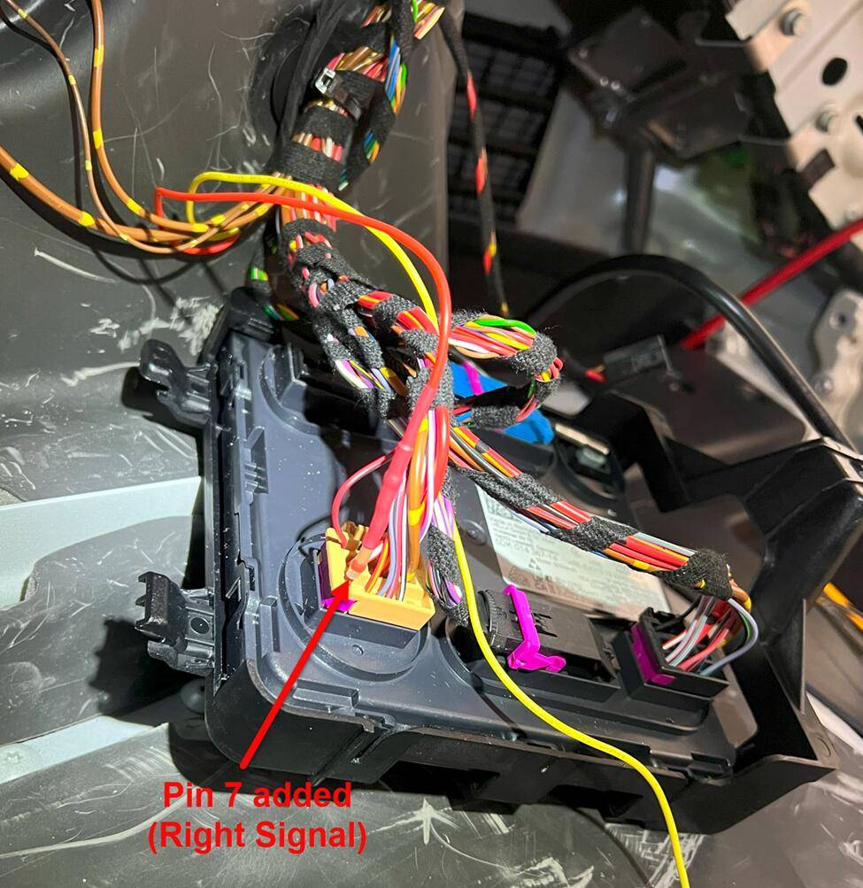

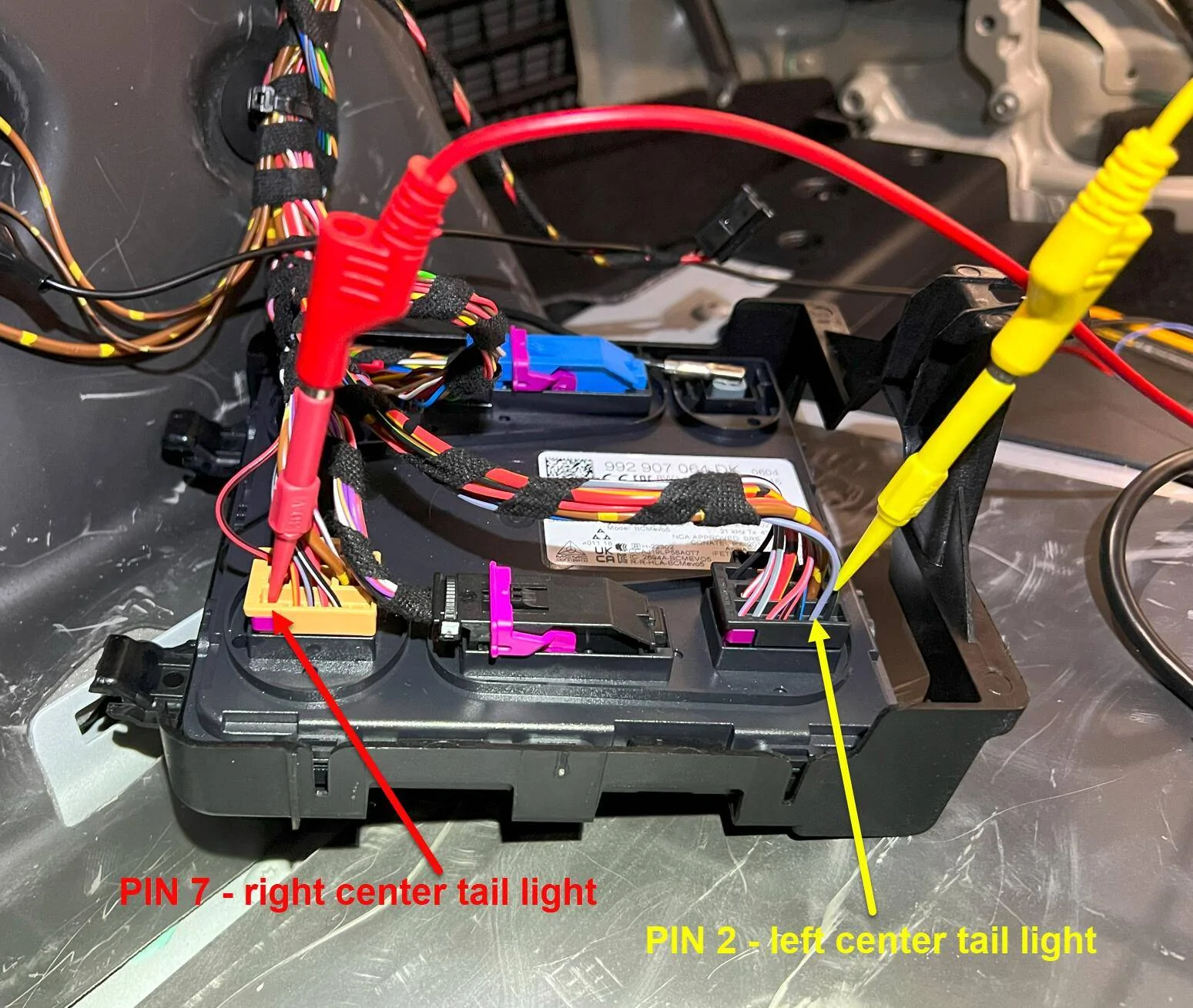

Your end goal is to connect the 2 new wires to the BCM2 connectors shown below:
Porsche Taycan How-to DIY guide to retrofit Euro tail lights on North American Taycans 1718706413210-e5

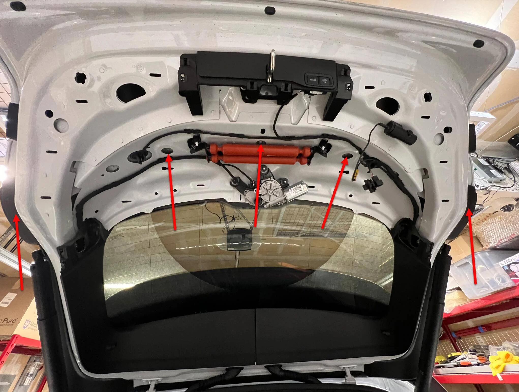

To run the wire in the hatch, you will have to remove the two remaining panels which are secured by 1 screw each. After unscrewing you can just pry the panels to remove them, run the wire along existing harnesses.
Porsche Taycan How-to DIY guide to retrofit Euro tail lights on North American Taycans 1718705411512-z
Porsche Taycan How-to DIY guide to retrofit Euro tail lights on North American Taycans 1718705429400-3j
Porsche Taycan How-to DIY guide to retrofit Euro tail lights on North American Taycans 1718705475547-z

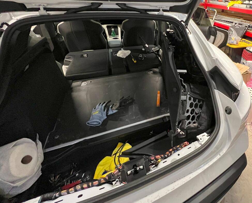

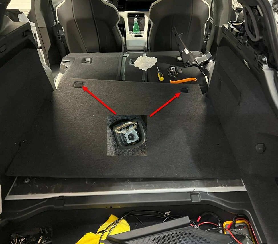

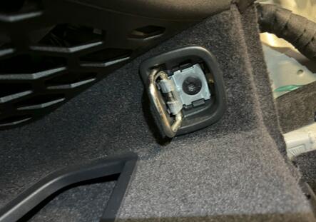

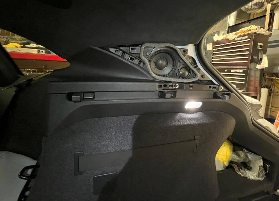

To get to the BCM 2, you will need to:
  1. Remove the floor panel which is secured with the two screws holding the luggage clips. Slide it backwards after unscrewing to release the back mounts.
    Porsche Taycan How-to DIY guide to retrofit Euro tail lights on North American Taycans 1718705526365-8m
  2. Remove the rear panel (the one on the very back wall of the car), it's just clipped on
    Porsche Taycan How-to DIY guide to retrofit Euro tail lights on North American Taycans 1718712921035-i7
  3. Remove the speaker grill (pry gently)
    Porsche Taycan How-to DIY guide to retrofit Euro tail lights on North American Taycans 1718705567497-d

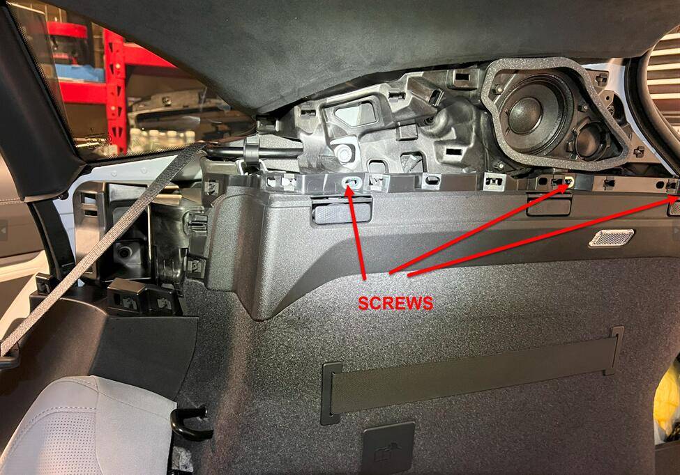

  4. Remove the panel which has the seat belt going through it:
    Porsche Taycan How-to DIY guide to retrofit Euro tail lights on North American Taycans 1718705598679-wq
  5. Unscrew the 3 screws holding the side panel (see previous picture)
  6. Remove the luggage clip on the back wall holding the side panel
    Porsche Taycan How-to DIY guide to retrofit Euro tail lights on North American Taycans 1718705626099-v4
  7. Gently pry the side panel
    Porsche Taycan How-to DIY guide to retrofit Euro tail lights on North American Taycans 1718705669098-f5
  8. Disconnect the 12V socket and trunk light before removing the side panel
Once side panel removed, finish routing of the new wires to the BCM2,
Porsche Taycan How-to DIY guide to retrofit Euro tail lights on North American Taycans 1718705845359-uy

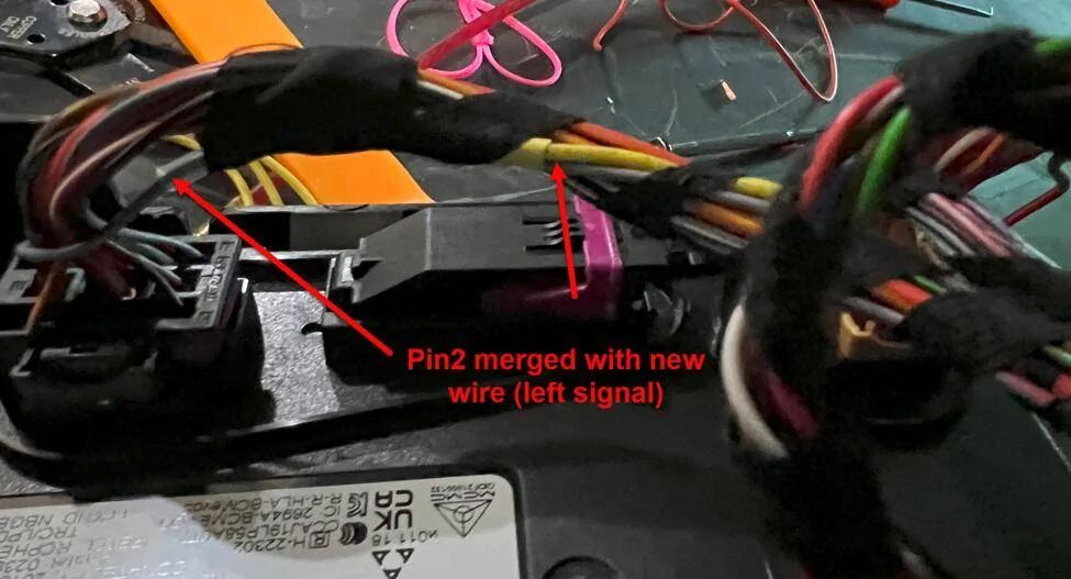

Then add Pin 7 to the yellow/orange connector and connect it to the right signal wire.
Porsche Taycan How-to DIY guide to retrofit Euro tail lights on North American Taycans 1718705871583-qy
Next, connect the left signal wire to the grey wire which is already connected to pin 2 of the black connector. If pin is missing there, add a pin like to the yellow/orange connector. I’m only saying this because the grey wire doesn’t seem to be wired to anything (disconnecting it will not change any behaviors or throw errors, but I left it connected just in case EDIT: see warning #3 at the end of this post what the grey wire is).
Porsche Taycan How-to DIY guide to retrofit Euro tail lights on North American Taycans 1718705901604-m1

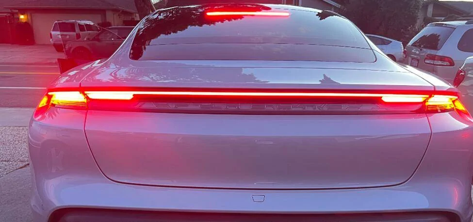

Step 7: Put everything back together in reverse order.

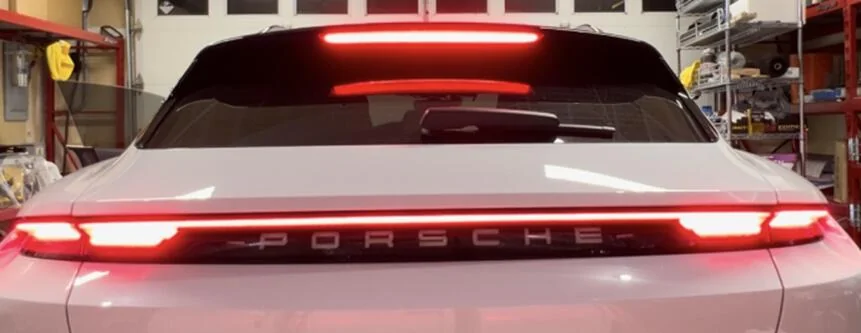

You are done. Your new lights should work like this now.

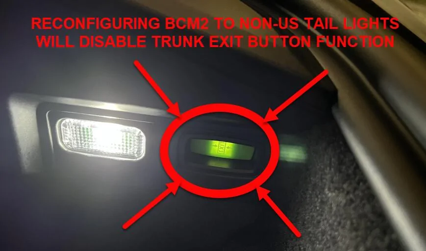

  3. It took me a while to figure this out, but there is one side effect of reconfiguring BCM2 to Euro tail lights. It turns out the pins from BCM2 which control the Euro center turn signals are used in the US for the trunk exit lights/buttons (not present in the rest of the world). This means that recoding the BCM2 to non-US function will disable this functionality. This also explains why I found one of them connected on my CT (only front trunk), and others have found both pins connected on sedan (front and back trunks).
However, you don’t have to do any of that, as you can benefit from my effort. I am posting below what you need to know if you want to swap your tail lights. I also found out that it’s very possible that the Taycan factory tail lights might already support animation, but I’ll post that speculation, and information for others to follow up I they are interested in another thread.

  6. 2 pins you need to add to the 6 and 8 pin connectors for the center lights. You can get then from a similar connector, or a set of spare pins you can buy on Amazon, like this one (I circled the ones which I used from this kit):
  7. 2 6m rolls of AWG20 automotive wire like this AWG20 with silicone insulation from Amazon:
  8. 1 or 2 pins for the VW/SKODA 17 pin connector. You can get one on Amazon for a premium $40 price (which will get you 14 pins like the on you need) here:
  9. Or if you plan ahead you can find them on places like AliExpress way cheaper, like this one for $2.

Step 1: Purchase Euro Tail Lights
Frist, you need to purchase European tail lights (a set of 3) for your car (sedan or sport turismo). You can get them from Porsche dealers in the US, I got mine online:
Step 2: Recode Rear BCM (a.k.a. BCM2)
I suggest doing this step first to make sure you can in fact recode the BCM2, or else you will be stuck with some really odd functioning tail lights at the end of step 6 if you just swap in the Euro lights – the outside turn signals will light up together with stop lights, stop lights with still serve as turn signals, and the center light bar turn signal will not function at all. There is post here which has a short video showing how this looks. This is what brake lights look like in that case:
It would drive me nuts to drive something like this, hence my suggestion to recode first. However, with all of the above said, technically you can do this any time you want, even at the very end.
Braking:
Turn signal:
Step 3: Make the connectors fit
Step 4: Remove old lights
The center light is held with 5 screws. To get to middle 3 you will have to remove the bottom hatch panel (it is all held on just slips, no screws) and the orange weights (blocking the middle screw access). Picture below shows the 3 screws after removing the bottom panel:
Step 5: Add missing wires to the harnesses
Step 6: Install the new lights
Step 7: Wire the newly added harness wires to BCM2
Next, connect the left signal wire to the grey wire which is already connected to pin 2 of the black connector. If pin is missing there, add a pin like to the yellow/orange connector. I’m only saying this because the grey wire doesn’t seem to be wired to anything (disconnecting it will not change any behaviors or throw errors, but I left it connected just in case).
