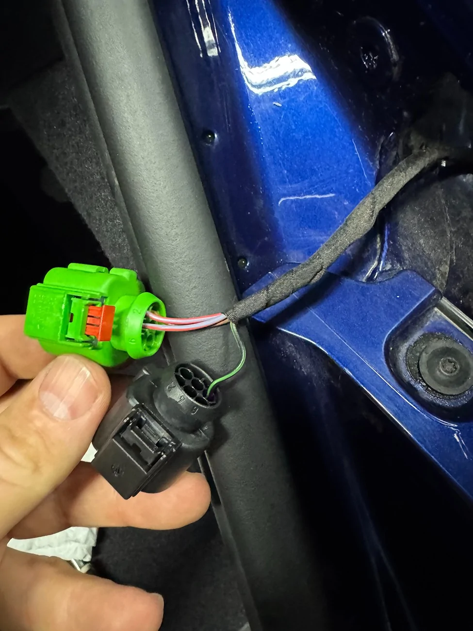

I finished wiring the car over the weekend, and unlike @whitex both of my BCM2 connectors (black connector pin 2 and brown connector pin 7) had wires present. Sure is nice to have a full compliment of amber signals, much better than North American red.

Congrats! I bet it feels great to finally get to the end of your months long retrofit adventure. :like:
Fyi, I never did figure out where that existing wire went. When I disconnected it, no errors or warnings were shown, and all turn signals still worked fine. I left it connected. My best guess is that either it's going nowhere (they reused some harness originally intended for something else that contained that extra wire - my car was build during supply chain shortages), or perhaps it was intended for the custom Porsche bike rack? This reminds me, I need to add a warning for anyone using or planning to use the OEM bike rack or anything else that plugs into the trailer plug possibly counting on North American stop/turn signal combo - warning added to post #1.
