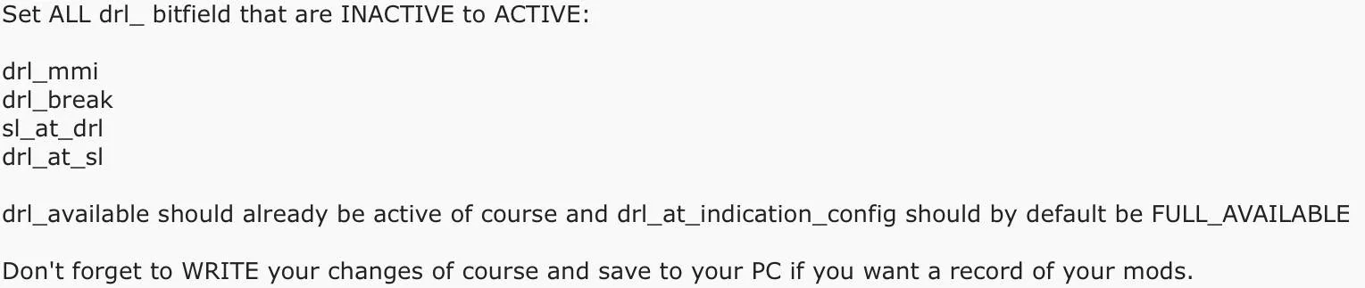

These are the 4 settings you’d need to change for the rear light bar to follow the same behavior as DRL.
Porsche Taycan How to keep Rear LED strip always ON? IMG_1105
You’ll need to be in developer / E mode. These settings are under control unit BCM1 / manual coding / Kodierwert.
Thanks for sharing, do you have the picture after apply the code?
Awesome... man 👍
Thank you for the details.

I have this coded on mine so can confirm functional.
These same settings activate the rear light bar as part of DRL for 992s and on my previous Panamera.
