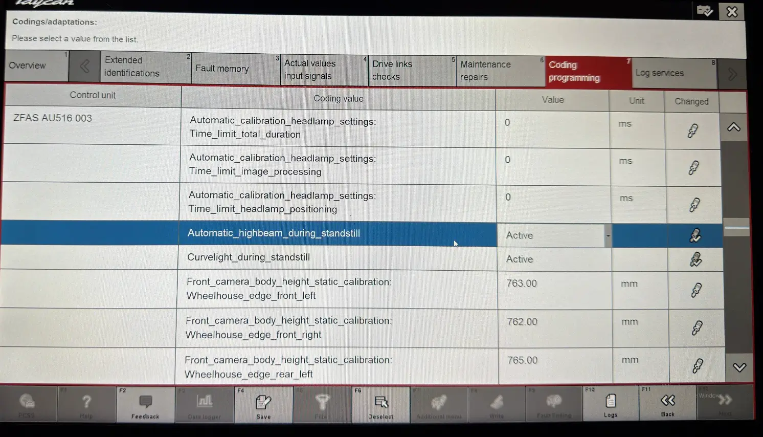

1) Did you manage to get the 'Auto High Beam' to come on at lower speeds?
2) Did you manage 'Auto High Beam' to come on at standstill (even when parked)?
3) Also, any way to change the sensitivity of Auto High Beam - so that the High Beam Activation (not Auto turn on headlights when it starts to become dark) comes on faster even when their is ambient street lighting or maybe oncoming traffic.
I am not intending to blind on-comimg traffic, but currently the headlight lights take too long to switch over to high-beams and deactivate very quickly as soon as some stray light appears. Need to desensitise a bit.
I know how to configure it so that the high beams turn on when parking or unlocking the car.
But if you’re standing in front of it, it’s extremely blinding—someone might throw a rock at your windshield the next second... haha.
But I also want to know how to make the matrix headlights work more actively.
Compared with other brands like BMW, Benz, and Lexus, I’ve noticed that Porsche’s matrix headlights seem very reluctant to operate.
