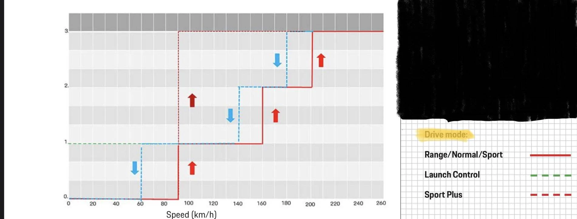

My original point was, if it does some good at a particular position in range mode, why doesn't normal mode do the same? Also same idea, if it is useful in sport mode, why not use that in other modes given certain parameters(speed, grip etc). It almost feels like marketing selected a power spoiler and the engineers could only figure out limited uses for it so didn't bother using it in normal mode, maybe use it less to keep it from breaking? lol

Is this the height at the highest stage? (stage 3)? I drive in Sport Plus all the time and my understanding is that it raises to stage 3 at 55 mph..

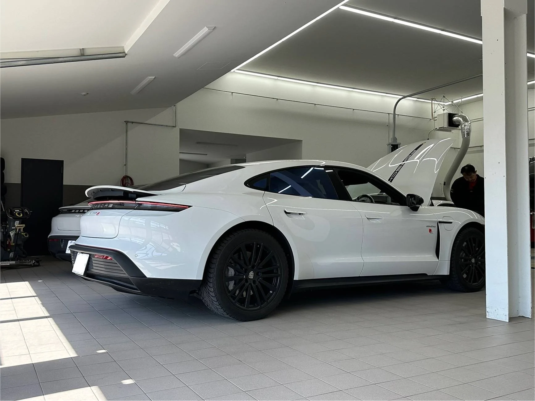

The spoiler position in the state shown in the image above will raise the spoiler when coded with PIWIS4. Once coding is complete and normal driving begins, it will reset and the spoiler will close. It's a shame that it can't be held in place.

It raises in all modes and is speed dependent as it is drive mode dependent.
