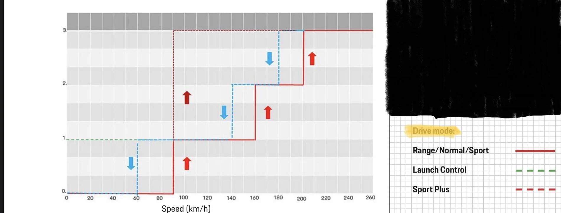

The spoiler position in the state shown in the image above will raise the spoiler when coded with PIWIS4. Once coding is complete and normal driving begins, it will reset and the spoiler will close. It's a shame that it can't be held in place.
That is the maintenance position, and it would be an absolute shame if it did stay in that position. It does not look appealing when going ZERO mph (or kmh). It exposes the plastic that covers the mounting bolts for the spoiler, as well as the bolts for the center tail light. With the spoiler in that position, it's possible you could return to a car without a spoiler and tail lights.

Correct. Not cleaning mode, it is the maintenance position. It raises the spoiler high enough so you can remove the plastic trim underneath to expose the spoiler bolts so you can remove the spoiler. Makes for changing out your tail lights much, much easier. Also, really helpful for PPF installers to remove the spoiler.

It raises only in sport and sport+ after certain speed brackets, as posted above.
In custom/user mode it doesn't raise even at 260km/h. Also neither does it raise in normal. Tested it myself on autobahn.
Never used range mode, so wouldn't know.
It's a pity it doesn't raise in custom/user mode, as that's what I use 99% of the time...

The spoiler raises in all modes, even in normal mode. There’s another thread that has the graphic for which stage is deployed depending on speed and drive mode.
How did you confirm the spoiler did not raise on the autobahn in normal drive mode? Do you have a picture of your spoiler when going 100+?
Spoiler alert…..the spoiler position is not indicated on the dash when in normal drive mode.
Why would the spoiler not be indicated in the dash only for normal, when it is indicated in the dash for all other modes?
To me it sounds like it doesn’t actually go up in normal :)
It makes 0 sense from a coding perspective to show spoiler status in dash for all modes beside 1, if it is actually working in all modes.
Are you both oblivious to how your car operates?
@chun , take a moment and think from an everyday driver's perspective, who aren't, you guessed it, thinking about things from a coding perspective. For normal, every day driving, why does the car need to tell you everything that's it is doing? Just do it. Less time looking in the dash, more time with your eyes on the road. I'm glad Porsche didn't ship their cars with the PCM in debug mode. I don't need the car to tell me every little thing it is doing---like Tesla. If the car is going to precondition the battery to "x" temp, just do it.
@RingoDingo , only Porsche knows the WHY. Unfortunately, I have never been on the autobahn. But I'll call your autobahn, and raise you a measly 65mph zone U.S interstate highway. I have not only seen my spoiler deployed while driving behind it, but other Taycan sedans as well.
What seems weird is you need a dash indicator to know when the spoiler is deployed. C'mon.....you've had your car for how long now and still questioning how active aero operates? ?

Sir, I just shared with you a post of a forum member wondering something similar and saw his own car with the spoiler deployed in normal mode.
I'm not saying it's not impossible, at least for a Taycan that hasn't had the spoiler ECU params modified. I'm going to go out on a limb here that, PIWIS modified Taycans wouldn't fall into the category of "lots." Are you saying the spoiler acts differently for some Taycans in normal mode i.e mine vs. yours? Or possibly, your eyes are mistaken? Although, stage 1 is very subtle in normal mode it does deploy...sans icon on dash.
It would be much more satisfying for the both of us to find out you are incorrect on your own accord. You just might find out some other things about your car that you had assumed incorrectly.
https://www.taycanforum.com/forum/attachments/pag_taycan_technology_pm_en-pdf-pdf.51306/
PAGE 21 (just in case your eyes are fooling you again).
