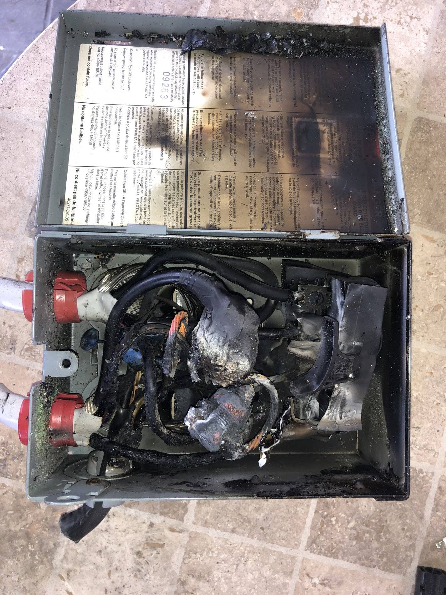

Porsche Taycan 220v charging plug at home 1592543973283
this is what can happen when you pull 40 amps over wire rated for only 30 amps - I recomend against it - and the only thing that kept the fire under control was the overheat/fire occured inside a rated electrical box (building code) designed to stop just this type of failure from snowballing into a full blown fire.
don’t rely on turning “down” the amps on the porsche charger as a way of keeping the wires/breaker from overheating - if everything is properly installed and balanced, the wires/breakers won’t overheat and you don’t have to remember to do anything.
