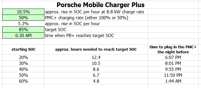

...Rather than tinker with timers, I built a little Excel sheet to help roughly estimate when to plug in my PMC+:
My off-peak electricity rate starts at 7 PM and ends at 3 PM the next day. So, if I'm at 40% SOC I can plug in at 10 PM, and my PB+ will be charged to 85% SOC at ~6:30 AM the next morning.
After a while, I said just forget all this and start charging shortly after 7:00 PM when the SOC is between 30% and 40%. The built-in profile will stop charging at 85% anyway.
