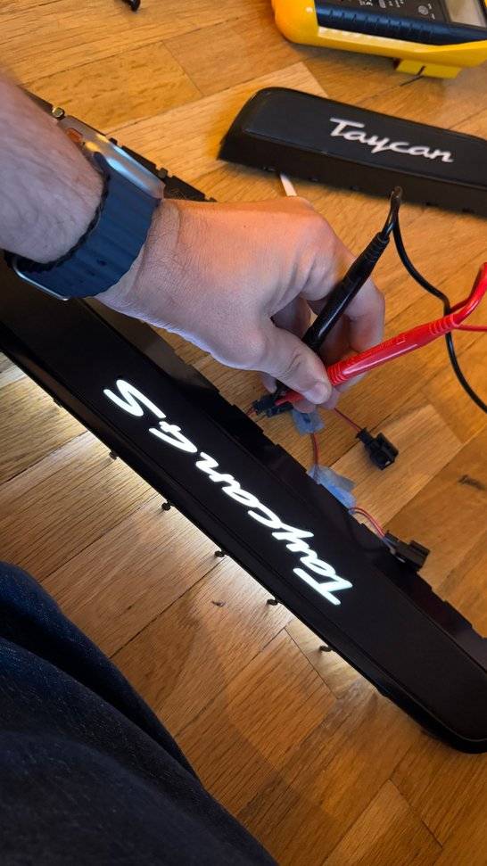

First, once I got them, I checked if they are working just fine and yey, they are :)

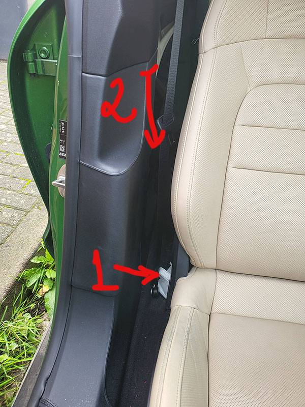

Now, the fun begins with removing the lower piece of the B trim. You pull the lower end inwards toward the seat and then the whole thing down. Here's an an amazing illustration made by me :cool:
Porsche Taycan Illuminated Door Sills Installation / Retrofit DIY step1
Next, you need to remove the back seat. You pull the front up. Don't worry you can't break anything. Pull the front, lift it, needle through the third seat belt and do not unplug any connectors. Just move it away a bit from the side you're working.

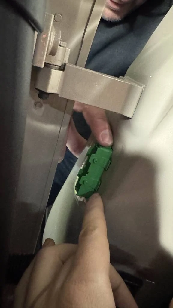

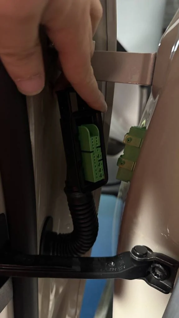

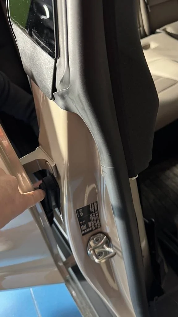

Open the door and remove it from the outside. You need to pull the lock up and then outwards.
Porsche Taycan Illuminated Door Sills Installation / Retrofit DIY IMG_0005
Porsche Taycan Illuminated Door Sills Installation / Retrofit DIY IMG_0009

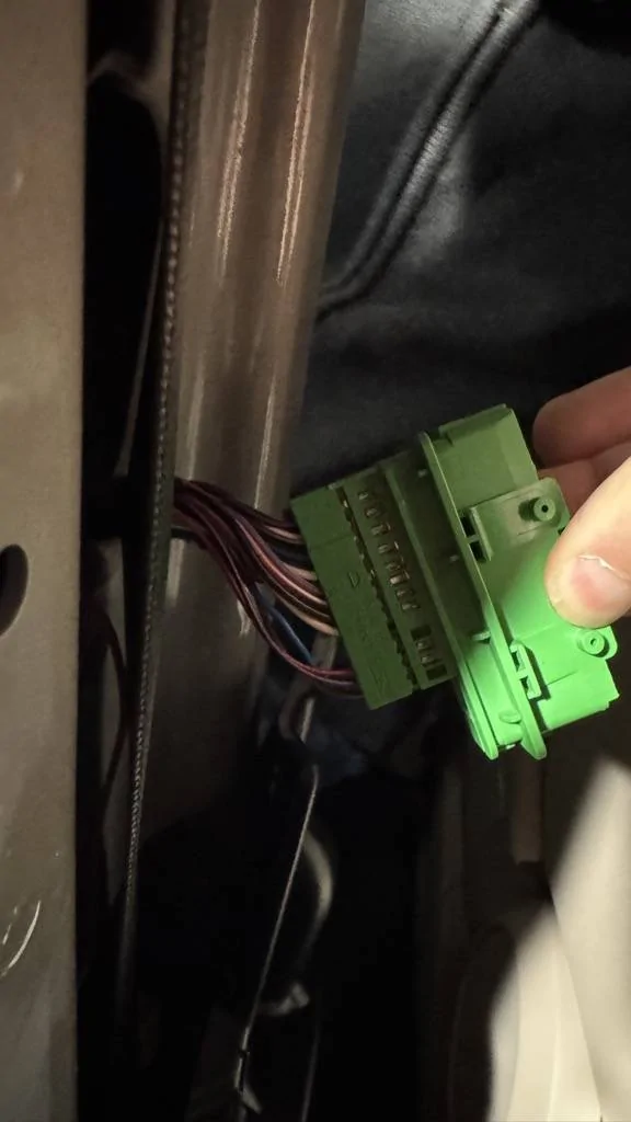

Once you unplug the connector, push the other end inside the pillar. Use your fingers to press both ends to unlock and then inwards.
Porsche Taycan Illuminated Door Sills Installation / Retrofit DIY IMG_0010

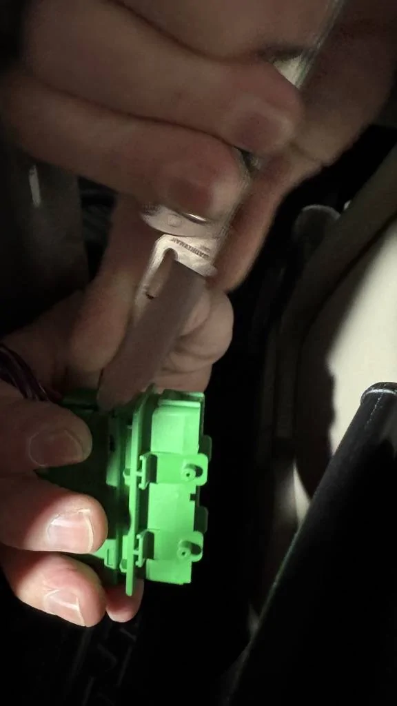

Now from inside the vehicle, slide the piece of the connector that protects the pin. It's difficult to explain. Unclip it and slide it. Just take a look at it for few minutes and don't break it.
Porsche Taycan Illuminated Door Sills Installation / Retrofit DIY IMG_0014
Porsche Taycan Illuminated Door Sills Installation / Retrofit DIY IMG_0015
Once you gain access to it, plug in on Pin 9. and clip it back together. Make sure you hear the clicking noise from the pin when you add it to the connector. Put everything back together and go get your remote. Close the door, lock the car, unlock the car and then open it. Sills should work just fine :) The sills should illuminate when you open the door and fade out when you close it.

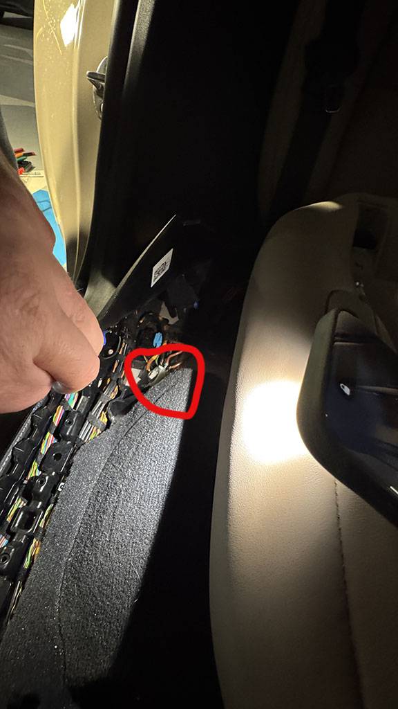

First of all, thank you very much for the great instructions. I was able to get the back light to light up without any problems, but pin 2 on my front connector is occupied by a blue wire. I mean the connector shown in the diagram in the manual. Or is the correct one not shown in the diagram at all? Does anyone have any advice?

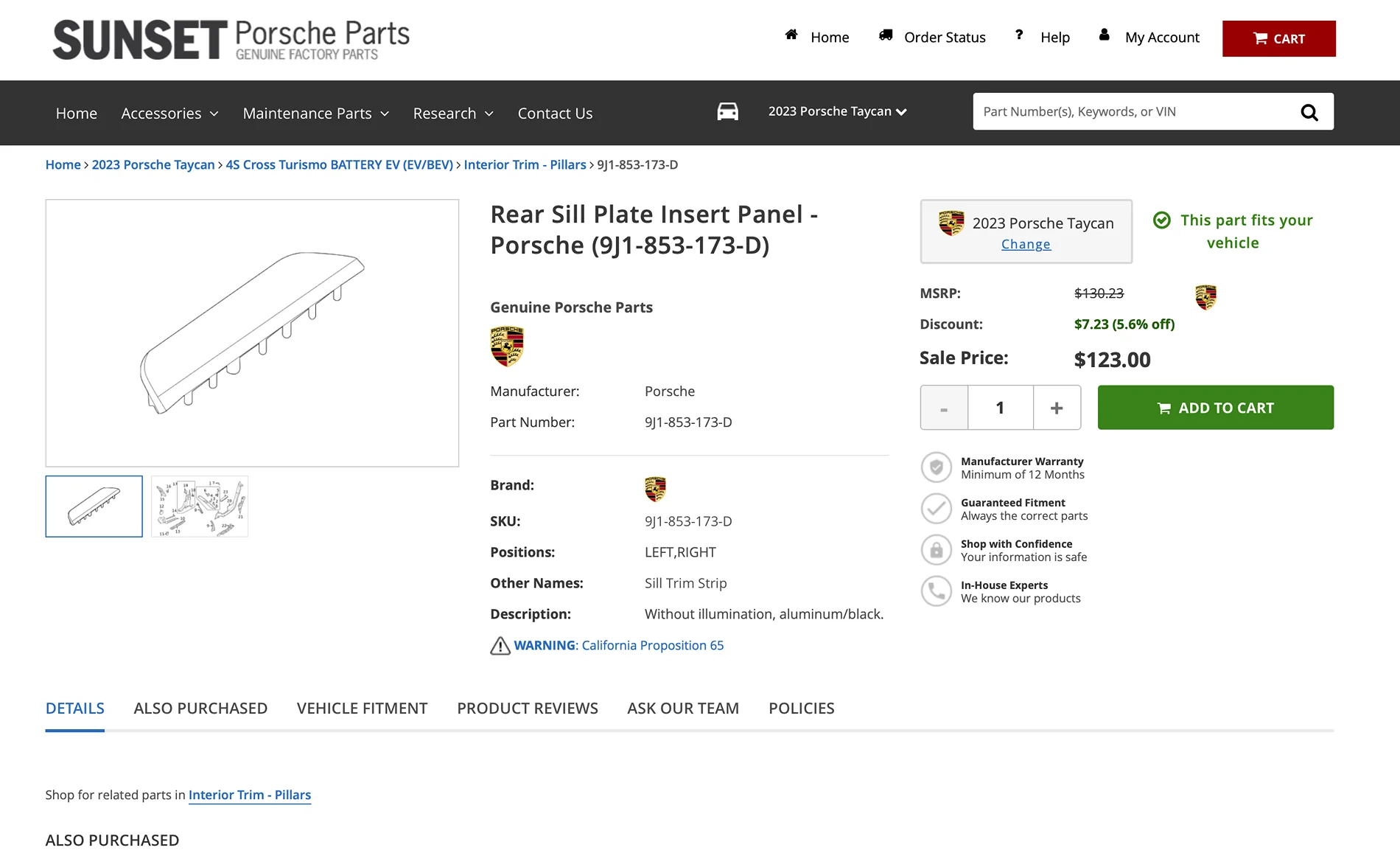

I used the Suncoast kit which had the wire harness. It just uses the rear ground and has pins for both doors. I couldn't find a good guide on getting to the front harness, so for now I just tapped into the footwell lights. It means they don't fade out individually, but they still come on when you open the door. If I locate the full instructions I'll go back and redo it to stock.

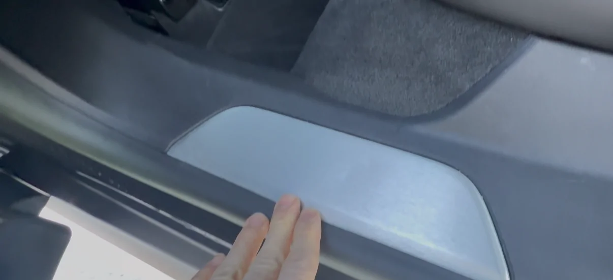

Hi!
I'd love to know what you ended up doing.
My back sills are dented and would like to replace them for new ones, but only if it is a quick swap.
Do you know if it is easy to do? Just pop them out and replace or do I need to remove all of those back pieces in the B trim and so on?
Thanks

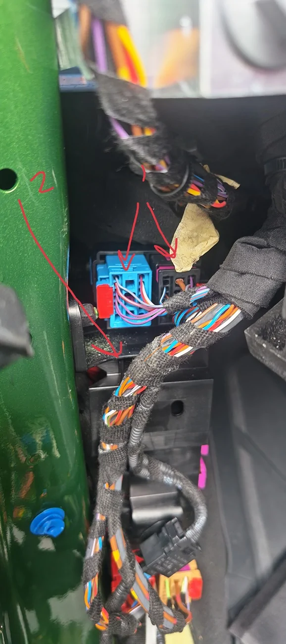

I was wondering if anyone has figured out a method to access the front connector. Did back last night and that was pretty straight foward. cryingfreeman86 said pin 2 on his connector was occupied, perhaps he or someone else can let us know how they got to that connector. Is removing the glove box possibly a way to get access.?

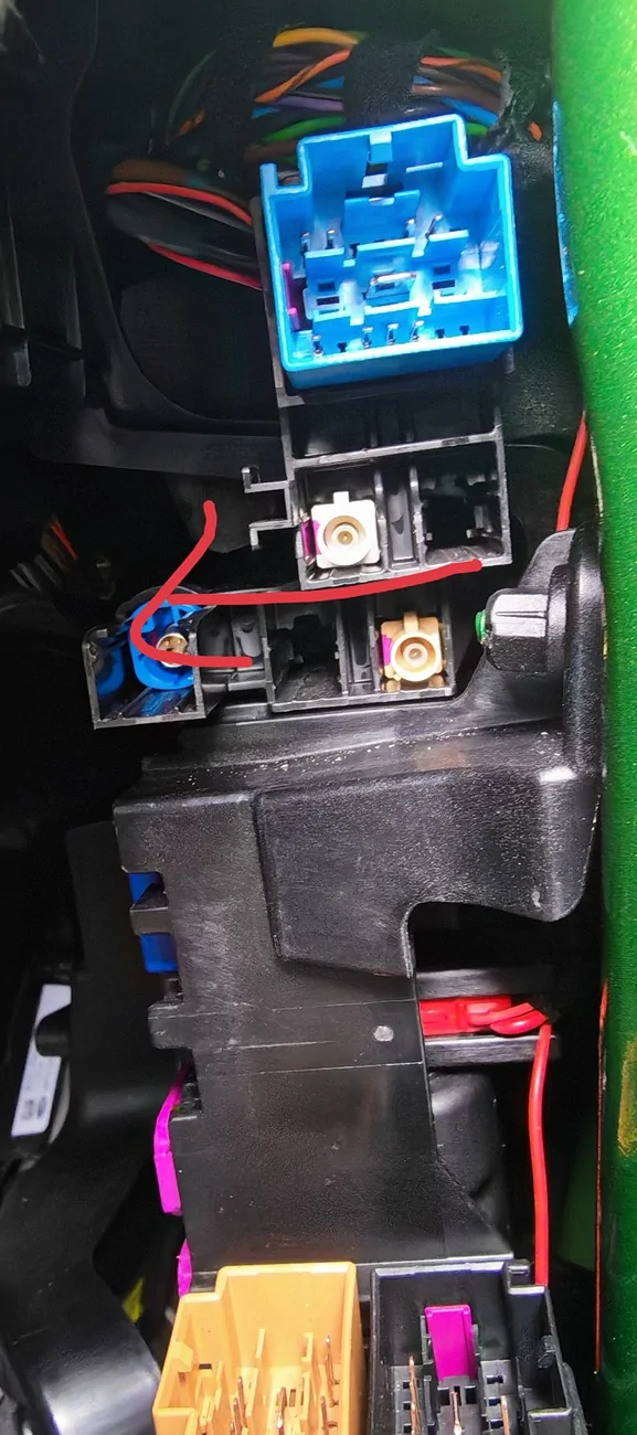

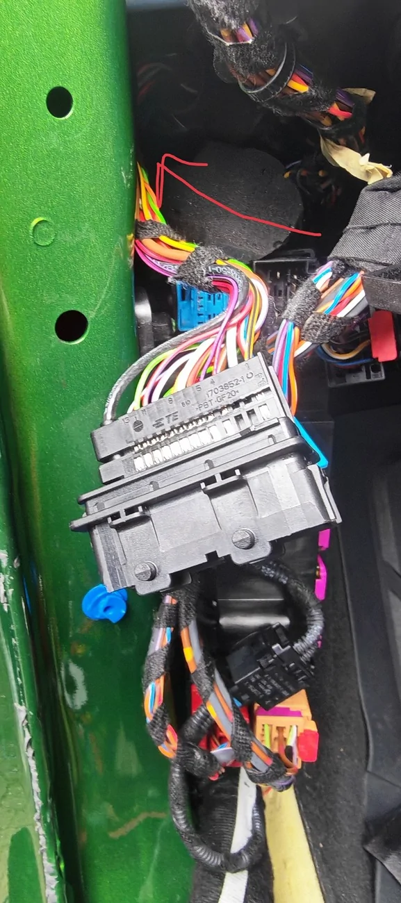

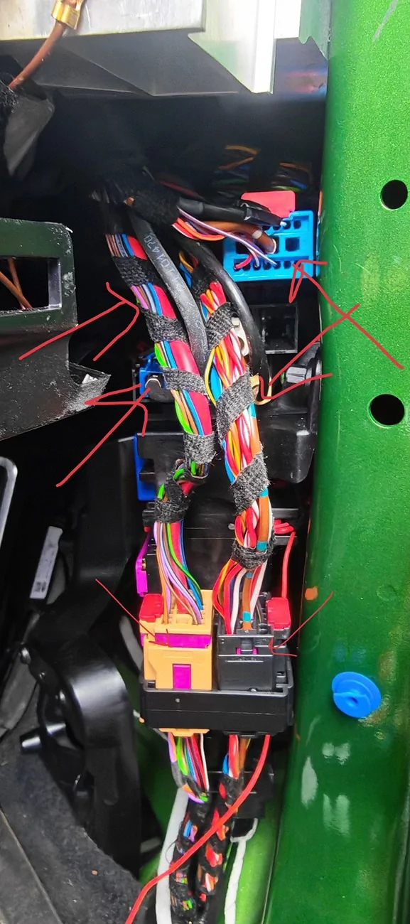

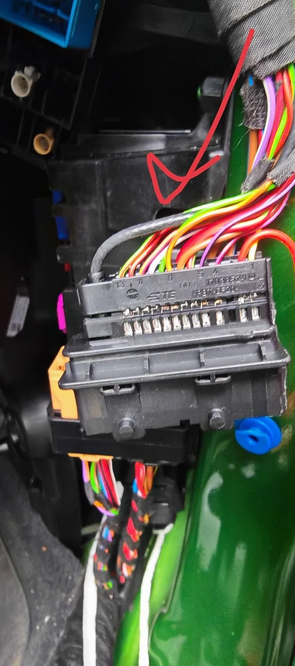

I did the front and backs today, so big thank you for the guide it made doing the back easy... the front was harder but do able, front passenger was the easiest out of the two front.
Let me see if I can post a few pic... first time so please be nice.

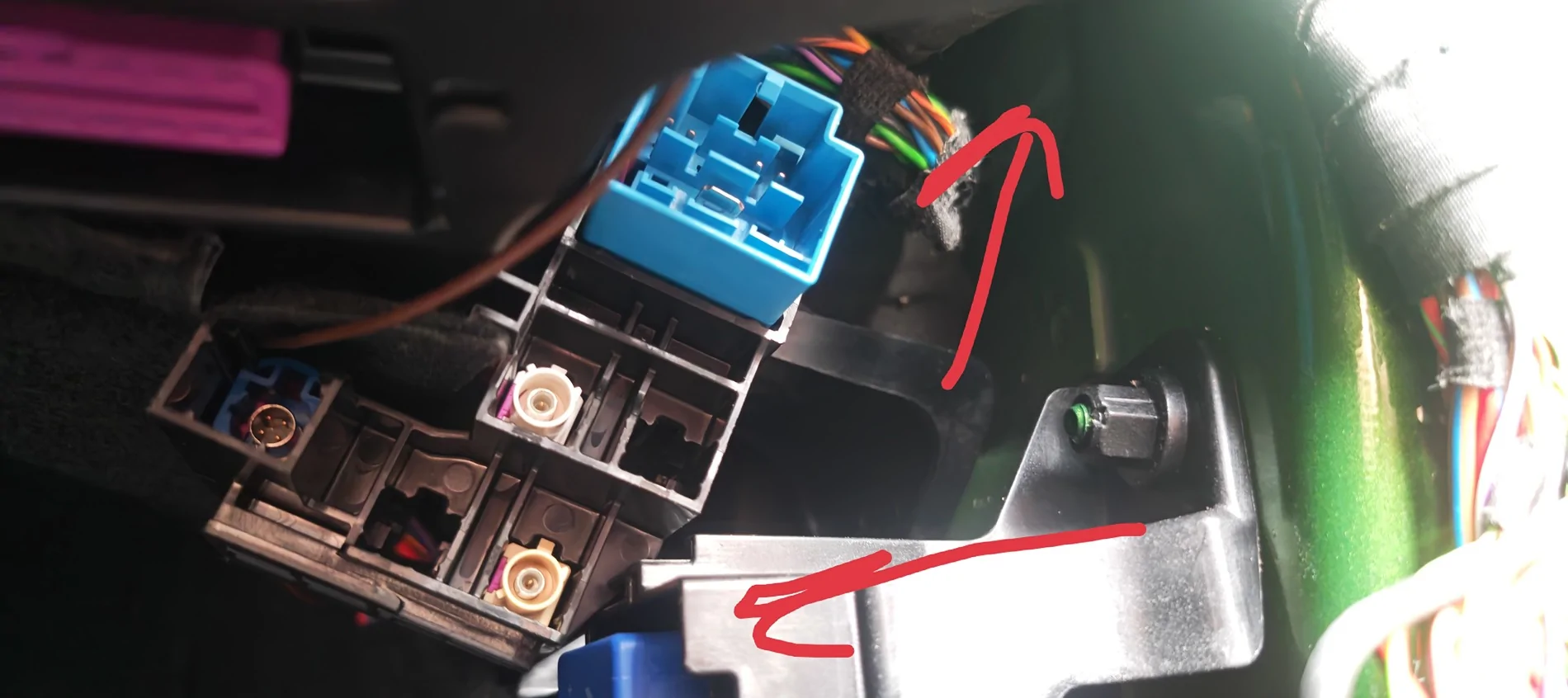

So for me to fit my hand up and behind the fuse box I need to remove these two connectors, once done I was able to disconnect the front door connector and pull them though to the cabin do I could insert my cable into PIN 2.

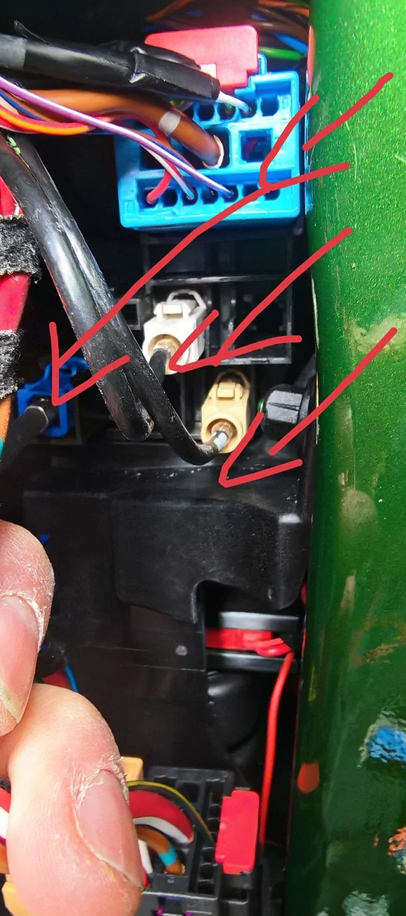

Driver side was harder you need to disconnect 6 cable/connectors and the top of the fuse box slides left (uk spec) which after digging through the soft foam it should give you access to the back of the door connector block... but this took me 20min being careful on pulling the connector in to the cab, connect PIN 2 and put everything back... to do all four took me most of the day :( But very happy with the results, got mine off ebay carbon versions.
