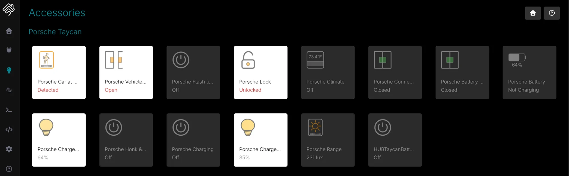

Title says it all. Someone has kindly written a plugin. See here.
https://github.com/SchwabJ/homebridge-porsche#readme
Nothing to do with me, but very nice if you use this kind of thing. There is an issue with initial setup, but there's a simple workaround (paste in the example config to your own config to make setup realise it is complete after the first Homebridge restart).

For anyone wondering, this is working great for me so far. Here's my main use case... If the SoC in the Taycan gets below 25%, I have some light switches in the house that change their LED color and pattern so there is a visual indicator to plug the car in. It helps me and my wife remember to plug the car in before we turn in for the night.

In short, home automation. I can have notifications fire to warn me about battery levels at times of day, turn drive lights on when the Porsche arrives home, have preheating start when I press a specific Hue switch button one certain days at certain times.
