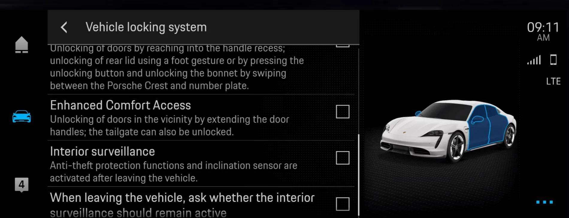

I have to turn off Interior Surveillance every time I leave the car. According to my Porsche Dealer, the car has a faulty ultrasound sensor, which causes the alarm to go off really often. I have booked an appointment for them to fix it, first available time was unfortunately was at the 24th of September.
Is this specific to your car or a wider issue with the ultrasound?
You can toggle this on / off within the PCM to avoid being prompted each time.
I’ve tried doing that, but the interior alarm kept going off, so it was easier to leave it on.
Yes, been there done that, then thinking it is off, but then single click locking the car still set off the interiour alarm. Have to double click leaving the car, watch the red blinking light go completely out before I leave.
