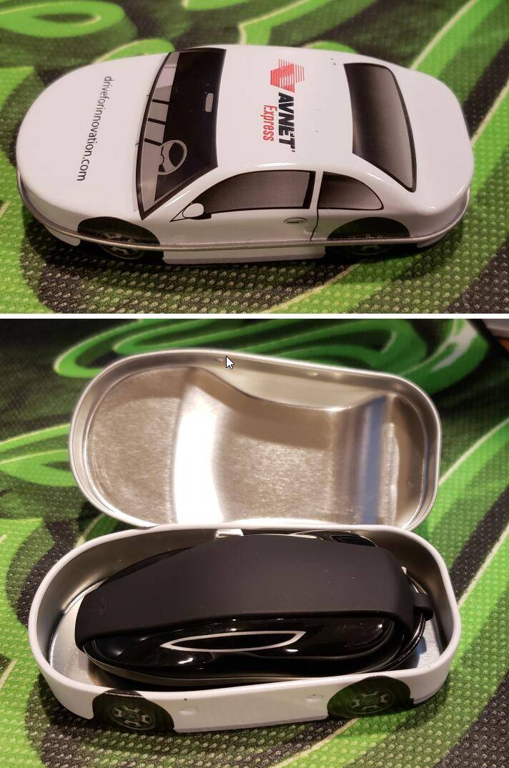

Put the keys in a Faraday cage (metal can, or bag) and see if that stops the issue?
90
8,471
7,465
Will try to do it tomorrow, if not on Monday!
Remember to do it with both keys, as the spare might be in your house also within range.
As a side note, I reused an old breath mint can to keep my spare car key in, so it doesn't keep in communicating with the car (I keep the spare in a room right above the garage where the car is parked). It is also useful if I ever want to lock the car with the key inside for any reason. It was a promotional giveaway at some conference I went to, sadly only got one, so the spare for the 2nd car in the garage I just keep without a battery in it.
