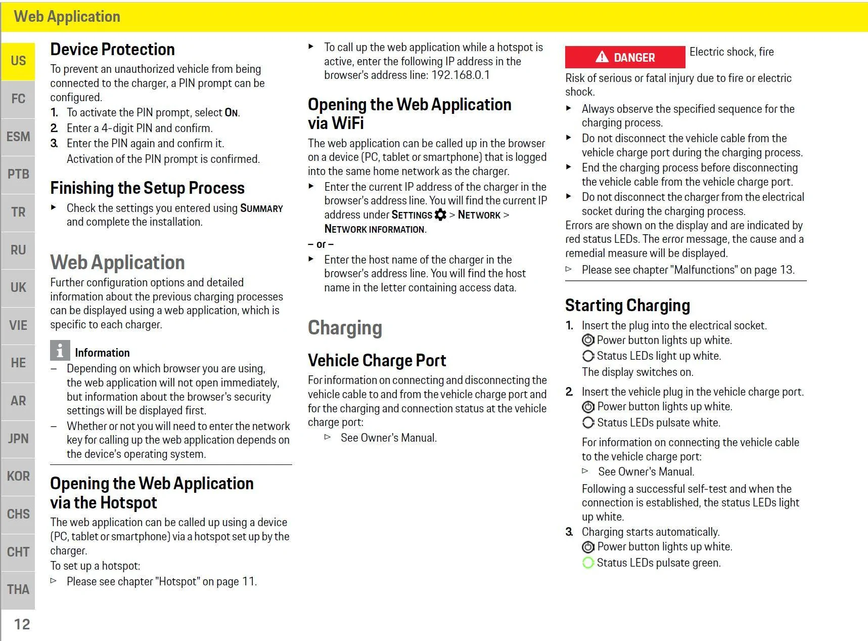

How do I access the online website for PMCC just like you did?

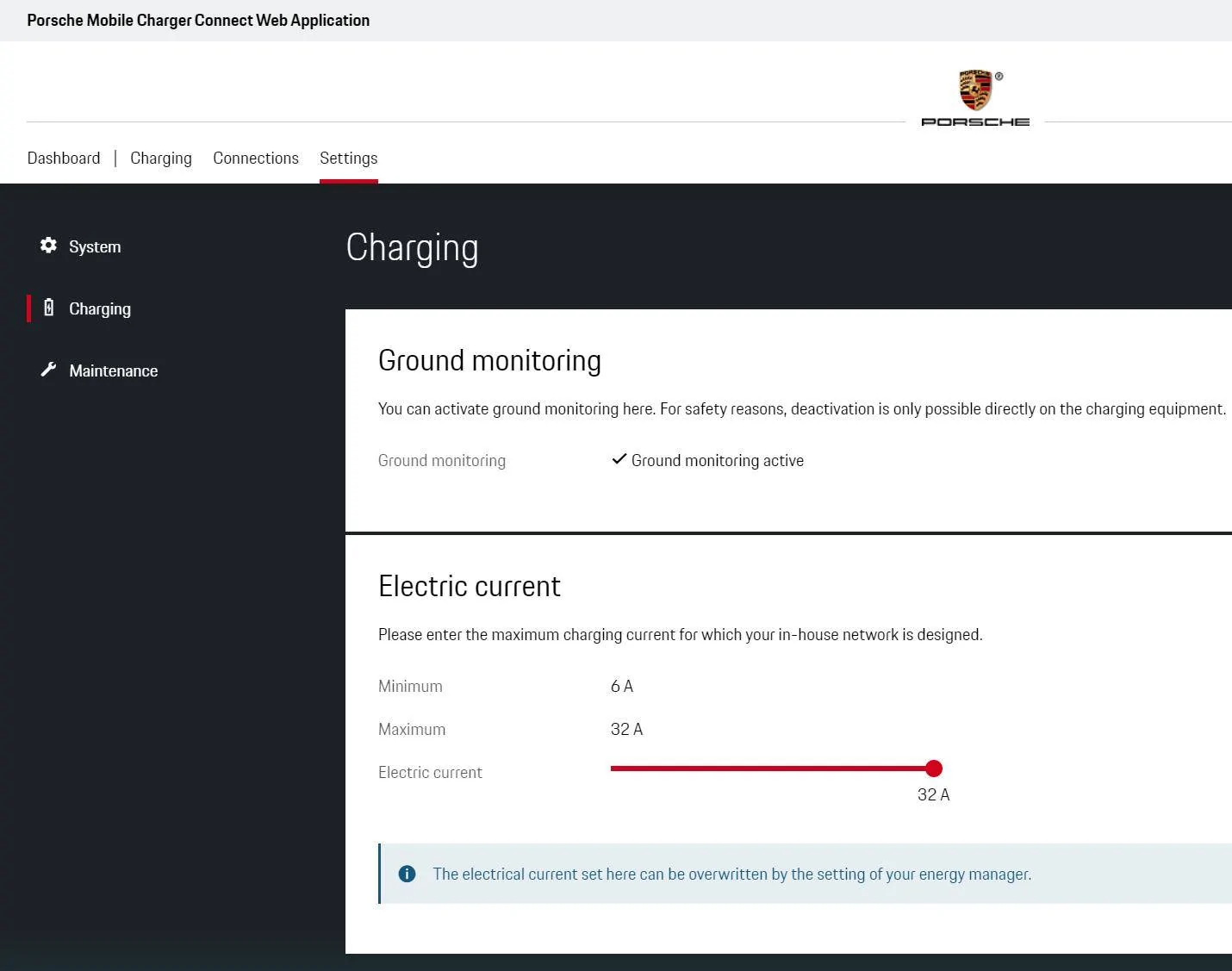

Have you used the Porsche Mobile Charger Connect Web App to access the charging options where the amps can be adjusted?
Look for the PMCC on your network - 192.168.x.x and log on to it. You'll need the white envelope with the passwords etc.
You may have to accept an insecure certificate when connecting (all good).
Also you can enable the hotspot and connect that way.
That worked - Thanks.

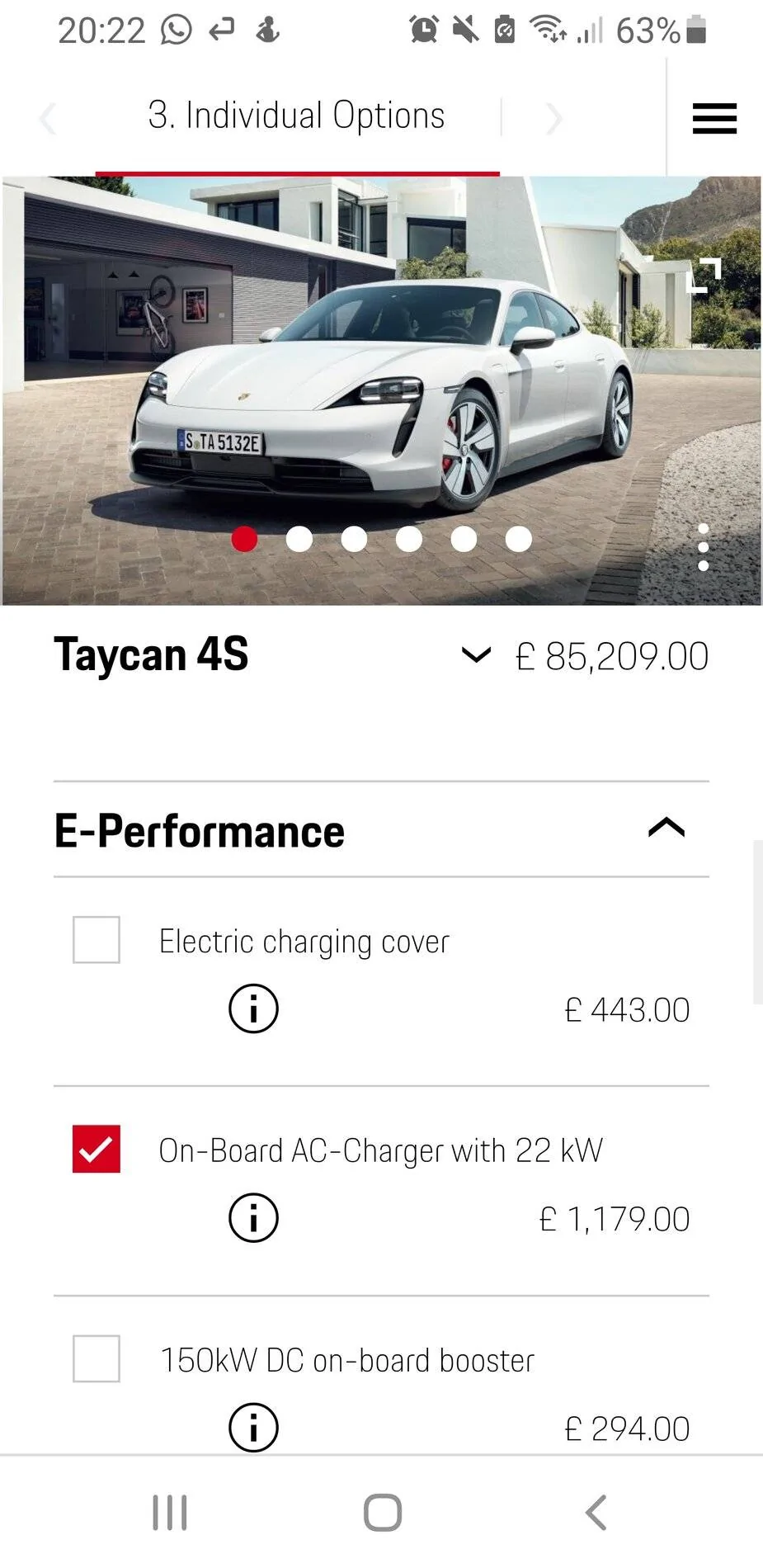

I feel so stupid, but I have to ask: What option at the car configurator should the 22kw option be listed as?
No such thing as being stupid.
It may be a standard fit in Sweden and therefore not listed under the E-Performance options. In the configurator scroll to the bottom and look for the standard specification button and then review that

I have that option on the picture that you added, but can’t see anything that the car is compatible with 22kw charging. Thanks a lot for your help! Do you reckon I should call my dealer?
If the 22kW option is available to you then select it and that will ensure you get the maximum possible AC charging for the car and also takes advantage of your 3 phase home supply. This coupled with your PMCC is the dream home AC solution.
If you are still unsure then reach out to your dealer but it's pretty straightforward.
UK standard spec cars have the 11kW onboard AC charger as most people don't have 3 phase supply (expensive to install). However for those who have then they can upgrade the car to 22kW for a King's ransom.
The car is compatible with all AC charging regardless of the supply so no worries on that front. Ideally you always want to use DC chargers for higher speed charging when out on the road.
