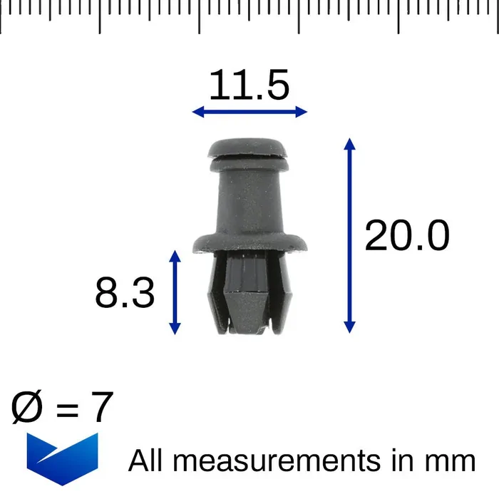

If you decide to get the VAG part and it fits, please leave feedback. They are like 60 cents, so probably doesn't hurt to try it at least. From pictures it looks extremely similar in size, but could easily be that it's too loose, or that the plastic hook doesn't fit over it...
Here's a photo with some measurements:
Porsche Taycan Absurd Parts Prices 1768588486577-82
No idea if correct.

I ordered that part number from Amazon. I will get back

Ok, if that doesn't work, then here's a site of what I mean by universal fit fasteners:
https://vehicleclips.co.uk/collections/fastener-types
I just found a "screw type" which was super tight, so what I did was use a rubber mallet to hammer it in just enough where it was solid, but the head was sticking out enough to fit the hook over it.
Was easy with a parts store because they just let me test fit a bunch of them in a parking lot, and I just got the one that was closest.
P.S. I wouldn't change the trim over that. Never mind that it's a stupid price, you also have to disassemble and re-assemble the whole thing which takes way too much time for something so small.

Ok - I took from your earlier parts reference that I can just replace the stud.
prj
Jan 14, 2025
1,804
2,414
Estonia
www.mapev.net
Taycan CT 4 - 2026
No that is not a Porsche part, it is a VAG part from an Audi A3 that may or may not fit.
It doesn't even look the same. The part does not exist separately in the Porsche catalogue.
