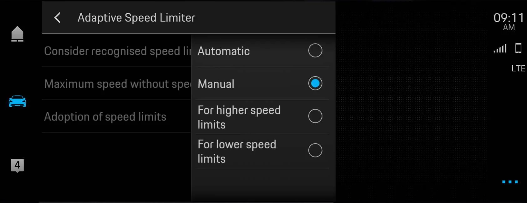

How to enable a feature that ACC will limit the speed depending on traffic signs?
When I use ACC and put 120 km/h it doesn't make any limitation of car speed regardless of the recognized speed limit signs.
At the road sector with 80km/h, I am still rushing with 120km/h. Looks not so futuristic at all ^^
CT4 [MY22] with ACC and Active Lane Keep.

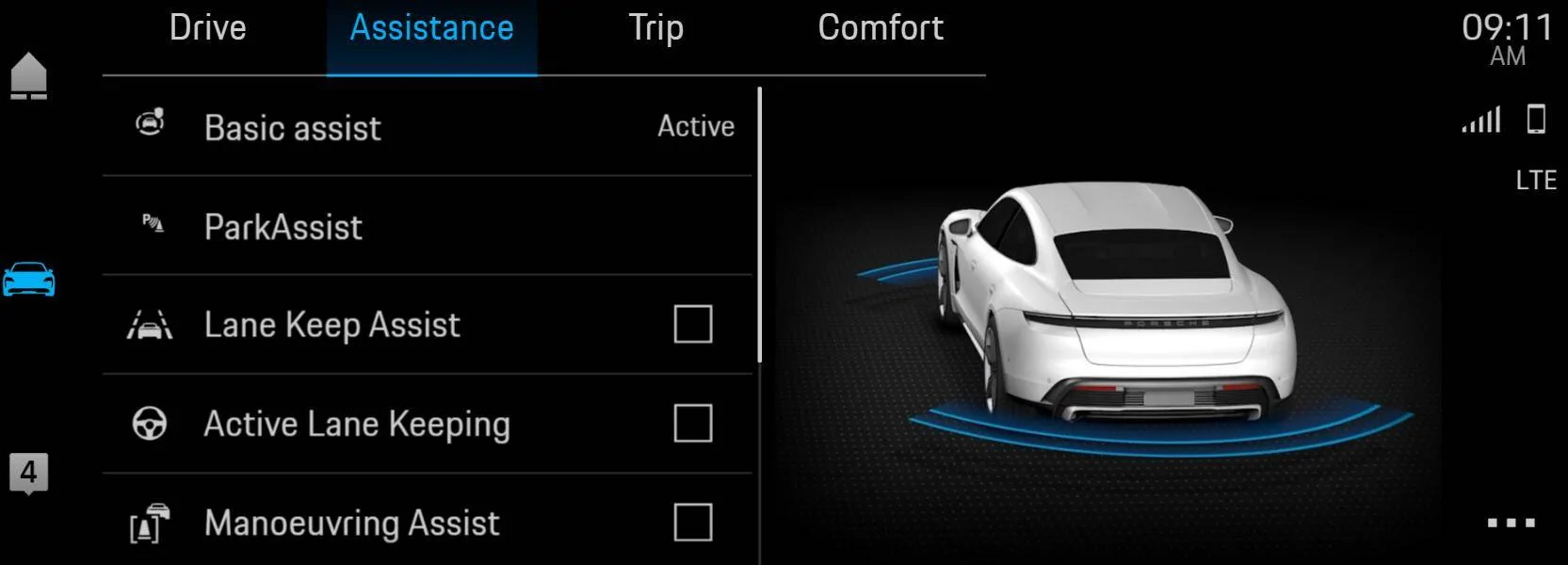

Porsche Taycan Adaptive Cruise Control + Sign Recognition? 1644238374577

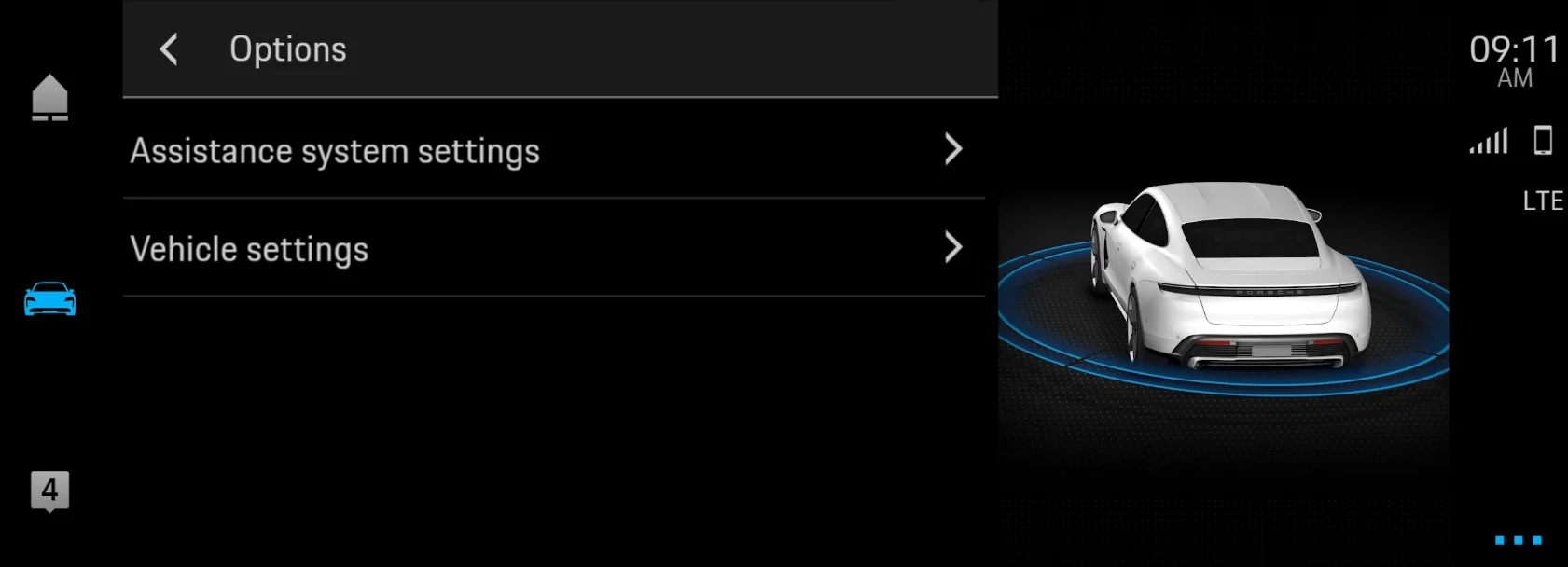

Select '...'
Porsche Taycan Adaptive Cruise Control + Sign Recognition? 1644238419433

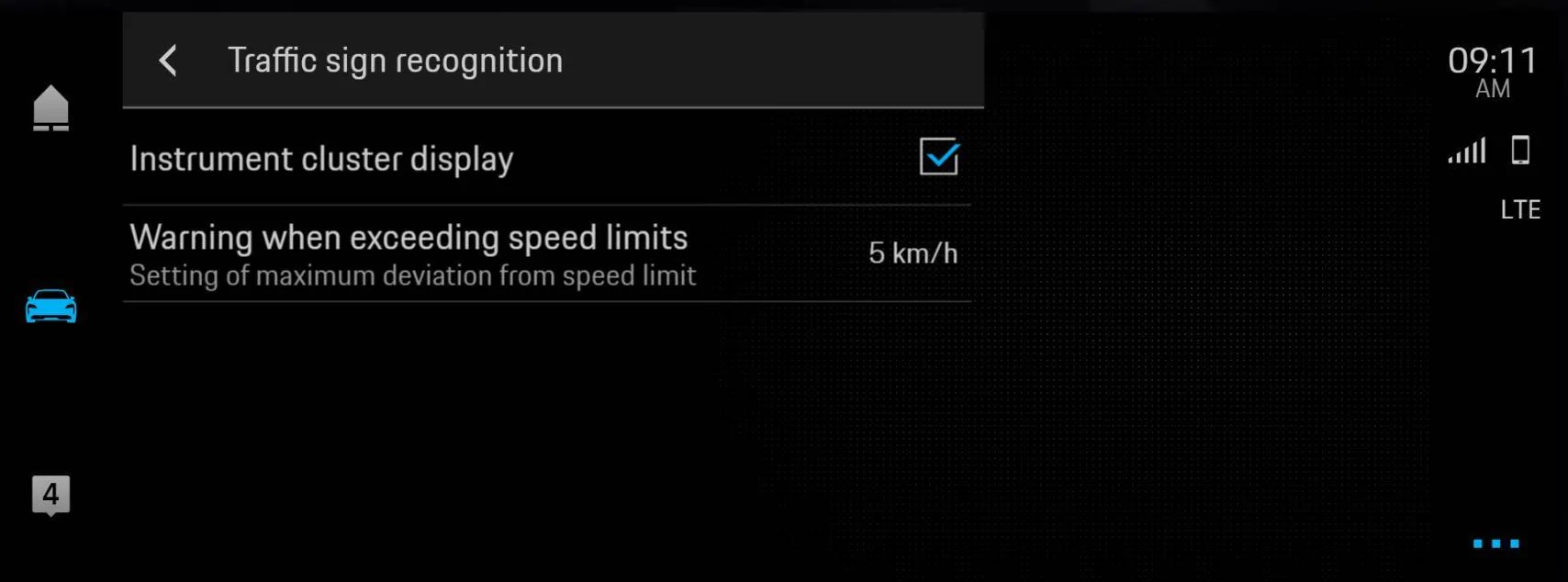

To display traffic signs in general:
Porsche Taycan Adaptive Cruise Control + Sign Recognition? 1644238053673
To enable recognised speed limits (can lead to false readings, sudden braking so be wary):
Porsche Taycan Adaptive Cruise Control + Sign Recognition? 1644238166067

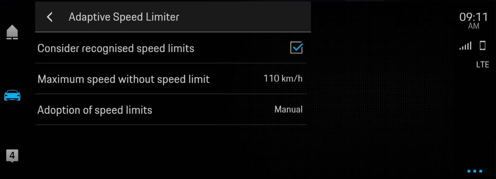

and then fine tune 'Adoption of speed limits':
Porsche Taycan Adaptive Cruise Control + Sign Recognition? 1644238225932

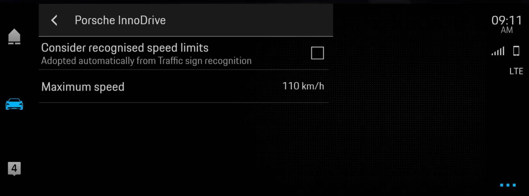

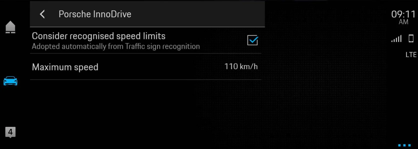

If InnoDrive fitted:
Porsche Taycan Adaptive Cruise Control + Sign Recognition? 1644238114800
Porsche Taycan Adaptive Cruise Control + Sign Recognition? 1644238085821

I have that feature turned off, it would sometimes slow the car in error.

Team -- can ACC still be used if the Innodrive is turned off?
atebit
Bob
May 1, 2021
471
324
PA
Yes, you can select the mode using the “S”witch on the cruise control stalk.
Agree with @kort that it needs some work. For example there’s a stretch of 55 MPH highway near me that passes overhead of a 35 MPH surface street. Consistently when I dive that highway, Innodrive will begin slowing down over that section. Not good.
If you happen to be looking at the dash it does give you advice that it’s about to make a speed, change which you can then override, but that oughta be the exception, not the norm.

I can't have innodrive on with a "manual" deviation from the legal speed limit on the road sign (e.g. going 125 km/h instead of 120), right?
TycanNewHampshire
TG
Apr 26, 2021
346
270
New England, USA
Tycan 4S
with innodrive, when the speed limit changes and I have on the n assist screen selected on the left of the three on the cluster panel, I get a prompted question if I want to match the speed limit that I can acknowledge and select, or ignore.
For example, if the speed limit is 65 (and of course I have it set to 65mph :like:) and the speed limit drops to 55mph, it will ask if I want to match this speed limit sign.
Not sure if that helps, but I thought that was a useful feature, but I only have seen this when I have the assistance system selected on the dashboard screen. Perhaps have that screen selected and see if this gives you additional options to work with?
