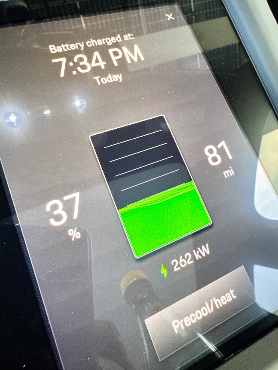

It may be that the EA stations I go to in OC are always full with a wait so I just assume that’s why I never get above 200kwh with my Taycan. The Mercedes EOS from Avis did charge above 200KwH in Dallas.
I’ve never seen any charge rate above 200KwH but was hoping to see at least 250-300 KwH when charging after midnight but never had any luck. Maybe it’s my 2021 charging system but if I start a 30%, 20% or even 5% with the battery temp at 95-97F or in the 80s the charging rate never gets above 200.
Unplugging after 30 minutes to get the last 10% in only works between 2am & 5am where there are a million EVs either free charging at EA in Newport Beach so it may just be my area.

interesting thoughts here - on my way back from the Bay Area to LA : the Taycan Turbo S CT pulled 258 - 260 KW consistently. I also used the PCCM trip manager, to condition the battery for ample charging.
I’ll have to try using the trip manager more often to see if that helps…

Almost certain your experience is bc of load sharing at full stations with the older cabinets. Try charging at an vacant station and you'll see 270kw with a 200kw average. The newest EA station don't load share and is blazing fast.
https://www.taycanforum.com/forum/threads/trip-report-san-francisco-to-north-lake-tahoe.23635/page-2

Thanks, I’ll try that. All the EAs I’ve been going to are at least 4 years old or older so finding a new installation is good for me to try. Thanks.
