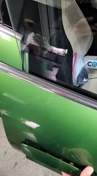

Compared to Panamera, the Taycan doors feel cheap. Hinges are not the magnetic ones, no soft close, zero sound deadening and generally rattle on high music volumes. They did not save weight. Otherwise they wouldn’t have put a 20-30kg party trick to open and close the charging port with a gesture. They just had to meet a deadline and to save few things for the facelift.
Installation is pretty simple:
And the kit is from Aliexpress around 4-500 usd. Works great.
https://a.aliexpress.com/_Exk7MKv
While there, I would put 3mm sound insolation so the door doesn’t rattle. My comments are based on a 2020 turbo s.
