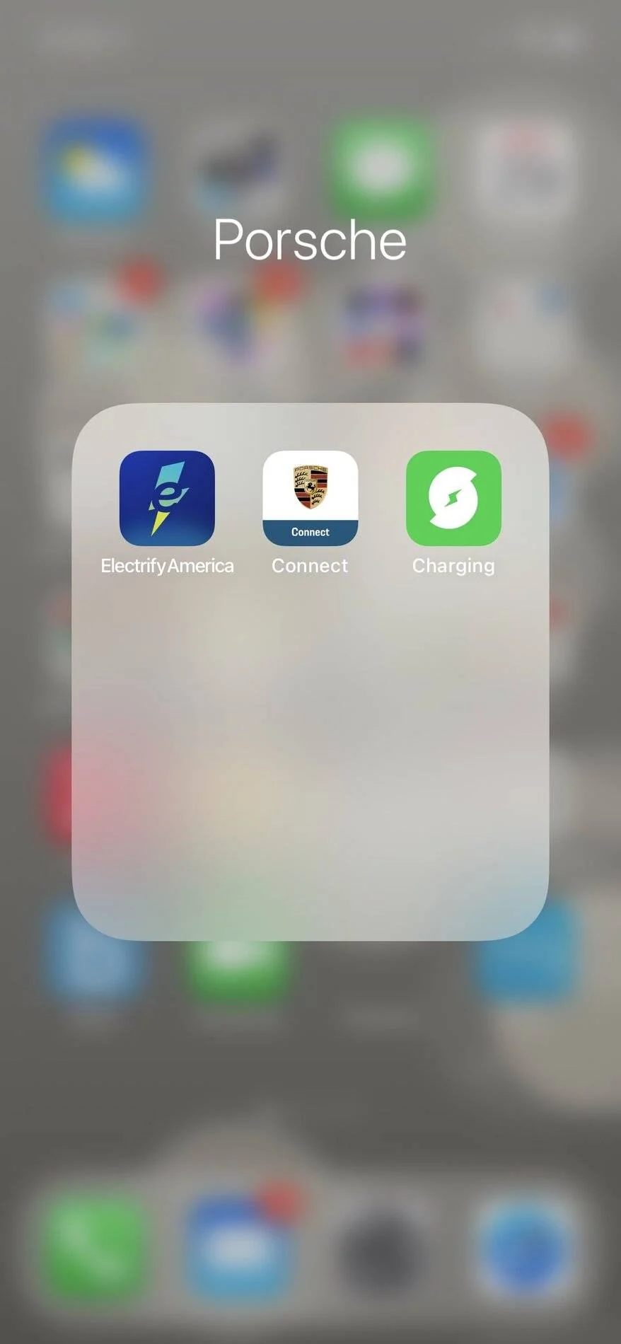

The NA app you can find in the App Store the icon on your phone will just say charging. when I opened it it took me to My Porsche app so I think its linked have not tried to use an EA charging station yet.
Porsche Taycan Alarm Issues FC3A60B7-3933-457D-967C-32846D3EFCA1

Thank I had the NA app on my phone forgot/ didn't realize they were the same things it just says charging app but it is associated with Porsche charging subscription.
