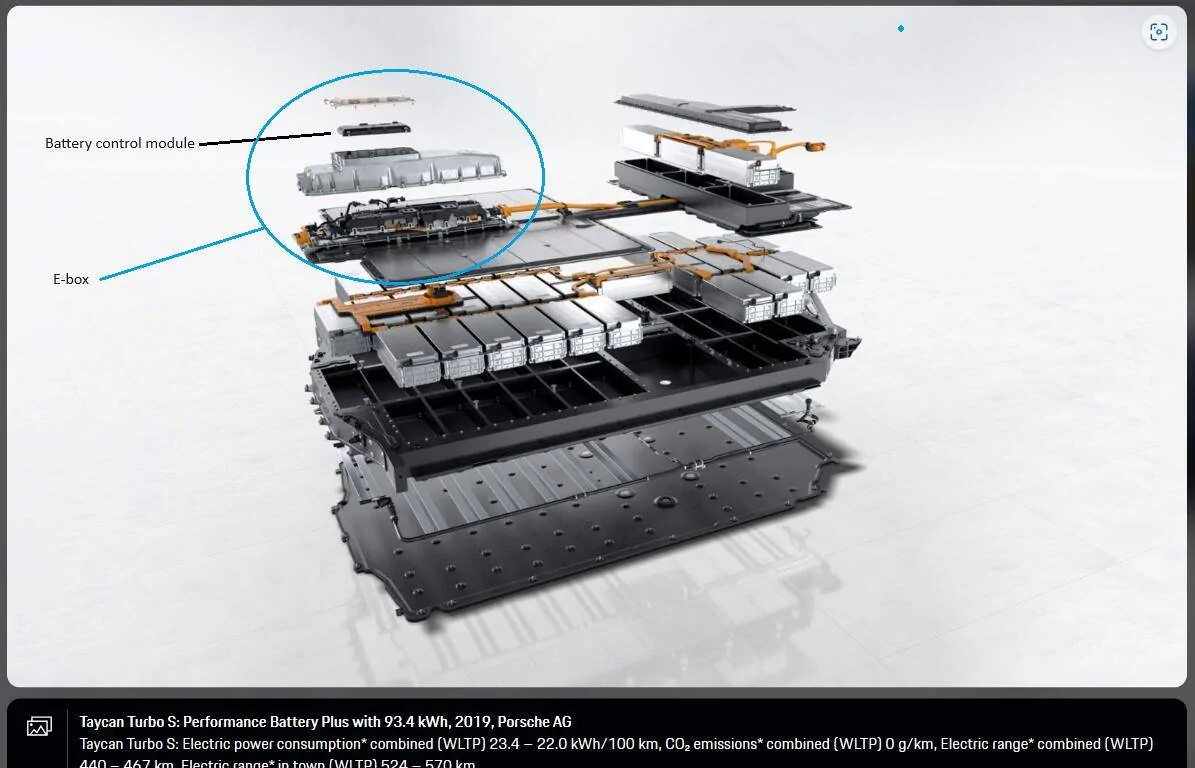

I have no information about it. The main issue here though is, that I understood it, that the Control unit on top of the battery, can only be accessed by lowering the battery. The work to open up the battery, revealing it and pressure testing it would not be needed. If I understood the info correctly it takes about 8 hours to drop the battery??? And about the same to install it? But there I am not on detailed ground . (just memory picture from a screen)
@Tooney sent me a picture of what we believe is the Control unit.
Porsche Taycan Another MY 2020 Turbo bites the dust IMG_1764
