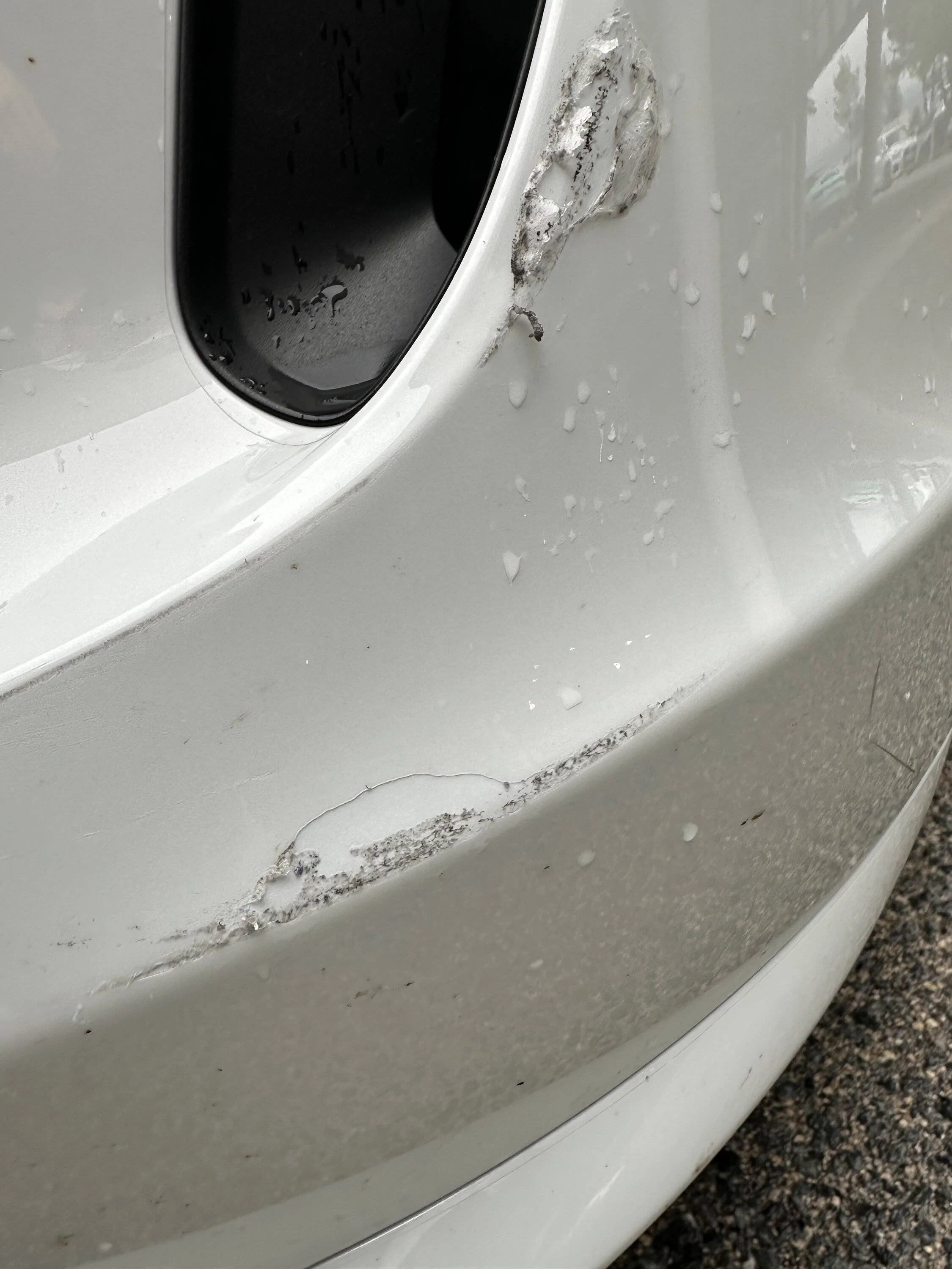

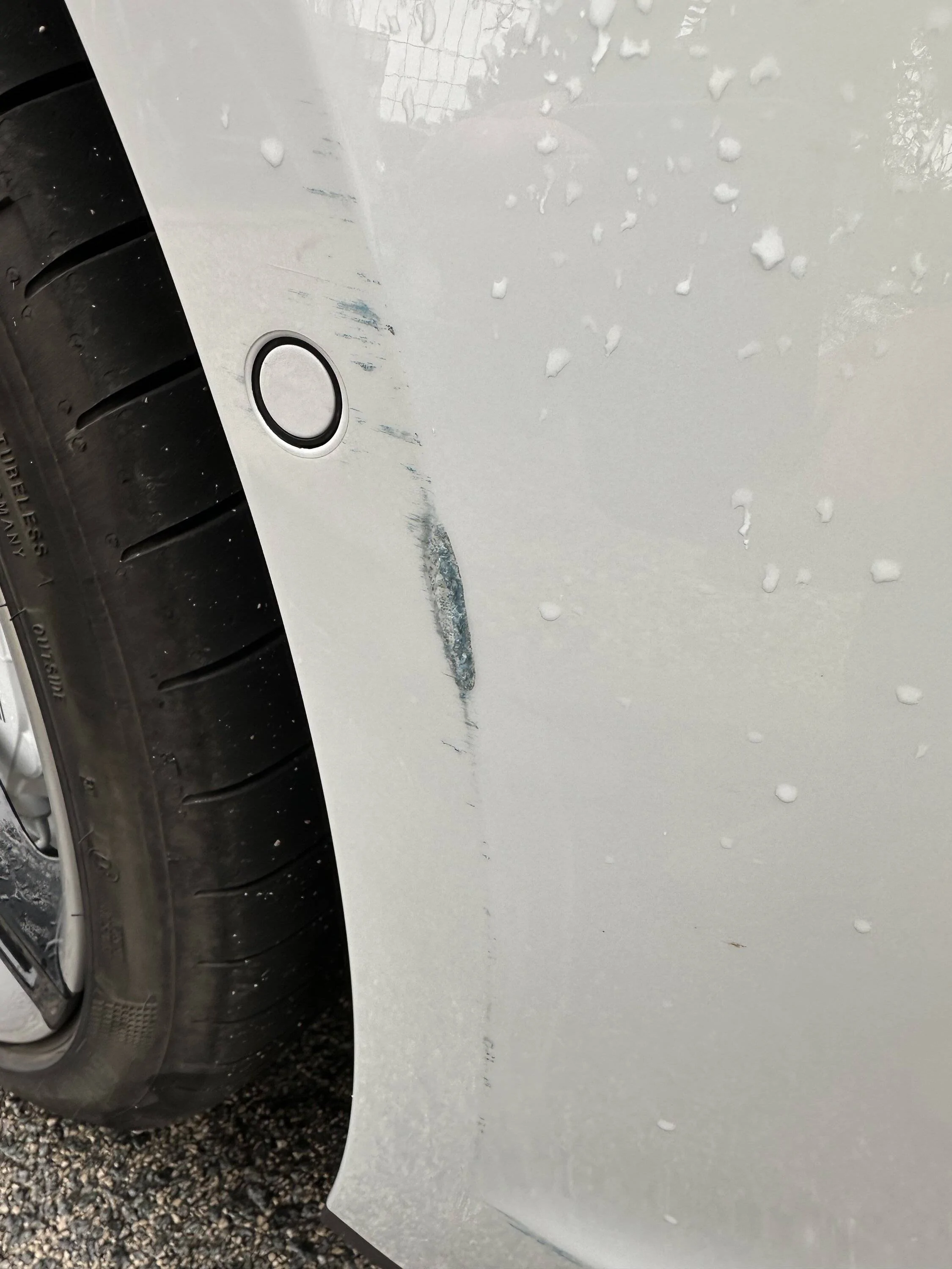

My car came back to my Porsche centre with some damage to my front unfortunately!!

Luckily enough I have full PPF film on and to my laymen eyes it looks like the PPF saved me. The damage seems only to be in the PPF and not the paint.
But now starts the fun of trying to see where this happened?
- At the first tow??
- In the first garage?
- At the second tow?
- At the second garage?
- At the final tow or reloading to France?

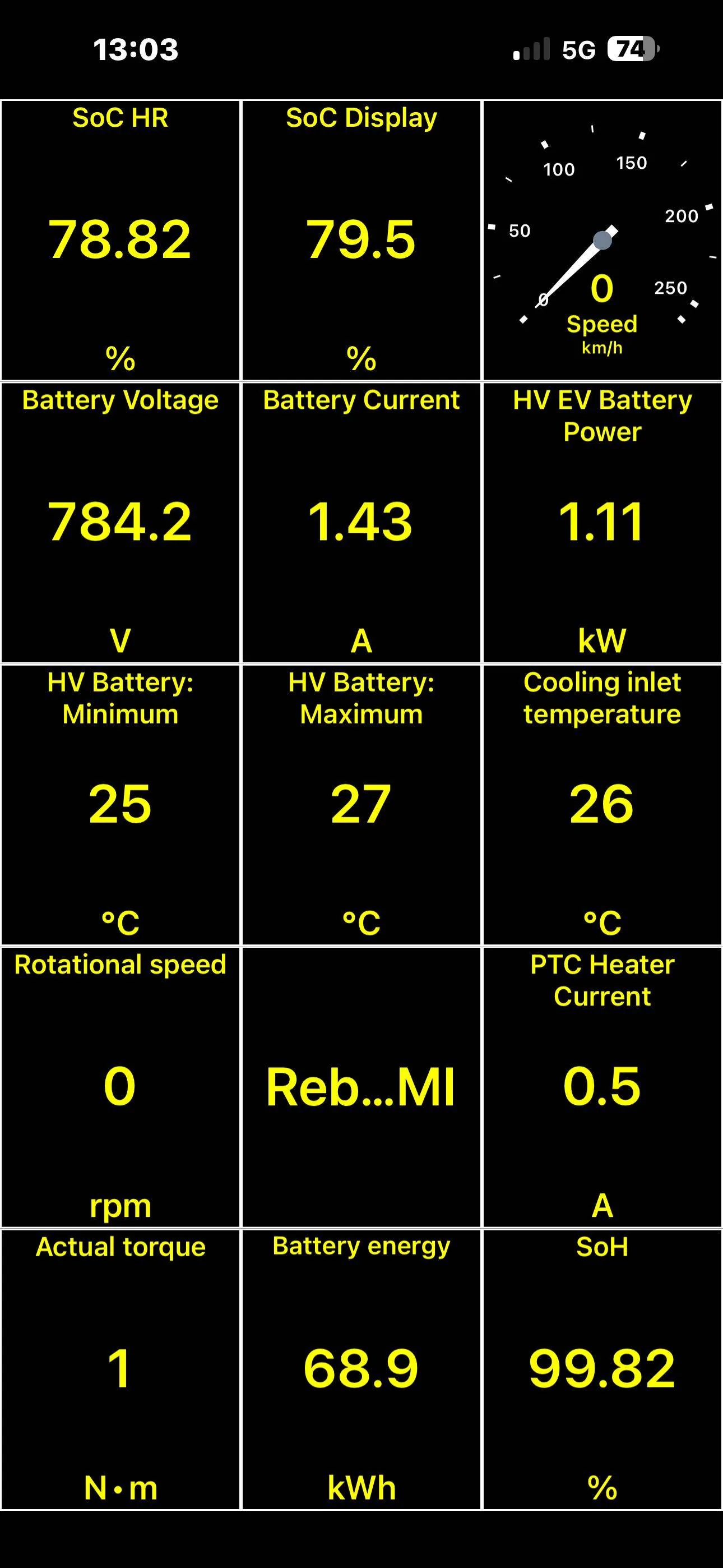

But the car is amazing and surprised at the battery stats.
SOH 99%+
Range 420 km.

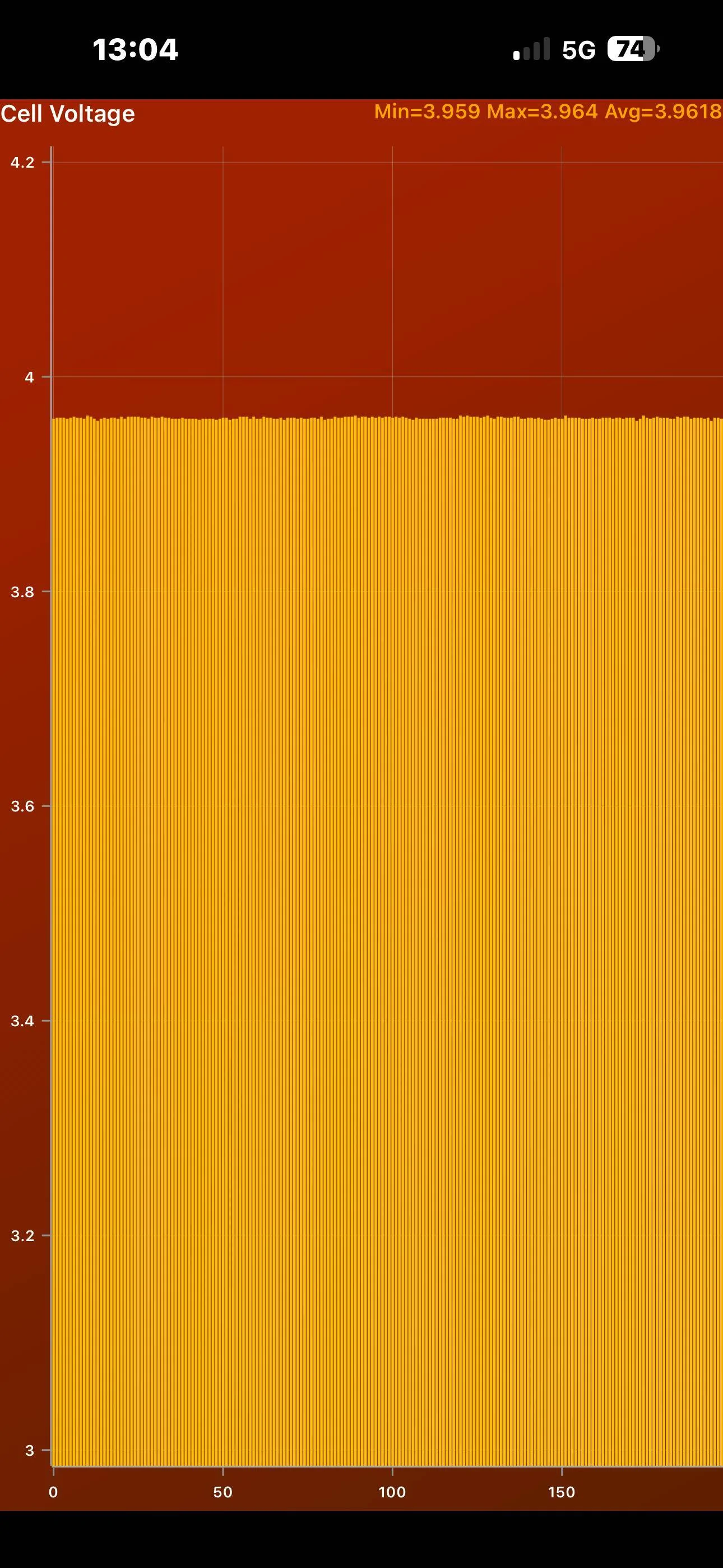

And all cells are equal balanced!!

Very surprised at the SoH at 54000 km. But pleased with the equal charge level on module level!!
