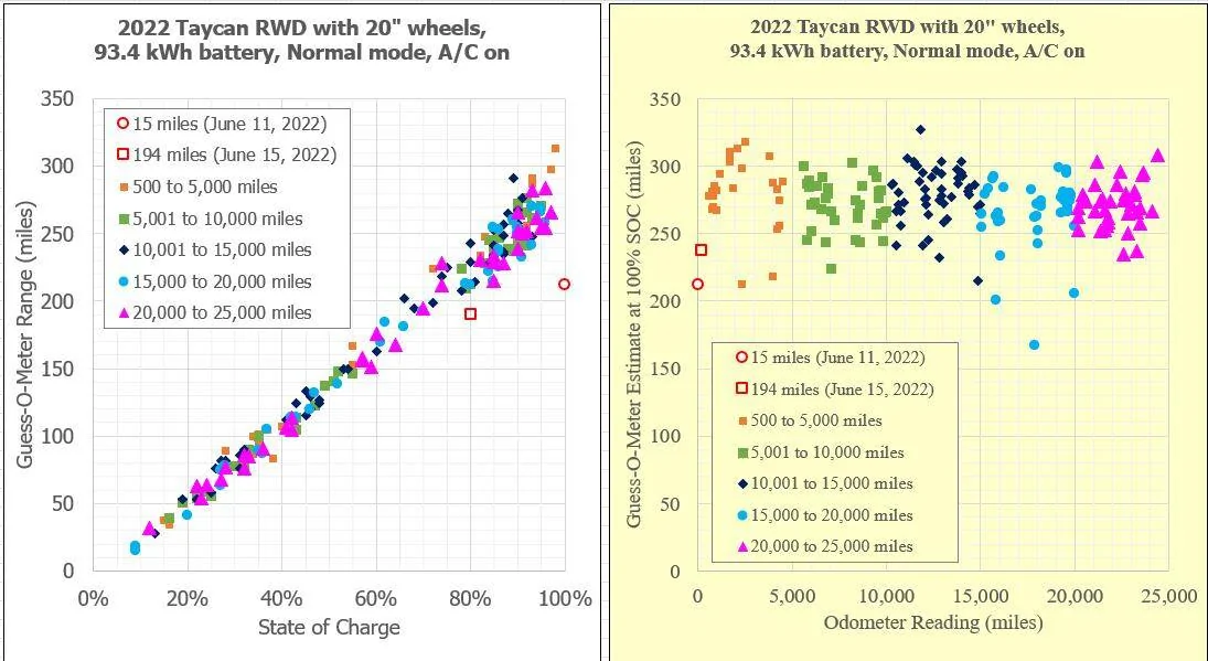

OP, please include key details in future posts because it's easy to get 30 extra miles on a full charge by switching to RANGE mode and turning off any heating or A/C. I can't tell if you did it or not. That's why I always measure mine in NORMAL mode with the A/C on.
See my charts below. The left chart is actual readings, and the right chart is the guess-o-meter estimate at 100% SOC.
A lower %SOC at the start of the charge lowers the guess-o-meter estimate at 100% SOC. For example, the cyan-colored dot with 167 miles was calculated when I pulled into an Electrify America station with 9% SOC and just 15 miles on the guess-o-meter.
Normal mode. AC off. No fancy charts. ?
