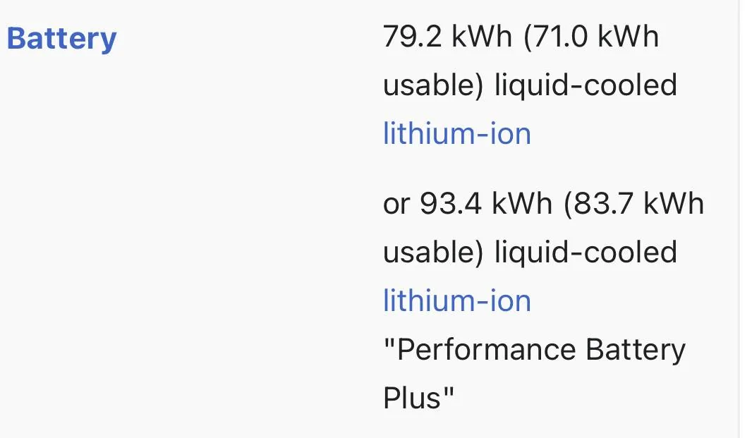

As a further point, does anybody know what the car 0 - 100% capacity is? We know the battery capacity, but what about the usable capacity? What’s remaining at 0% and how full is indicated 100%. Knowing this would be useful to aid calculating charging efficiency.

Useable capacity is 83.7kWh for the PB+ (93.4kWh total capacity).
Covered in detail elsewhere on the forum.

Thanks, I have since checked the Porsche technical data and that states net capacity is 83.7kWh. Using this, it looks like my charging efficiency was a whopping 65%! Something I’ve never checked before. . . .
