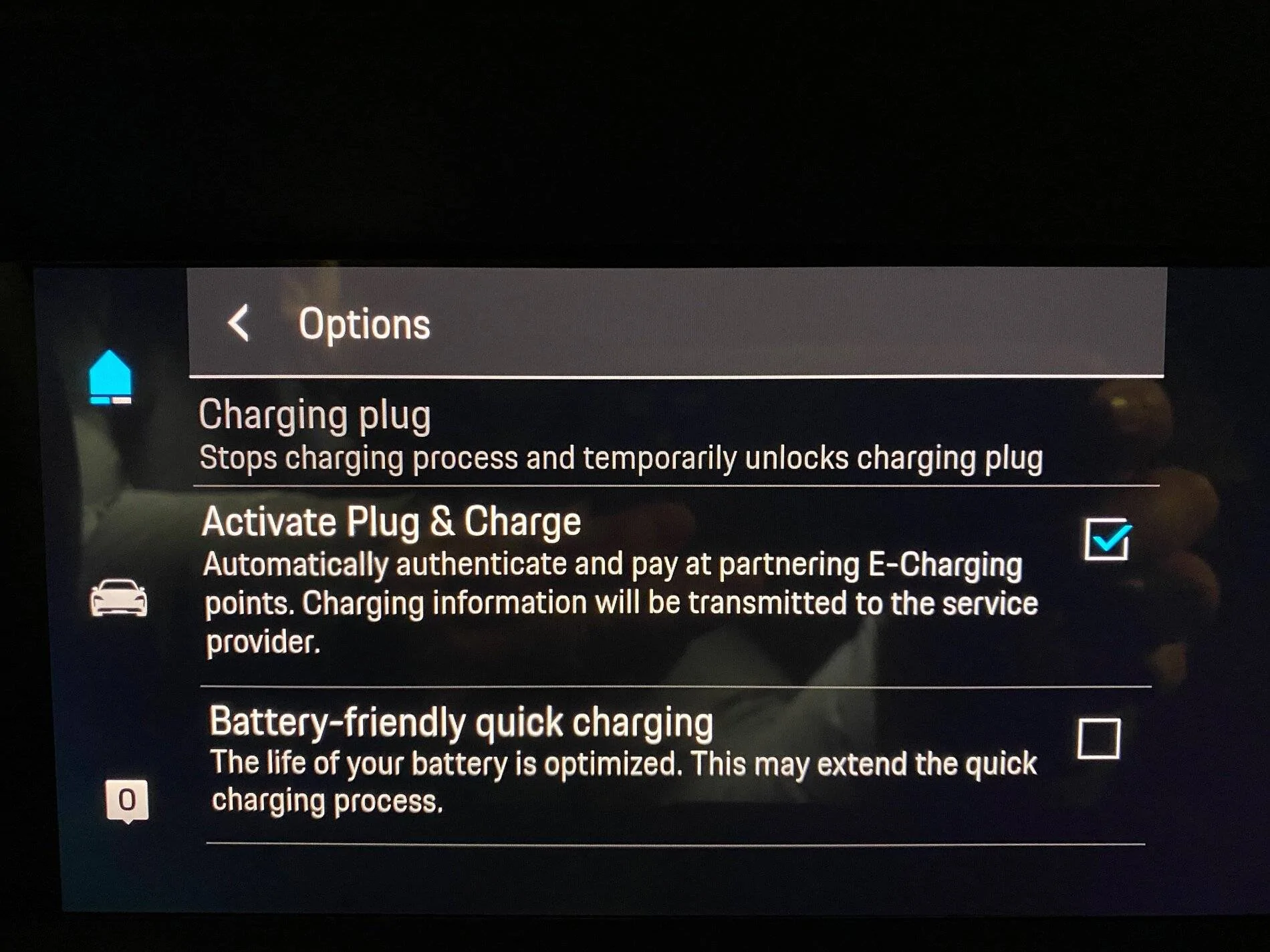

I can confirm that Plug & Charge is working for me.
My understanding here is that you might need to use the app (Charging NA) for the first time you use a EA station and subsequently Plug & Charge should work
The first time I used an EA station, I did not figure out (2) below but the second time it worked when I plugged in. Give the EA station a minute or so to communicate, authorize and automatically start charging
Just a few pointers:
1. Make sure you have a credit card on file on your Porsche Connect Account
- charges over the free 30 mins will be invoiced to that credit card on file
2. Make sure that you have turned on the Plug & Charge feature on your PCM
- Go to "Charging" from your home screen > look for the "..." in the bottom right corner for more options and that should bring you to page where you will have to check the box for "Plug & Charge"
See Picture
Good Luck
