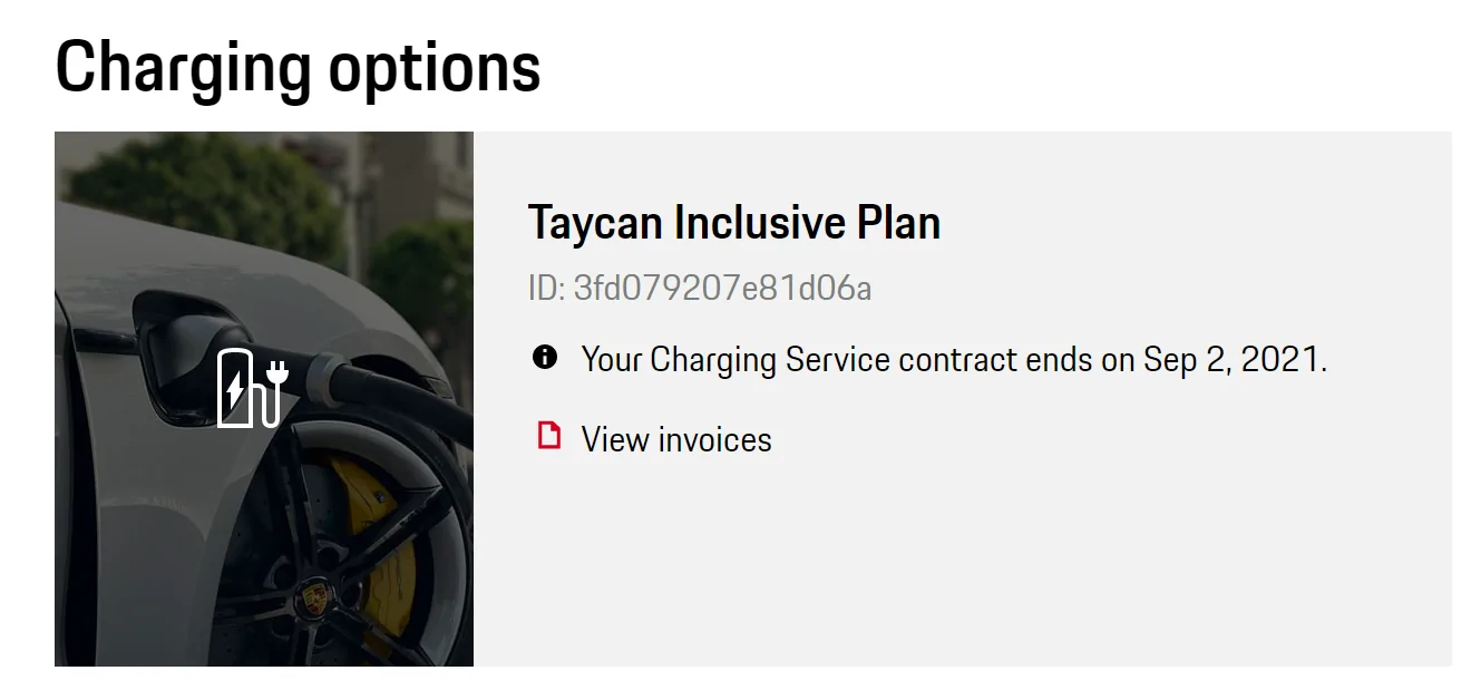

Thank you so much for the fantastic response. I have a 2021 on order, and plan on using the plug & charge feature. Meaning, I should not have to use any of those apps - correct? I should be able to just plug-in and it will charge… And assume that it will recognize my first three years free and give me my first 30 minutes free of charge on EA stations right
you might be planning on using it but the system is far from ready for prime time. in my limited experience you must use the porsche charge app to initiate a charge. and that is far from reliable.
mystique
Jan 30, 2021
2014 911 C4S, 2021 Taycan 4S
Yes you are correct. The free 30 minutes will be applied as a credit/discount.

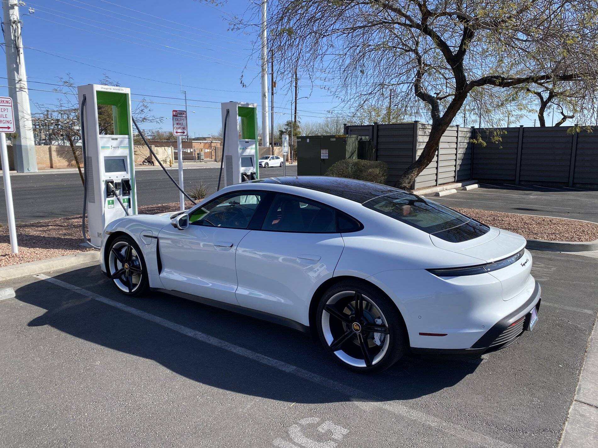

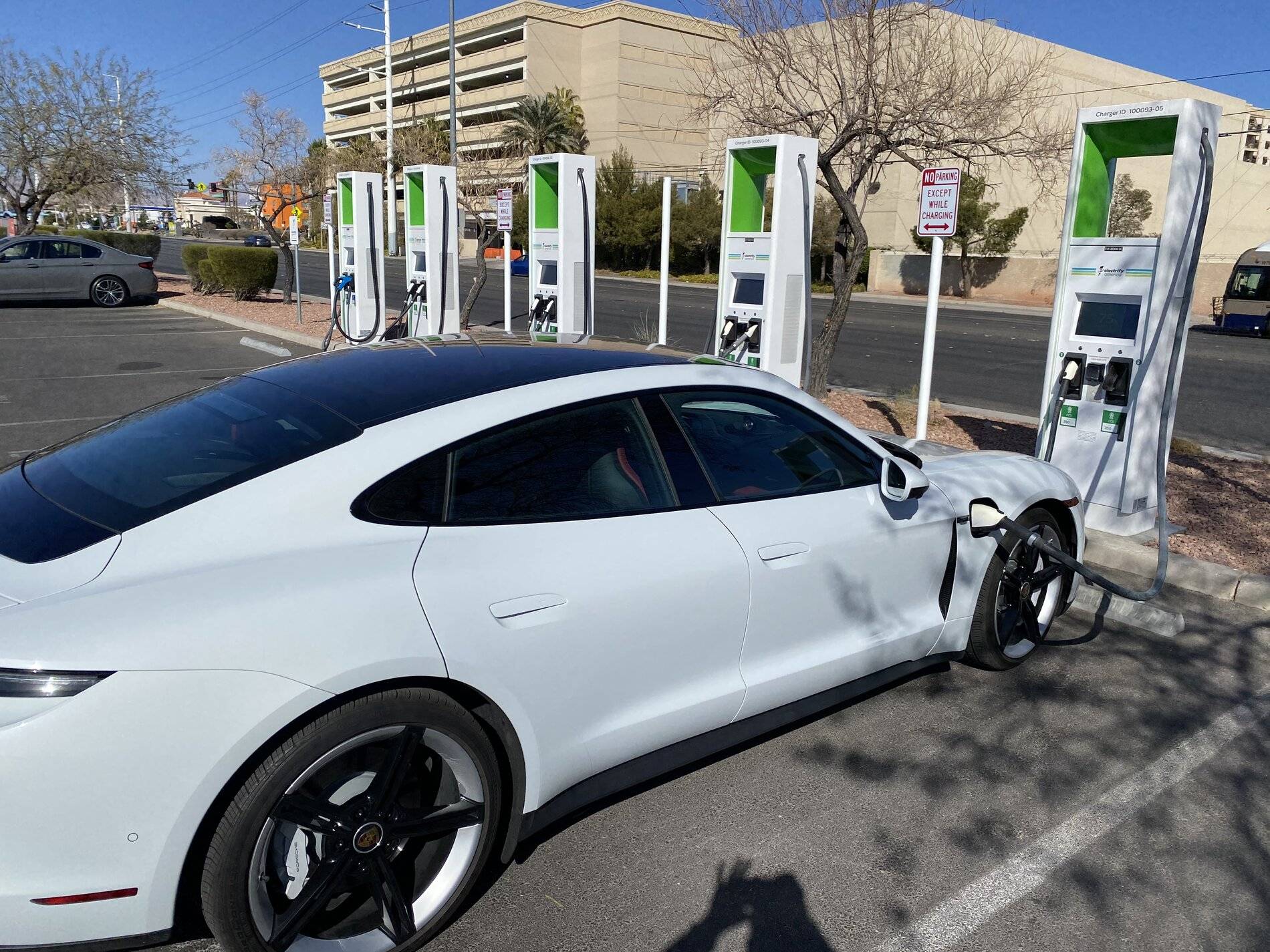

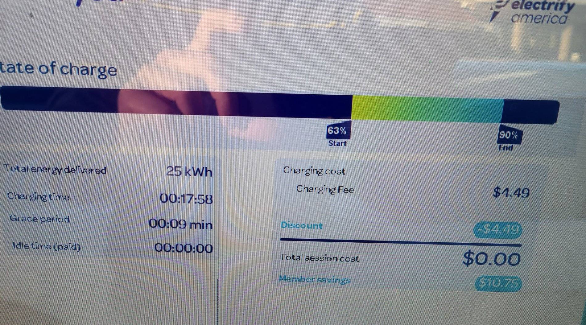

My second attempt at "free/credited" charging today worked on the EA 350 kW charger! I arrived at station with 40% SOC, 68 deg battery temp and 55 deg ambient temp. I attempted to use the Porsche Connect app and it said that there was an error and could not initiate charging, but my car was charging. I also got to go past 30 minutes of charging until I stopped the charge from the app and was billed like an extra 12 cents? Not sure how I will be billed as I don't remember giving Porsche a credit card for the Connect app Porsche Charging Service? My maximum charge rate was around 105kW, and I went from 40% to 90% charge in the 30 minutes. I did set the EA charger as. a destination in my Nav to precondition the battery, but it was only a 15 minute drive from my office to the EA station, so not enough time most likely to condition the battery. I hope there is a software update for the Plug and Charge feature for MY2020 Taycan owners. Tesla's Supercharger network is so much easier to use, fast and plug in and it just works, it was also free for me for my first 8 years.
So I went to the local EA DC Fast charging site again today to check if I could initiate and charge using the Porsche Connect app and still have not been able to get it to work. The Charging NA app works fine, as does Electrify America pay app. I called the EA service rep and they said that their notes say that the Porsche Taycan users should use the Charging NA app to initiate their credited charging sessions, they had no mention of being able to charge directly from the Porsche Connect app. I arrived at 25% SOC and left after 30 minutes with 90% SOC! My charge rate peak speed was 154kW, the rep said that I should have gotten even more speed and they would send a technician out to check on the speed/functioning of the 350kW chargers. I arrived with battery temp of 80 degrees and left with battery temp of 92 degrees at 70 degree ambient temps. I am very happy with that charge rate without even being able to reach peak speeds yet. That is faster than I think I ever achieved in any of my Tesla models at a Supercharger. I can't wait until I am able to see the 200+kW charge speeds that some are able to achieve. Road trip soon!
they are correct that the charging is not initiated via porsche connect, but that app needs to be configured, a credit card listed and logged into. charging is initiated by using the porsche NA app, you find your charging location and then select the specific charger. the plug and charge feature might be available at some EA units but in my limited experience I have not encountered such a unit that allows for plug and charge. FWIW at the most optimum of battery condition the most you are capable of receiving at a 350kw unit is 270 and I think that high rate is the cause of some issues at the EA units, it is a lot of juice to be pushing.
they use the credit car you entered into the porsche connect app. it is a cumbersome arrangement that all these apps needs to "talk" to each other to make it work.
