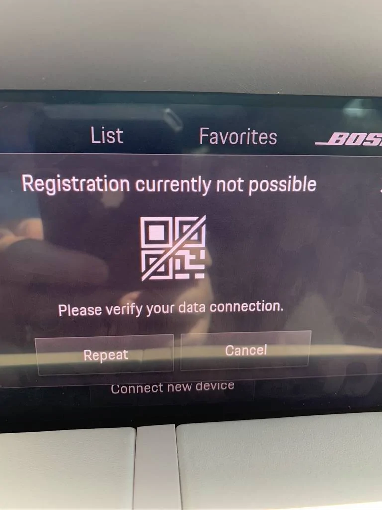

Anyone still has these issues, as its been a week and have tried everything but still keep getting this screen.
My car has been waiting for a fix since September. Been at the dealer for it and they can’t get Porsche to do anything about it. I have complained to Porsche and all I get is we are working on it. Totally unsatisfactory.

Same here, brand new car 50miles...only connects when maximum LTE connection, I believe the Ping is the issue...

I have been dealing with this issue since the Update to stop the car from stopping while driving, does anyone else get this message on Apple Music (not Carplay) when they try to attach their Apple Music account to the PCM? It won't let you login and is currently sitting at the dealership and they don't know what to do. I suggested they replace the parts that are associated with the Apple Music (possibly the PCM) but am getting nowhere. Thoughts?

I just got this day before yesterday, and corrected it by:
capturing this QR code image with the phone camera and following the resulting link.
signed into the Apple Music app (again, on my phone), with a password reset, and creating a new password.
I rebooted the PCM (not sure if this is absolutely necessary, but it didn't hurt), and everything has worked properly since then, through several driving sessions.
I hadn't done any service or anything unusual before the misbehavior happened. I use Android, not Apple IOS. In my view, this problem is purely within the user's security realm, and really shouldn't depend on the service center taking any action. That's as long as my approach works for you. If not, then I guess the service center has to deal with it.

I just got this yesterday, and corrected it by:
signed into the Apple Music app (again, on my phone).
I rebooted the PCM (not sure if this is absolutely necessary, but it didn't hurt), and everything has worked properly since then.
I hadn't done any service or anything unusual before the misbehavior happened. In my view, this problem is purely within the user's security realm, and really shouldn't depend on the service center taking any action. That's as long as my approach works for you. If not, then I guess the service center has to deal with it.
How do you use the QR code if it has a line thru it?

Ok. new CT4 here, I've associated my apple music account and turned it on in the my porsche portal. Nothing related to Apple Music shows up in the PCM. I've sign out/in again and also rebooted the PCM, no change. Sounds like what others are seeing? or am I missing something?

Has anyone been able to gt past this? I linked the apple account through the my Porshe App. Love my CT but really would like to get this issue resolved.

Yes, I had this for a while. I enabled the WiFi option and then I could register; people told me the two weren’t related and so I canceled my WiFi and sure enough it still continued worked (I have to occasionally rescan the registration QR code after an update or other event, and that also works).
I don’t know if toggling the WiFi on and off kicked something into action; or that was just a happy coincidence.

When you say you enabled the WiFi option, did you register and pay for that (then later cancel)? Thanks
Yes; it’s a minimum 30 day so I got hit with a one month payment. As I said, could have been coincidence, but my Apple registration started working immediately after I did it!
