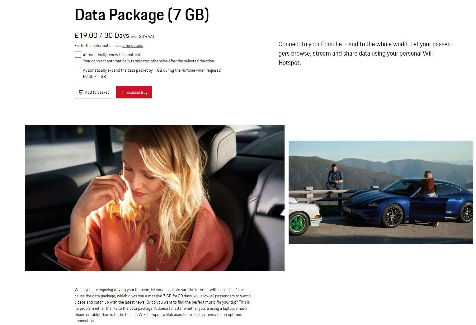

I think Porsche may have reworded this Connect Service in some regions realising (finally) that they were in danger of misrepresenting the intended purpose or use (there are people on this forum who were duped in this way and signed up for it).
Reference is made to 'find the perfect music" i.e. music which isn't available on Apple Music

I have unlimited data on my phone for less than the miserly 7GB offered per month.

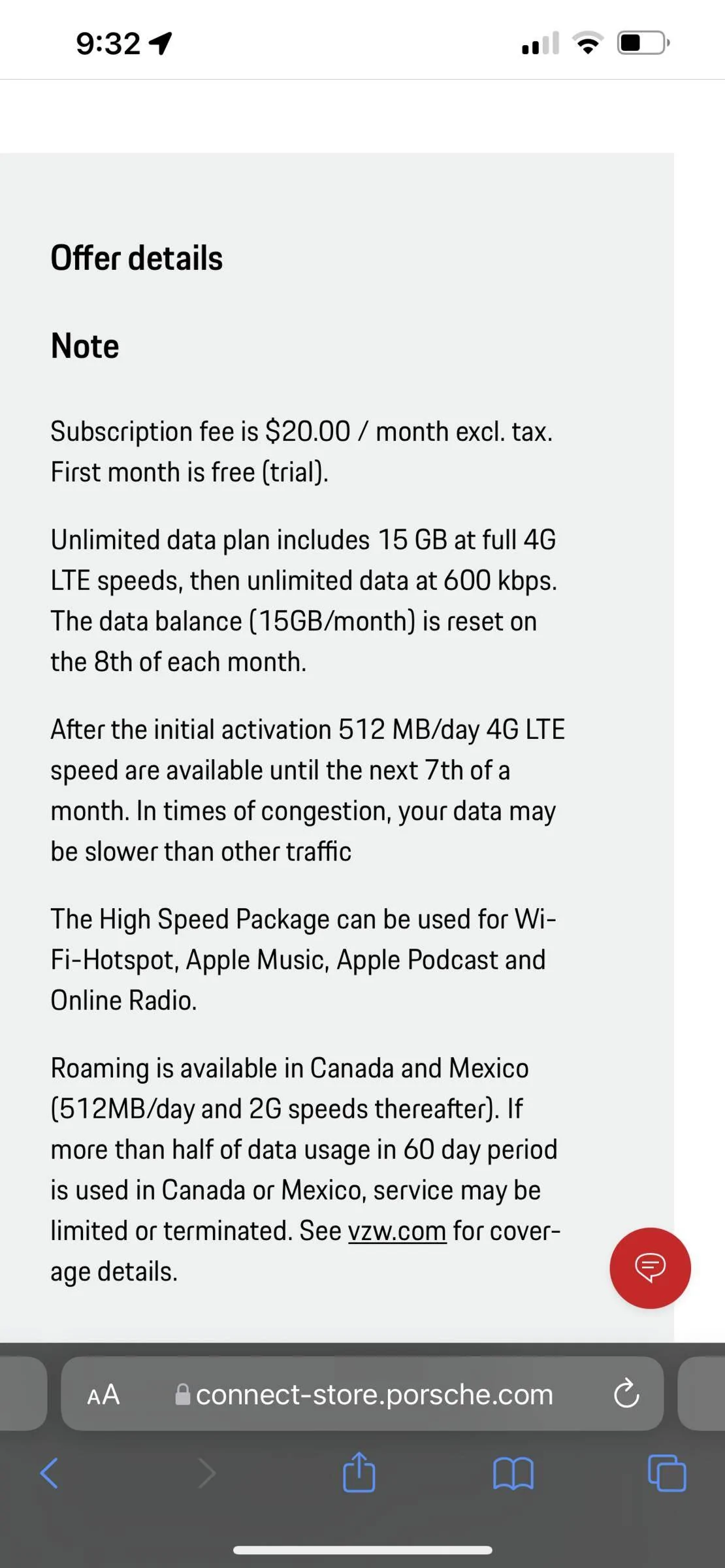

This is the wording on the data connection option:
Crucially it states "can be used..." not a requirement or pre-requisite which would be aligned with everything known and understood to this point in all regions.

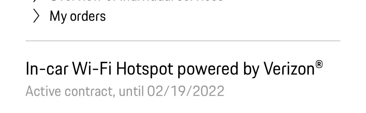

The registration error says to check data connectivity. The trick will be to see if it stops if I disable it again - unfortunately it will be 30 days until I know because it’s a minimum one month contract.
How long before you were able to see this in your ,y Porsche account, as when I activated it it showed be the 10 minute activation thing but after activation its not showing up anywhere where I can view or cancel as just did it this morning.
For me it was same all other functions (OTA update, weather etc) were working without this data plan, once I activated the data plan as you mentioned earlier Apple Music login. just worked within seconds.
Where do you get to see my orders under my Porsche? as can't see the In-car Wi-Fi Hotspot under connected services

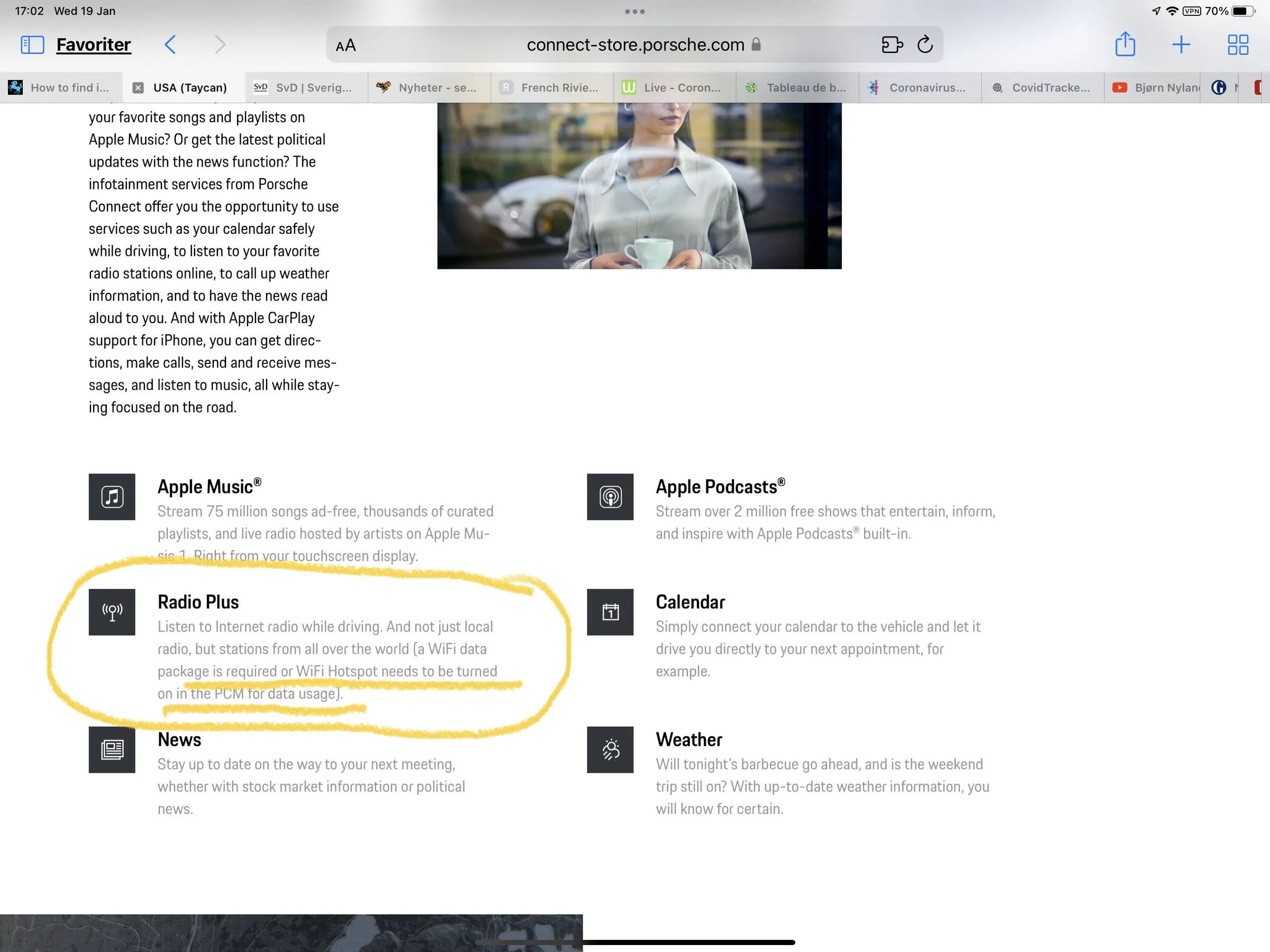

It seems indeed that it is dependent on where you buy your car in Wht region and country. I was intrigued that the experience was so different and found this stated for internet radio on the US Porsche site. It is not totally clear for Apple Music though. But for internet radio it seems clear you need the data package. Maybe that has been extended to Apple Music etc as well???
The plot thickens - the same page in UK doesn't say that. Something has changed in the last 18 months (for the worse) I fear. As you point out - Apple Music no mention.
