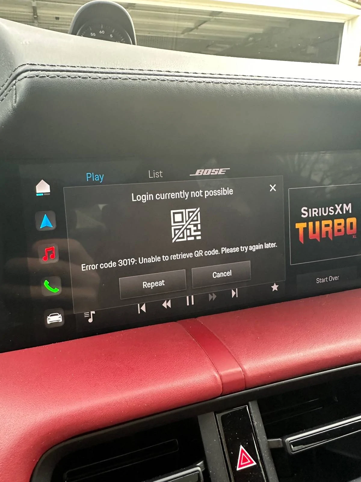

I haven’t been able to log into Spotify for many months. Same error every time. Not the biggest deal since I have BT and CarPlay options, but wondering if anyone else has this issue or knows a fix.

Send an email to [email protected].
To pre-empt some questions, send them:
  • A photo of the Spotify error that pops up
  • A photo of the Private Mode setting (go to Settings > Privacy and Porsche Connect > Private Mode)
  • A photo of the LTE icon on the right hand side of the screen
Also check if other online services such as News or Weather are working (I suspect not). Let them know.
Even if you don't use Apple Music, try and see if you get the same QR code error.
They fixed mine by asking Verizon to rebuild the built in data connection.
PS For future lurkers, do this only after 48-72 hours of not working. Sometimes Porsche is down and things come back on their own.

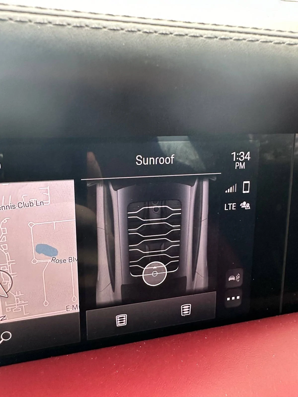

Yes, the LTE icon on the right upper side of the PCM must show. You might have no connectivity. Checking if Online Radio and Apple Music also dont connect is important.
There was recently an issue with LTE connectivity in the Bay Area, CA, see
https://www.taycanforum.com/forum/t...g-for-13-days-and-then-back.19500/post-300611
I called Porsche Customer Support, but they were unable to help because LTE icon was missing, they said. Next, suggested that visit the dealer, which i did but only via texting, and then, after few days, the LTE came back up.

LTE logo is there. I assume I have connectivity because I am able to remotely connect to my car through the app for preconditioning, etc..
I had the same situation. No issues connecting to the car via the app, but still same issue as you.

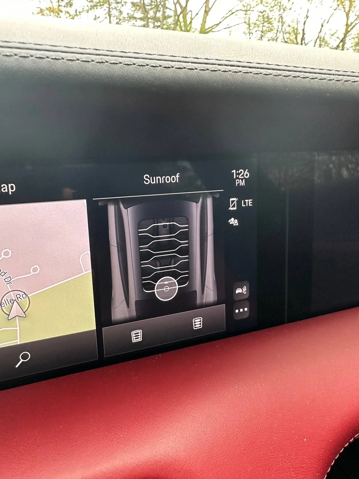

The LTE signal strength showed up once I connected my phone.
I’ll reach out to Porsche and update the thread with what they say.
