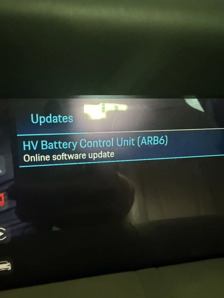

Has anyone in the US received the ARB6 OTA update? I have seen ARB7 in the forum not ARB6....
Today the car displayed a message that an OTA update was available. I'm under ARB6. No mention of a specific recall or workshop campaign in the instructions displayed but it sure read like the battery monitoring software. I followed the instructions to initiate the install and got absolutely no indication that it was proceeding. The car's message stated that you would know the install was complete when the yellow indicator went away. No install indicator was displayed so I gave it a little extra time (15 minutes) and hoped for the best. Notifications now showed the install as complete. Download and install process seemed glitchless. ARB6 recall already removed from the Porsche website.
So to answer your question it appears that Porsche is getting around to pushing out the software update to ARB6 vehicles.
