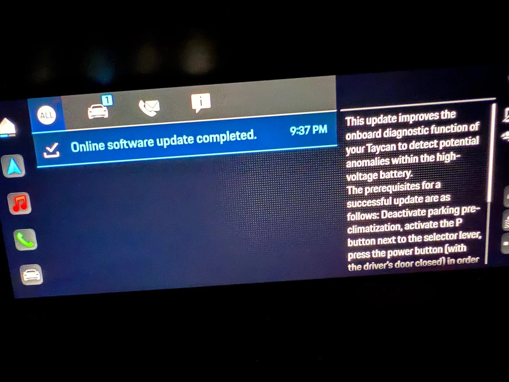

Has anyone in the US received the ARB6 OTA update? I have seen ARB7 in the forum not ARB6....
Got ARB6 yesterday, started the download and finished in about 20 minutes.

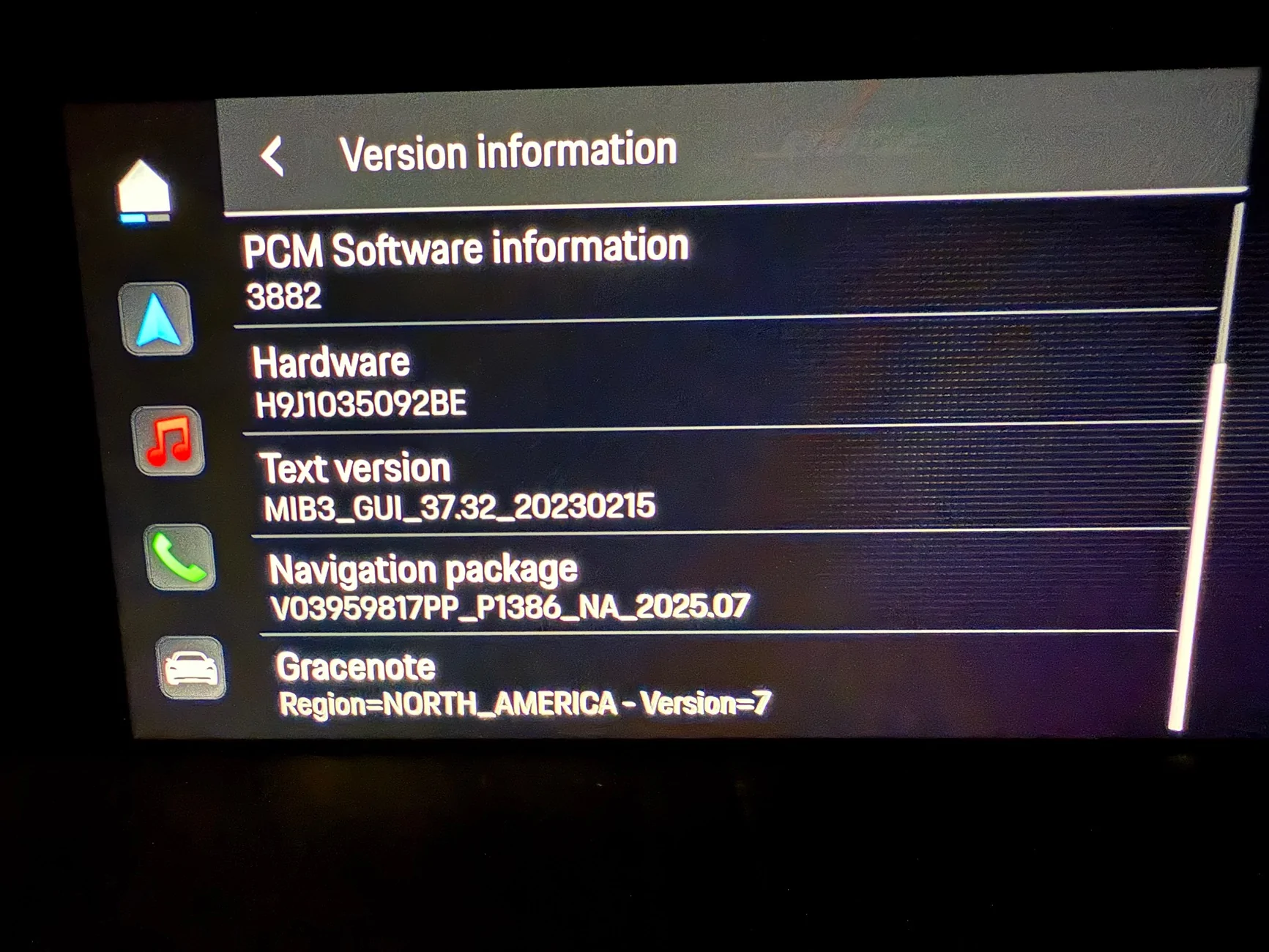

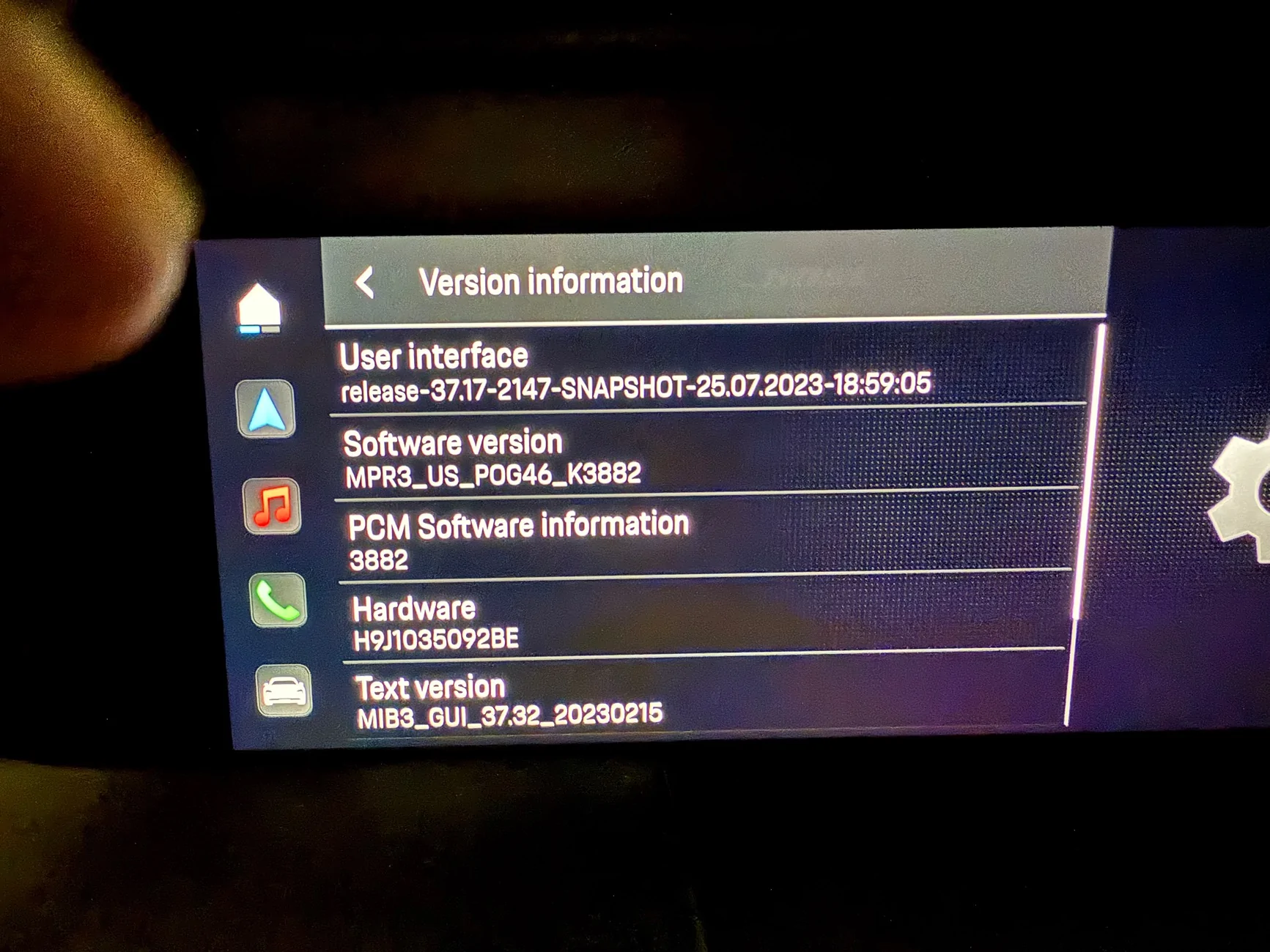

I'm still waiting for this OTA. I thought it was only ARB7 that was OTA, and ARB6 was a service visit.
I have received OTAs before, but I don't have the send car data options checked. Is that a requirement for this specific OTA?
You got me thinking maybe I was wrong. Went out and tried to find out the update in the car. Unfortunately only got a couple pictures and am not sure if someone can tell which update.
Porsche Taycan ARB6 over the air update IMG_0875
Porsche Taycan ARB6 over the air update IMG_0876
Porsche Taycan ARB6 over the air update IMG_0877
