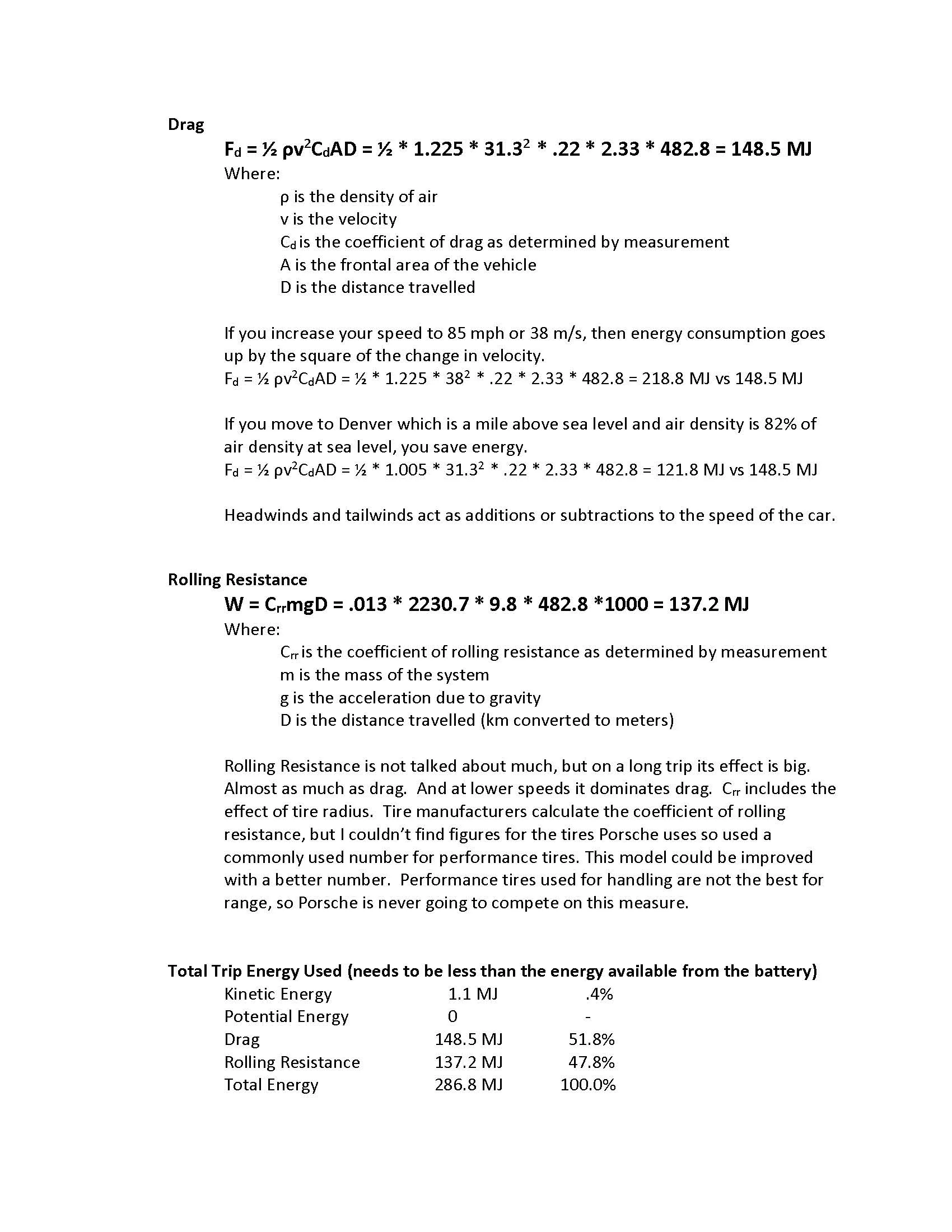

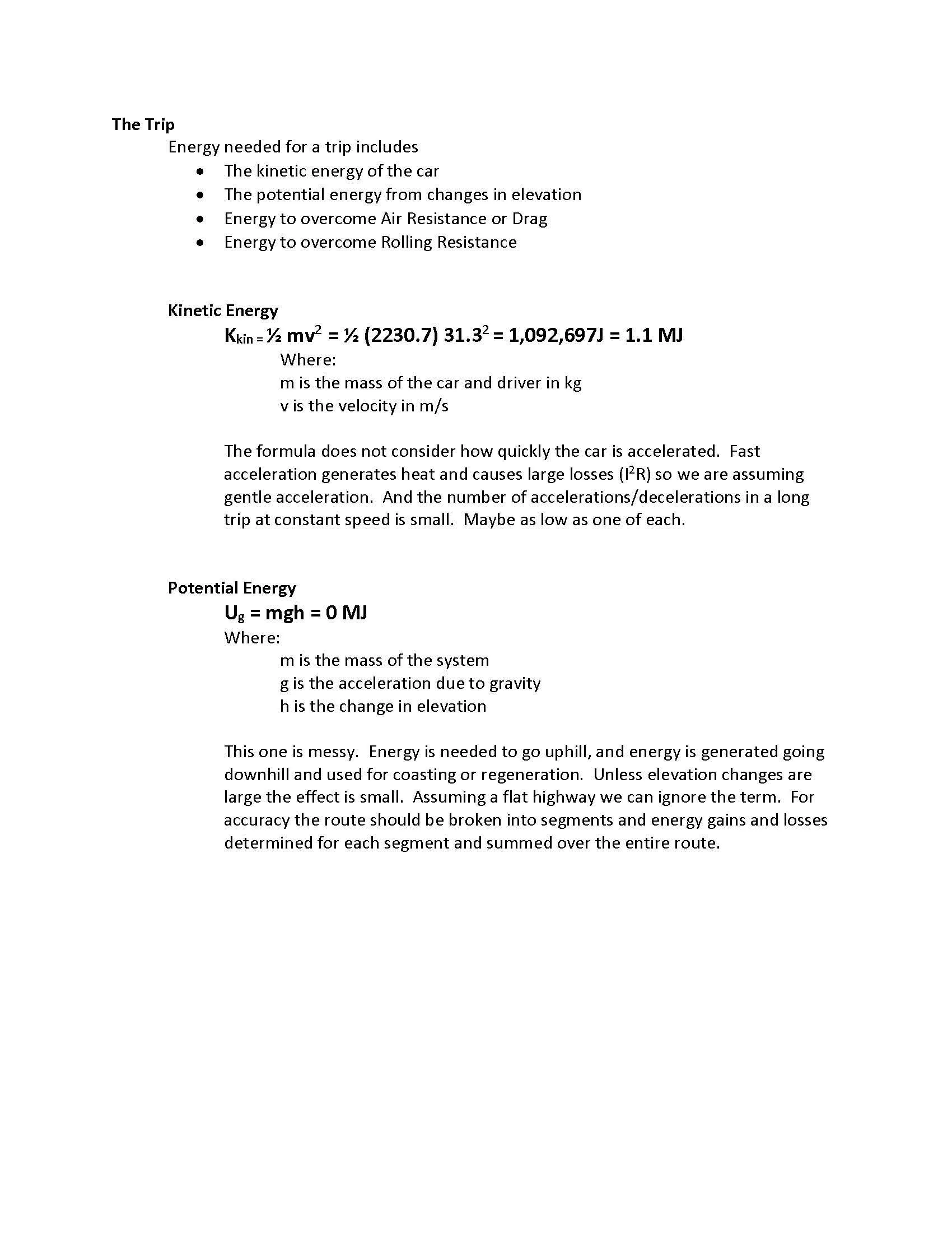

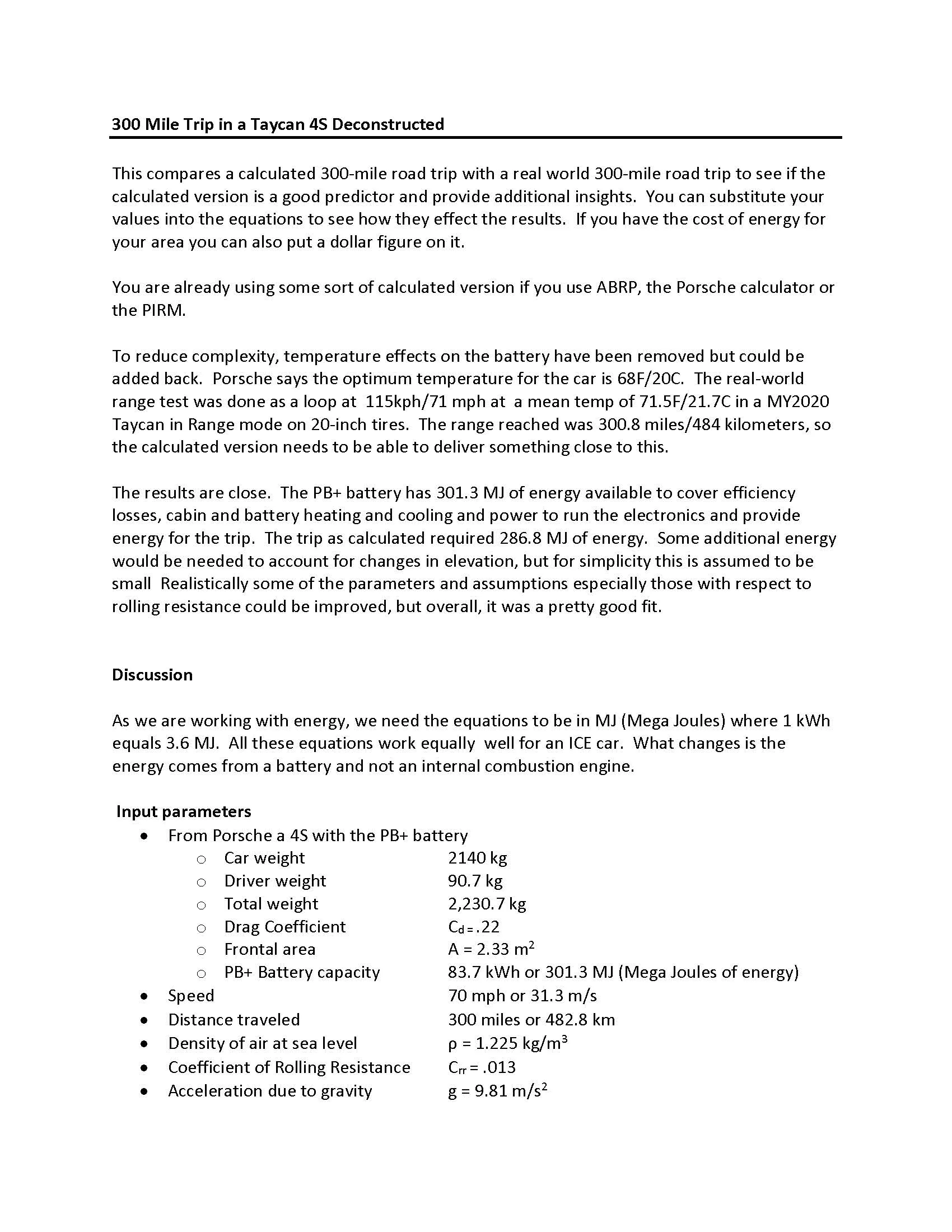

If you weigh 150 lbs., live in Denver and have 19 inch tires you are.
Or perhaps you are wondering if I get that gym membership and lose 50 lbs., how much will I save if I drive my Taycan 20,000 miles per year. For my area that would be $2.06 if I charge off peak and $4.39 if I charge on peak.
Here are the details.
Porsche Taycan Are You a Range King? 300 Mile Trip in a Taycan 4S Deconstructed_Page_1
Porsche Taycan Are You a Range King? 300 Mile Trip in a Taycan 4S Deconstructed_Page_2
Porsche Taycan Are You a Range King? 300 Mile Trip in a Taycan 4S Deconstructed_Page_3

Some pretty harsh responses to your work. Surprising. Thanks for laying this out. I haven’t received my car yet but I appreciate having the calcs for the physics in play. Will see how close I come….
