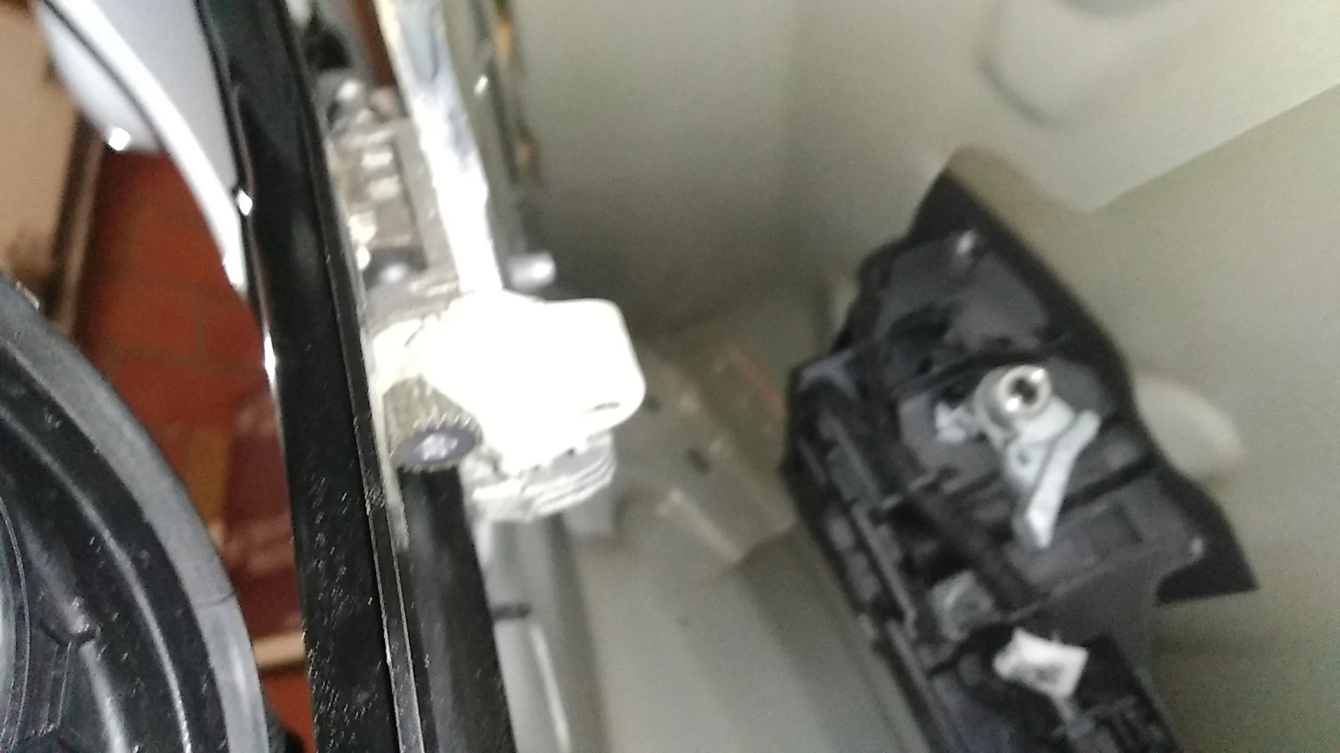

I had possibly a similar rattle ... the glass is held in place with 2 brackets ... there is a torx screw at the bottom of the bracket, the screw basically points straight upwards ... it's very hard to see, need to use the camera of your phone to see it.
I turned that one ever so slightly and boom, rattle-free
I had it on the front and back, was driving me nuts, felt like I was driving some piece of junk :)
If you have the doorcard off, bang on the exposed metal to replicate the rattle... then hold the glass (lower it a bit) near the bracket and see if the rattle stops ... then it's most likely the same as I had.
pic of the screw, it's the metal ribbed one in the center of the pic
Porsche Taycan Awful rattle coming from both front doors IMG_20240331_215513
me banging like an ape, does this sound familiar?
