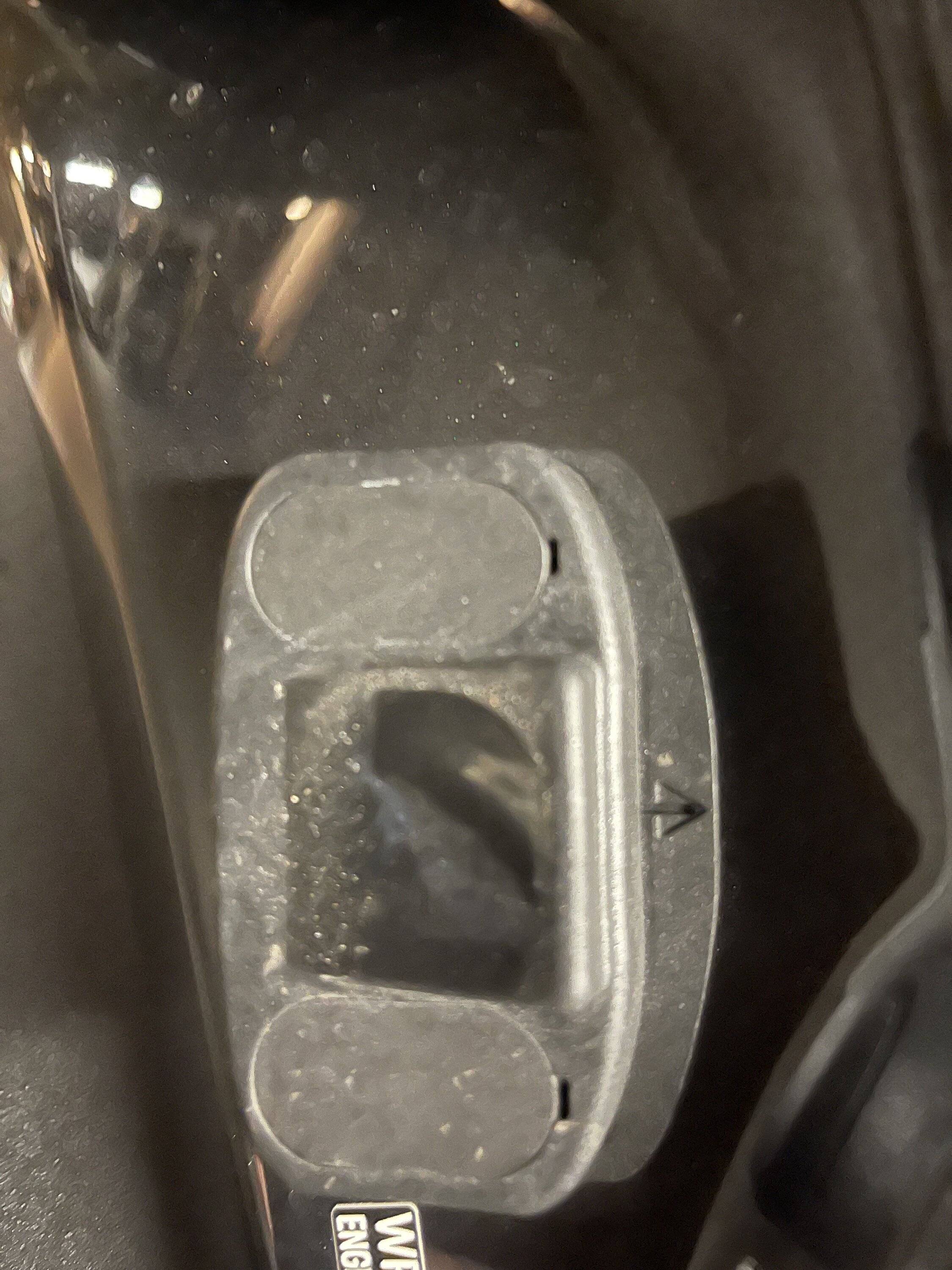

They did two things with my tailgate, adjusting the spacers. Not the height, just a small adjustment of the left/right position so they apply the right pressure.
Secondly they also gave them a rub with some lubricant they use for rubber parts in cabriolets. Didn’t really understand why but perhaps that was to allow the tailgate some micro movement against the spacer, avoiding it to get “stuck” at first, then moving a little bit and causing the clunk.
This would be my advise;
1. Drive with the tailgate open on a bumpy road where you experienced the clunk. If silent, then it is the spacer issue.
2. ask the dealership to adjust. Some trial and error might be needed. Mine was perfect at first try though.
3. Just in case, ask them to apply some of the “cabriolet rubber lubricant”. Won’t hurt.
Hope this will help. If you need I can add a picture of the spacer part I refer to.
Good luck!!

Pics of the spacers would be great. I’ll have to try driving with the back open and see if it stops the noise all together.

Here is the spacer that can be adjusted just a tiny bit to increase its pressure when tailgate is closed.
Let the dealer do it for you as they did for me
