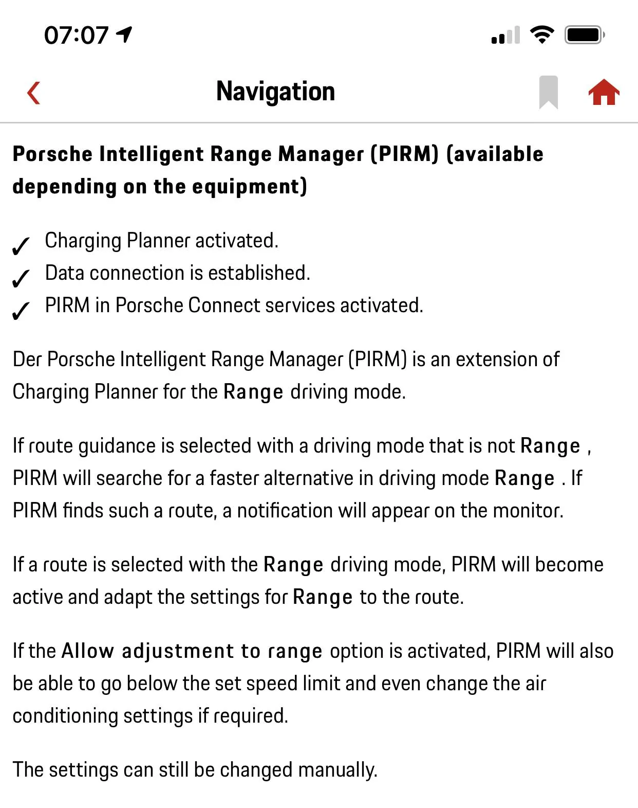

Thanks for the referal. Driving mode must be set/left on RANGE so that PIRM/Charging planner and battery conditionnning work altogether, right?
Or SPORT+ as some others suggest!!

No not a requirement.
Read the manual.
11,067
6,850
Maybe I am not reading right or maybe my English is not my mother tongue
The English used in the manual is not particularly clear.
Two things are at play here 1) Charging Planner, 2) PIRM. 1) Battery pre-conditions with any charging station selected (the trigger is that the destination is a charger and is 50kW or more), 2) Battery pre-conditions as per 1) but PIRM can invoke RANGE mode (if not already) to optimise range by controlling speed and climate control.
Proof of the pudding is to try it all out (if you have time).
