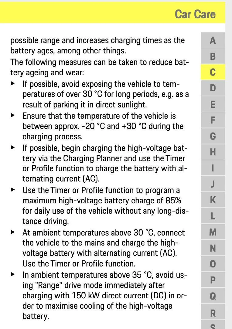

It is under "car care" page 63 if on a mac.
Besides the first bullet point, I was curious as to what the second to the last one was about? Is it possible, it wants to be connected to get energy to cool the battery? Any ideas?
Thanks for finding that for me! (Some days I'm really lazy!)
I would assume that they are saying "for long periods of time" meaning: Don't Store the Car in the Sahara Desert for the summer. Or California in 2020. "If possible".
It is true that Lithium Batteries don't really like high heat for long periods of time. (e.g. Don't leave your cell phone on a hot dashboard. Those batteries can expand due to heat.). That said, I don't think the car will be harmed parked outside for a day in the Texas heat. But if you are parking it at the Dubai airport while you escape to Patagonia for a 2 month vacation, you should probably leave it in the shade, not in full sun. Oh... wait... it's 2020... no vacation travel is allowed.
It's the "long periods" that is confusingly vague. What's a "Long Period" in the sun? 1 hour is long if my cat is in the car. Is 2 days a long period? Is a month a long period? Is a year a long period? Thanks Porsche tech writers and lawyers! Good CYA.
