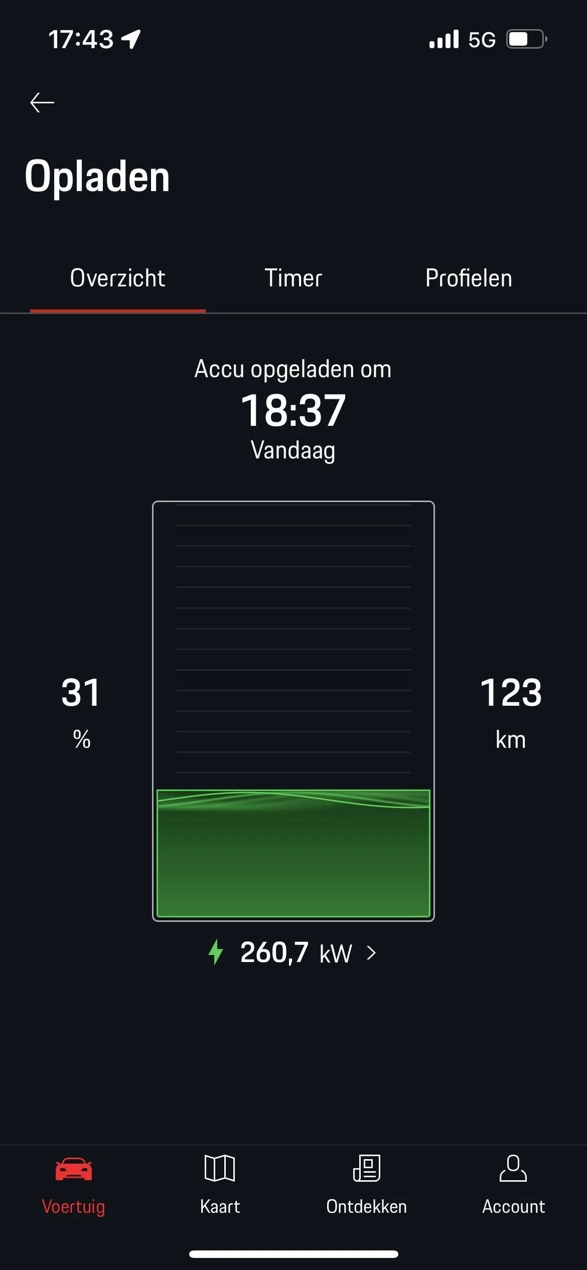

With Ionity I do get 260-270 Kw charge speed when everything is right. But that is for the first part of the charging of course. Same with most Fastned chargers. I only tried Porsche once and it wasn’t really as quick as the others at that time.
Total charge time saved can be significant. If 5 minutes extra charge time is significant is very dependent on the nature of my trip.
During daytime summer holiday trips I don’t really mind 5 minutes more because we take our dog anyway, have a walk, coffee, sandwich
, enjoy the sunny weather.
Winter, night time and bad weather is something else because then we are waiting to get going again.
My non holiday trips are usually shorter. Visiting my parents is a 400 km round trip. Charging at the right conditions is only 5 minutes if I charge from 20 to 50
% SoC on my way home. If I would charge going there from 60 to 90 it will take much longer. They live minutes from the Dutch Porsche importer. Might give it a try with the fast charger and try to arrive with a low SoC

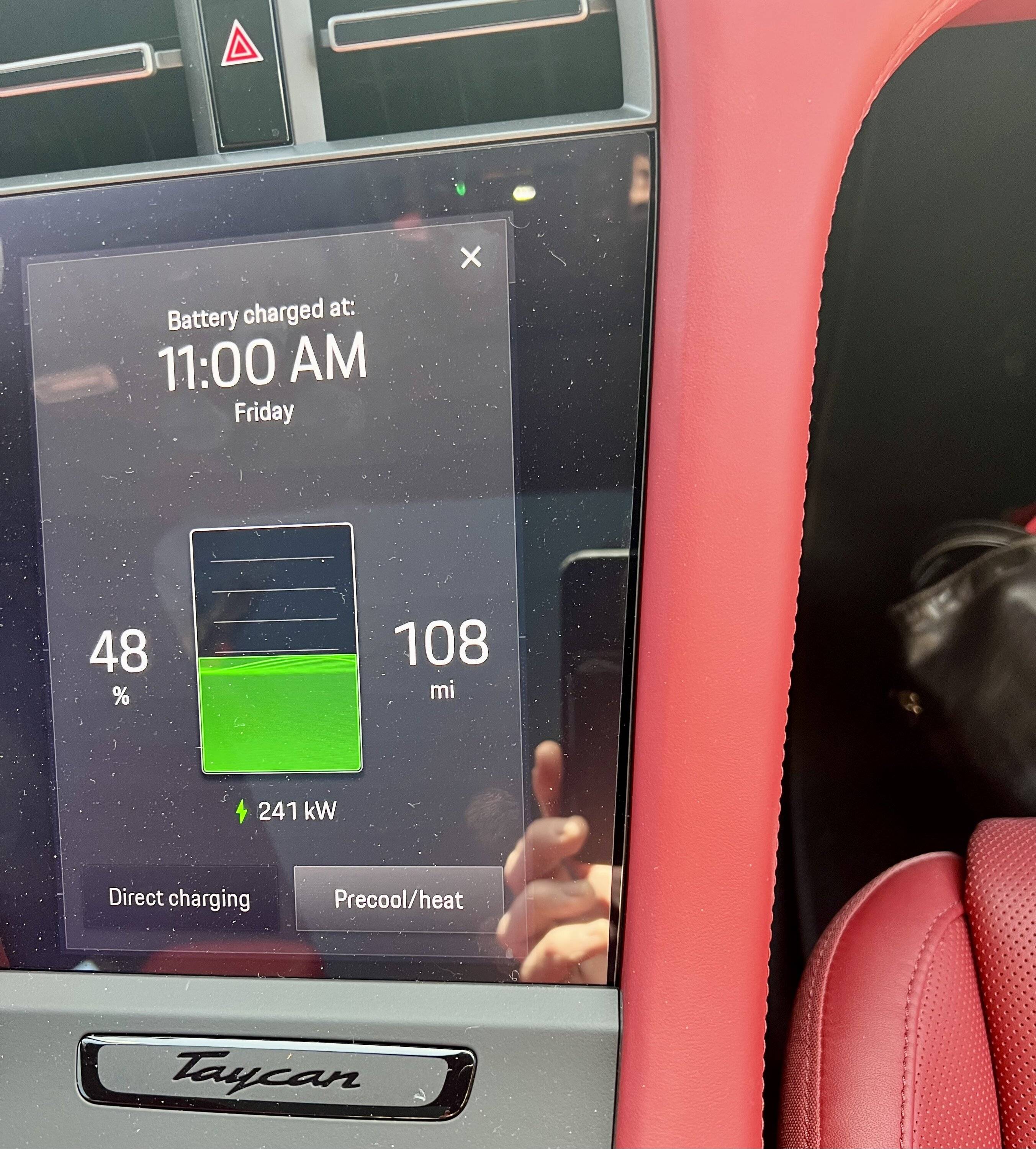

Getting those sort of charge rates consistently would undoubtedly influence perception of time spent at a station. Def not seeing this at the EA stations I have used to date. The highest I've ever seen personally (and of course dep on all the factors prev mentioned re batt temp etc etc) is 241 kW at a a 350 kW EA charger - invariably quite a bit lower for most of my charges starting at 20-30% SoC on long trips.
Everyone's perception of time also a little different I suspect - these days, being early retired, I've adjusted somewhat so that +/- 5-10 mins means little to nothing to me - if you'd asked me 10+ years ago I might have responded differently :)!!
But again, with the new EV paradigm, I just allow and roll with it!

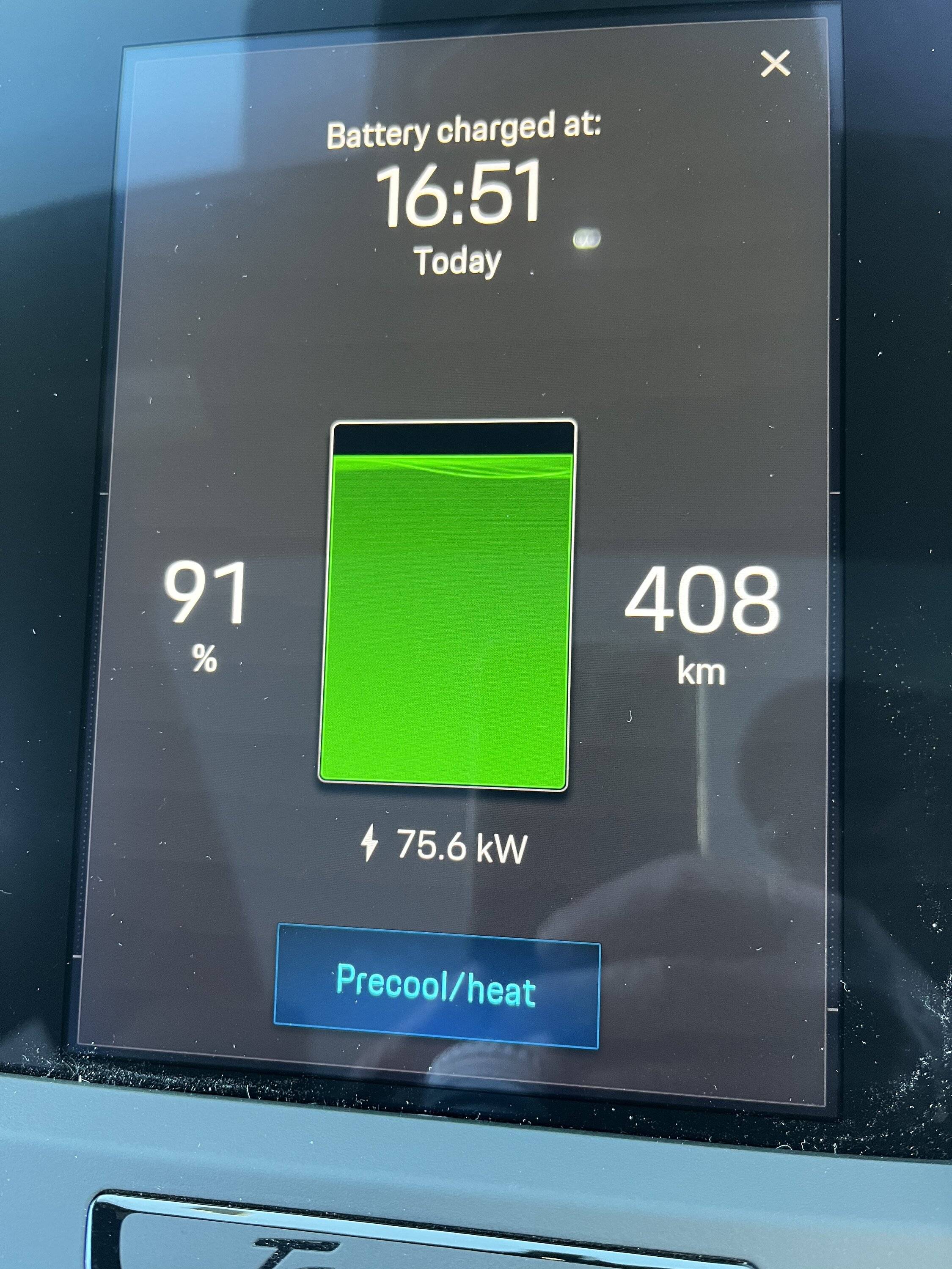

Yesterday I went to a 75kw with a SOC of 49%. Plugged in and took the dog for a walk and when I got back I saw this displayed.
So at 91% the car was still charging at 75.6kw.
I thought the rate of charge was supposed to drop off at 80%, or this this only true with 350kw chargers?

Generally higher powered EVSEs - 150kW and beyond.
