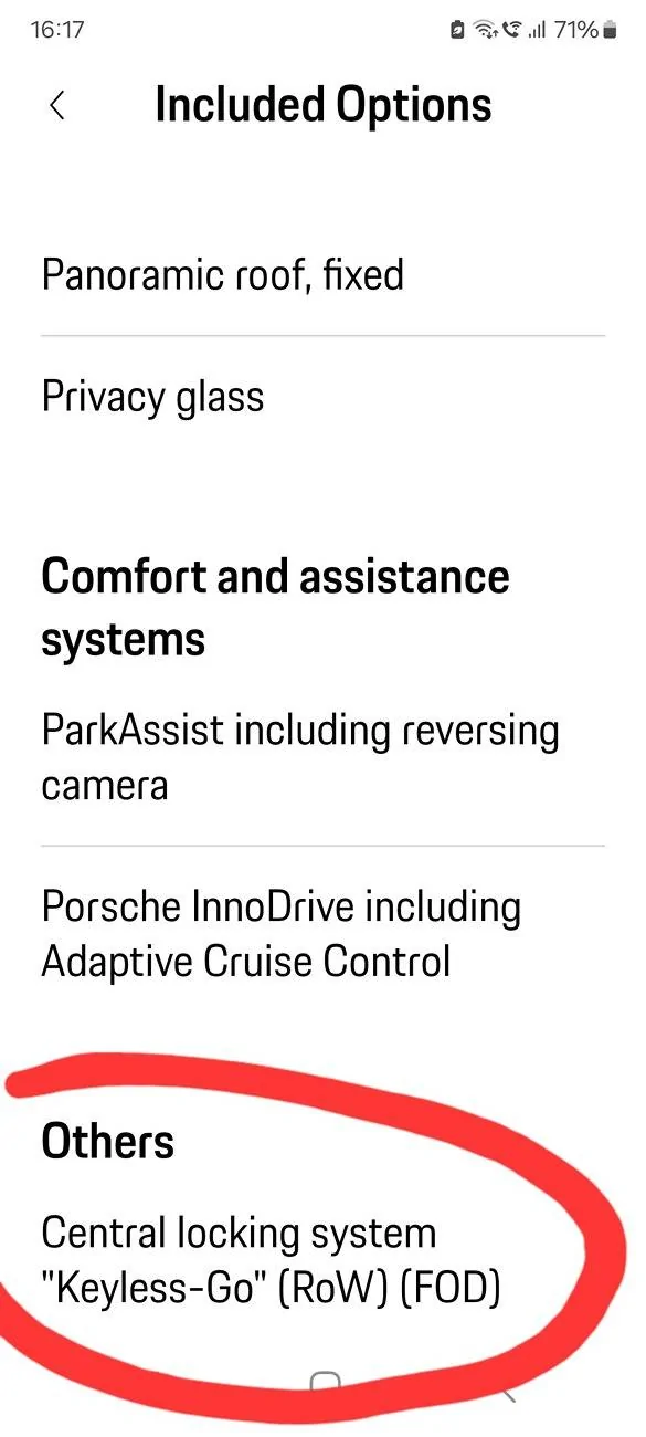

Yes, good shout - I've got a Vinanalytics report and it's on there :
410 KEYLESS GO CENT. LOCK. (ROW) (FOD)
Other options not included all start with W/O which I guess means without, there is no W/O in front of this option.

And it is listed on the 'MY PORSCHE' app as included options
Porsche Taycan Being passed between UK  Porsche Centre and Porsche AG 1000037247

Note what that "keyless go" is not the same as "comfort access". I also see "FOD" (function-on-demand) in your pic which might be relevant.

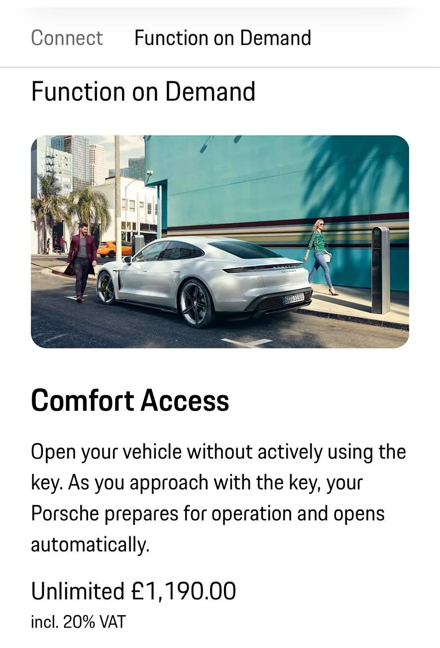

Don’t know if this is still the case, but FOD used to be available via a browser only, rather than the app. If Comfort Access is available to purchase, that may be a clue that it was previously on the car post delivery.
It is £1100 via FOD. It is unclear if it stays with the car after it has been sold and linked to a different Connect ID. My understanding is that it is intended to be permanent. But Porsche systems don’t always do the expected.
https://connect-store.porsche.com/offer/gb/en-GB

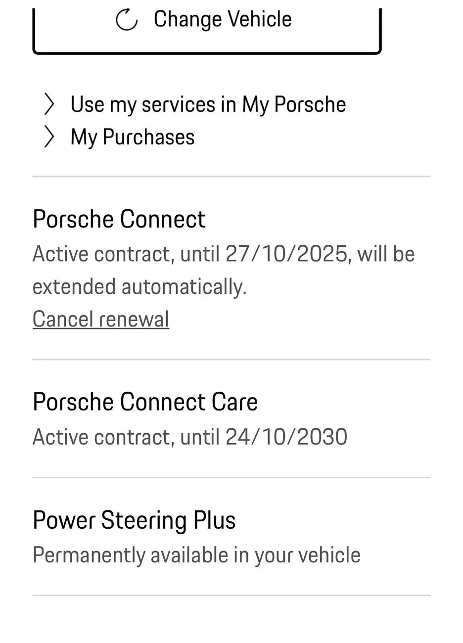

My examples are shown in the pics. I added power steering plus
Porsche Taycan Being passed between UK  Porsche Centre and Porsche AG IMG_1728
Porsche Taycan Being passed between UK  Porsche Centre and Porsche AG IMG_1727
For an OTA update, the Comfort Access price is ridiculous. If the price for J1.1 models was reduced by 75%, they‘d surely sell at least 5 times the current FOD volume.
