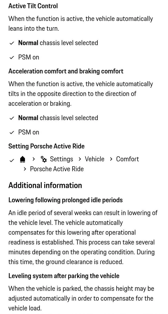

I can say PAR is very evident when driving in Normal and at least not as evident when driving in Sport +.
I always thought PAR should have some involved in every mode as it would be such a benefit on track, even if not as exaggerated when in Normal mode.
From the owners manual
Indeed, I knew the active suspension enabled negative pitch and roll in normal mode.
That wouldn't be why I would buy it ;)

PAR is on all the time if you spec it, it cannot be disabled, and it is active in all modes.
Only in normal mode you can update the setting to dial it up by enabling the 'active lean' and 'comfort braking + acceleration' functions as per Mr.Smith above. Having these settings turned on means you quickly notice the PAR system at work as you can detect/see the car's over-exaggerated tilting and leaning. So if you don't like the sensation, leave these features turned off.
