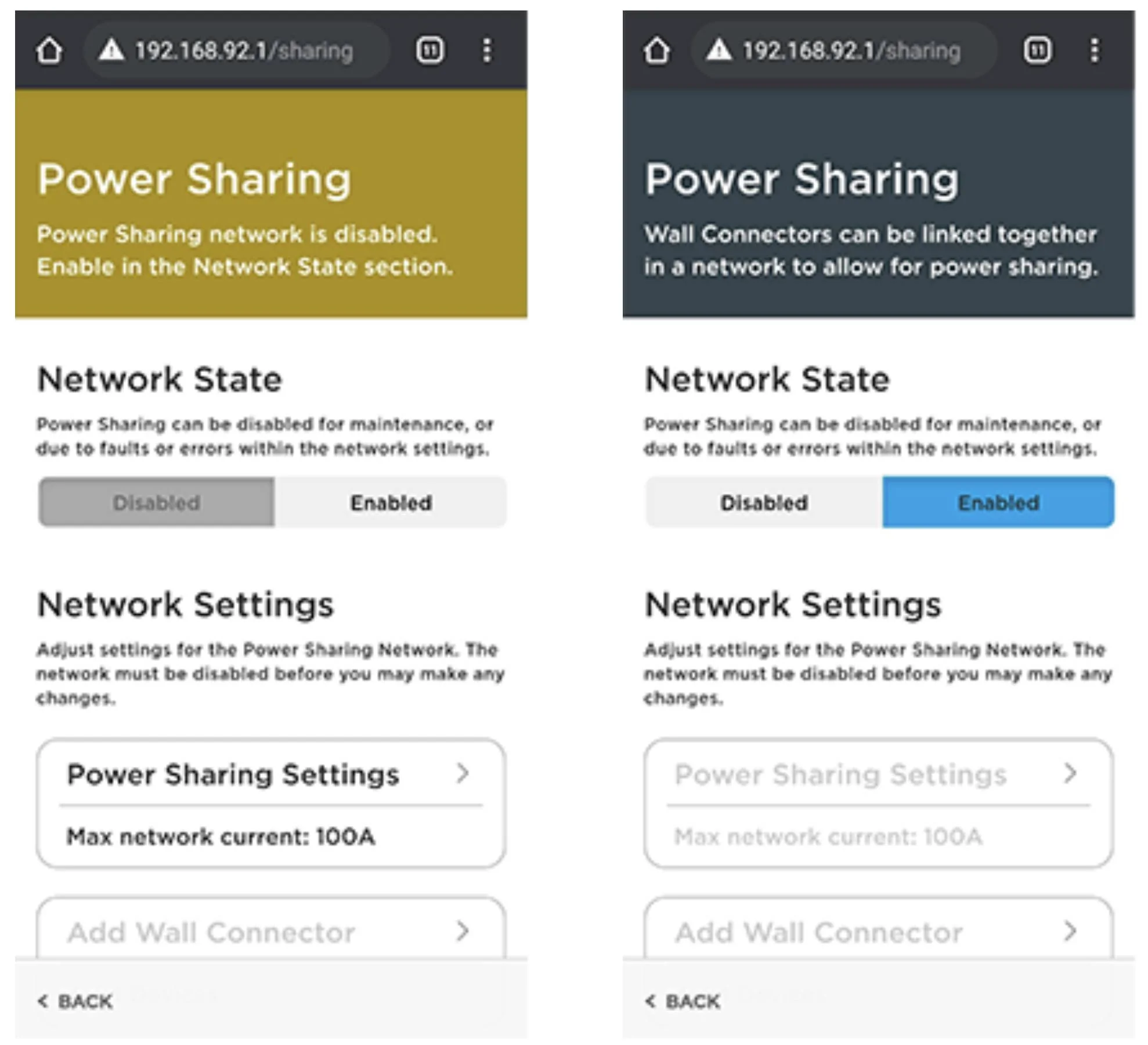

here are the details from Tesla
https://www.tesla.com/support/gen-3-wall-connector-power-sharing
so from picture below
  • upgrade the breaker/wire-gauge for each Gen3 wall charger to 60 amps
  • connect to one of the Gen3 wall chargers via wifi
    • update to the latest firmware
  • designate this 1st wall charger the "leader"
  • set it's maximum charge rate to 60 amp breaker (48 amp charge rate)
  • goto your 2nd wall charger - connect to it's wifi
    • update firmware if necessary
  • join the 2nd wall charger to the "leader" as a follower
  • set the maximum power Sharing settings to 100 amps
  • set Powersharing "enabled"
this will give you two separate 60/48 amp chargers - but manage a pool of 100 amps total while charging two vehicles - and a full 60/48 amps if you're only charging one EV
this works great for example if one EV needs 40% capacity charge and the other only need 15%
if they both start charging at the same time (11 pm) they will both share the load of 100/80 amps while charging at the same time (40 amps each) - but when one finishes and drops it's load - the remaining EV will then ramp up to a full 48 amps to finish it's overall charging session faster now that the 1st EV is done…

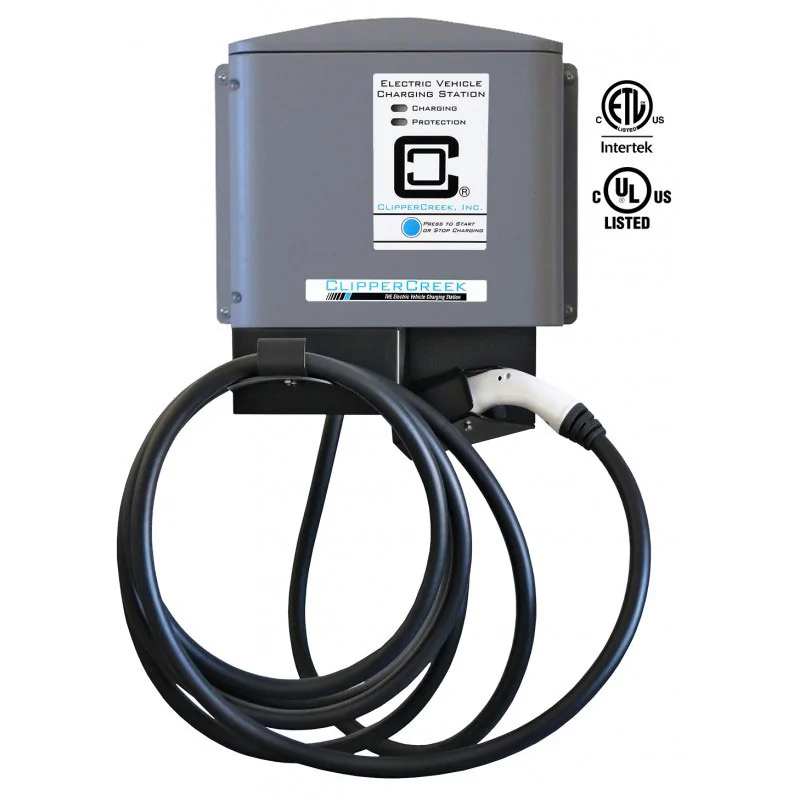

After lots of hemming and hawing, I went ahead and bought a NOS Tesla Gen 2 charger off fleabay. $650 seems like a steal compared to any of the other options, as long as it works ?. I already have the 80A Teslatap mini so I'll just use that until I decide whether I want to change out the plug from the Tesla one to a J1772.
ErikMason
Erik
Aug 29, 2022
Sacramento
Leaf, F-150
Being ugly is a pretty big downside though...
It may be ugly but it's accessible, the front of the enclosure opens up and fleets and school districts can easily connect to whichever fleet management systems to want or have. You will not find a more reliable charging station. And also, the CS-100 is an original, a classic, you won't be able to get these with the ClipperCreek logo for long.
