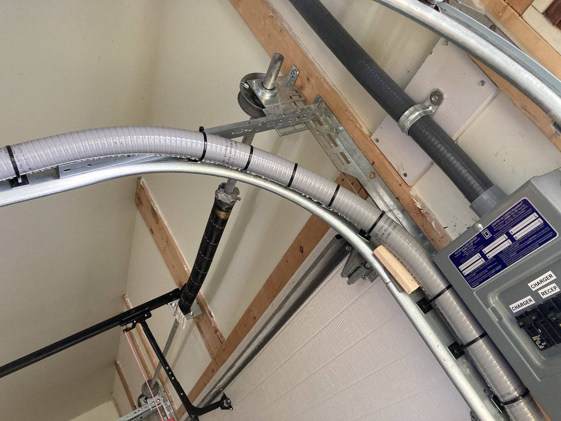

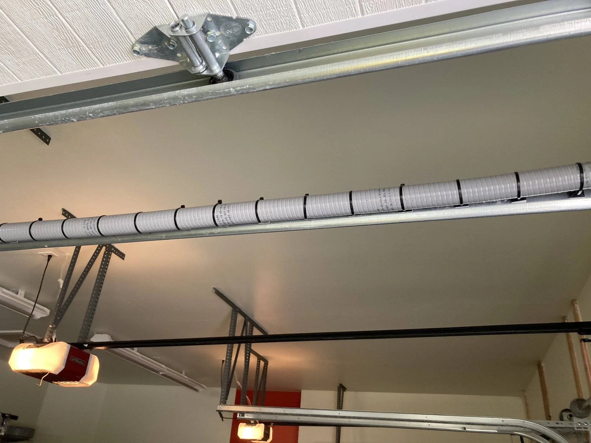

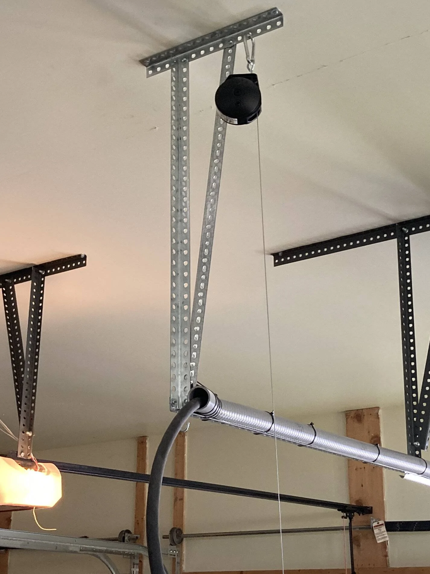

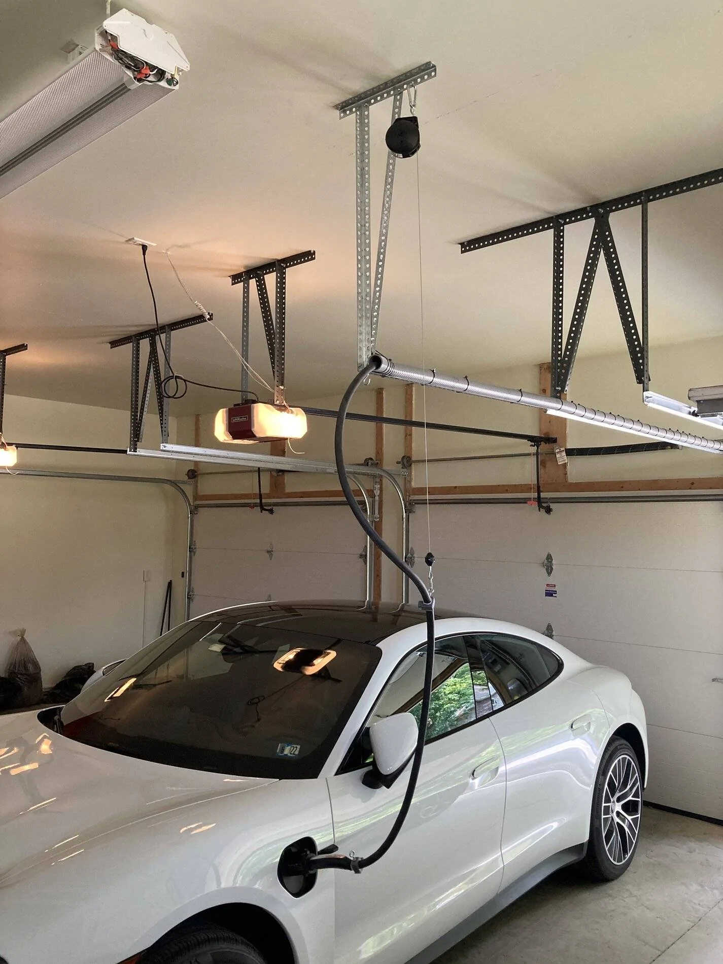

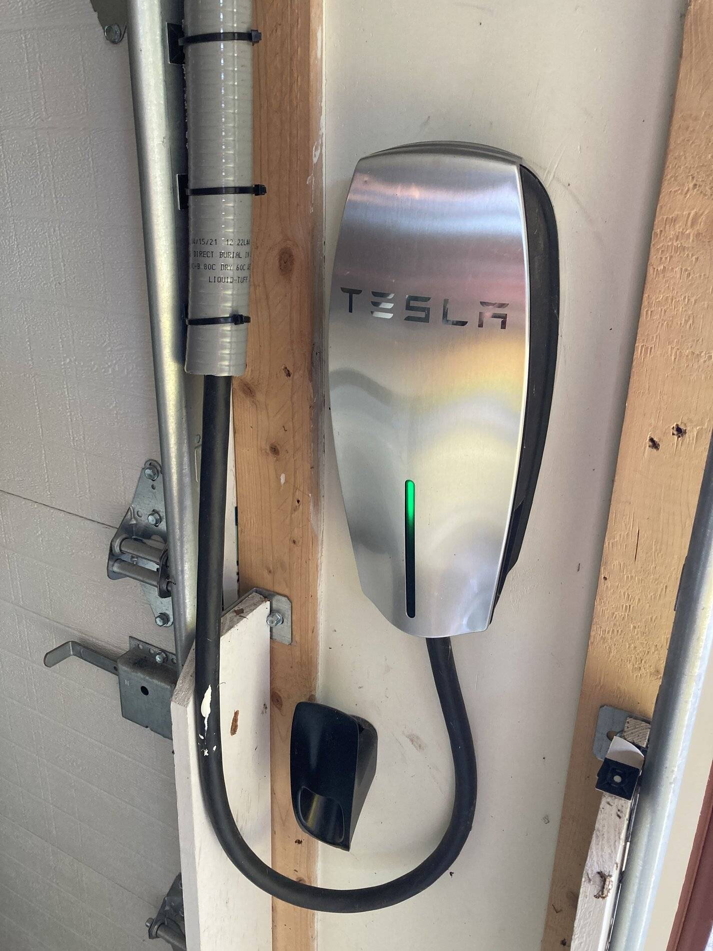

So my Tesla HPWC is on the overhead door-end of my garage because Tesla. What I did was get a length of 1.5” flexible, temperature-rated flex conduit (90° C?) and attached it to the outside of the overhead door rail. I used those adhesive squares with the four cable-tie slots. I spaced these about 4” apart along the rail.
I used a small saws-all to cut a slit the length of the conduit that I used to tuck the charging cable into the conduit.
No issues with it falling down after a few months. You could probable go 2” conduit to make it a little easier getting the cable into the conduit.
I’ll take some pictures next week.

This is the one I used.
Here are the aforementioned pictures:
